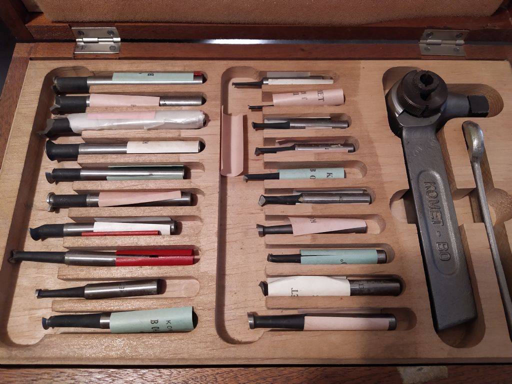

      Hello everybody,
      I received this tool set with my lathe purchase. It's a comment tool holder with inserts.
      I don't know anything about it and I'm searching information and documentation If anyone has an idea, thank you very much in advance.
      Ally the best ,
      Teo

          Teo, have a look at http://www.kometgroup.com or this link **LINK** I can not find your tool holder but maybe some more photo's of the holder will help.
          As far as the cutters are concerned, plenty of those in the catalogue but i have in the past used this type of cutter but usually in a boring & facing head rather than a lathe, however they can and are used on lathes, some of the ones in the box may well be threading tools but that design can be used as a boring tool as well. There are also undercut tools plus boring & facing cutters.
          Hope this helps John

            As John says comprehensive set of boring tools complete with the tool holder, all appear to have the same diameter shank and the toolholder matches.

              Try this
              Ifanger
              #438181
              Niels Abildgaard
                @nielsabildgaard33719
                Put it in a safe.
                It is a small fortune:
                Rich on saturday
                #438348
                Oneata Teodor
                  @oneatateodor85630
                  Thank you everyone for the replies.
                  I will keep it and try to use it on Myford.
