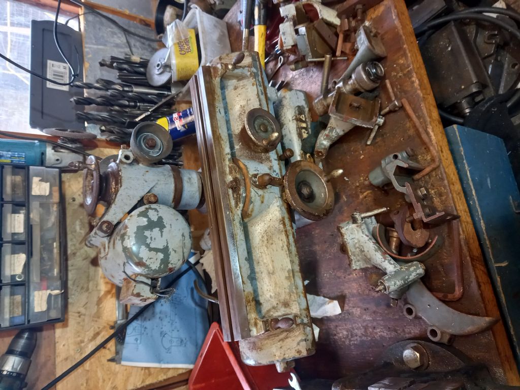

      HI everyone,
      I brought a the toy a Imperia cutter grinder with a good selection of attachments to go with it, it also came with a instruction Manuel from Tony's lathe website. I've tried to research more pictures and information on the internet, but there is very little to go on does anybody have one of these or have used one
      Many thanks
      George

              I've managed to clean and free most of of it up today it seems to be in fairly good condition , just wondered if anyone else had used or heard of these grinders?
