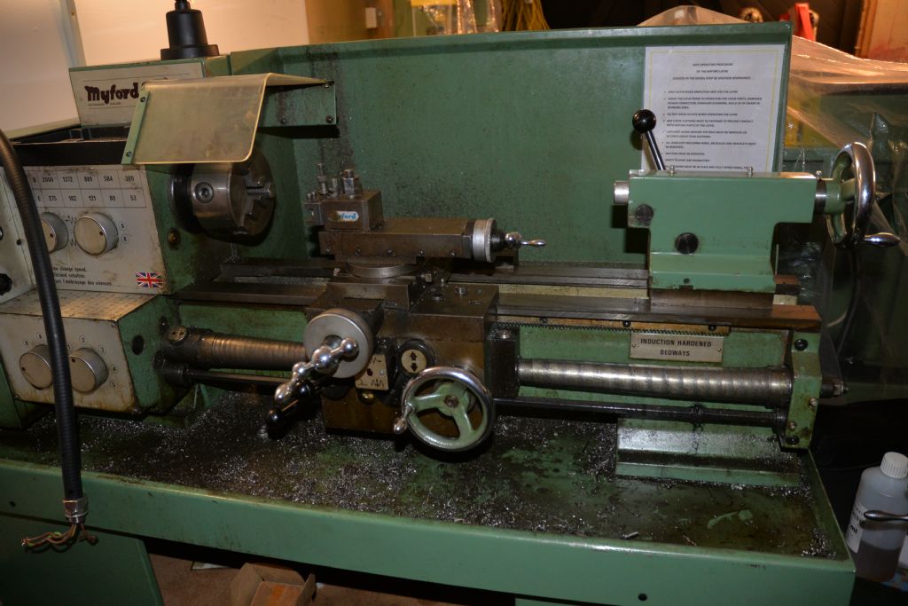

            #326299
            David Standing 1
              @davidstanding1
              And Alan, I agree on the mucky machine concept – then you see it as it is.
              I rescued the Myford 254S below acouple of months ago, that was used by an aerospace company in their model making department before they went bust.
              It was sold to me by a liquidation dealer, and they probably shoved the operator out of the way to cart it off.
              First picture was as I bought it.
              The second is after about three or four hours cleaning by me with petrol, brushes and scrapers. It had been used to cut plastic, probably not deep cleaned since it was new, and everything was covered in a sort of plastic like sludge.
              But, underneath was a nice little lathe trying to get out, and best thing is I paid just £1,450 for it.
              There are good deals out there, you just need to keep your eyes and ears open, and jump quick if required.

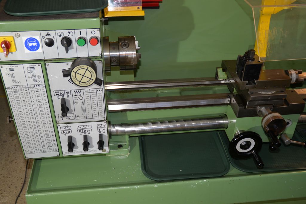

                                          On the attached photo of the headstock chart, the standard pitches the Boxford will cut with no changes of wheels are those picked out in bold script.  ALL the others only involve changing two or three changewheels from memory.

                                            And on the subject of there being no far eastern lathes with a QCGB, most of the gearhead Warco lathes have a QCGB, which I don't think require the addition of changewheels?

                                                      And on the subject of there being no far eastern lathes with a QCGB, most of the gearhead Warco lathes have a QCGB, which I don't think require the addition of changewheels.
                                                      I have owned a Warco GH1330 for over 10 years now, it does provide a lot of the common and some less common pitches via its QCGB, There are some change wheels to alter, depending on whether metric or imperial and change from feeds to thread cutting but as alluded to , it is minimal and takes but a few minutes.
                                                      I have used mine to cut numerous threads from 40tpi up to 4tpi and metric fine and coarse threads which are accurate enough for most purposes despite mine being an imperial machine.
                                                      Through all that the colour has not had a detrimental effect on performance. ( If you don't like, then a few rattle cans will sort the colour issue )
