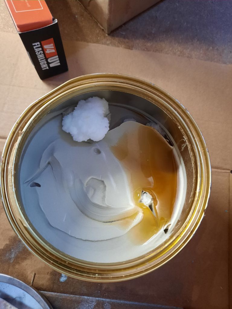

                                      #651886
                                        The answer is … quite possibly.
                                        Coincidentally, I opened this can of isopon about an hour ago. It seems to have grown a rock hard lump of crystals, produced some brown liquor AND solidified without any aid for the hardener.
                                        I checked the batch dates, 2004. It's only nineteen years old. The can wasn't even rusty!
                                        #651943
                                        Dave S
                                          @daves59043
                                          Pretty sure Isopon is a polyester rather than an epoxy.
                                          They cure in different ways. The hardener for polyesters is a catalyst that speeds up the reaction – but they do set on their own.
                                          IIRC epoxy is an addition reaction, where both parts are required for the chemical reaction to occur.
