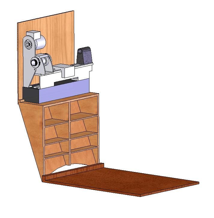

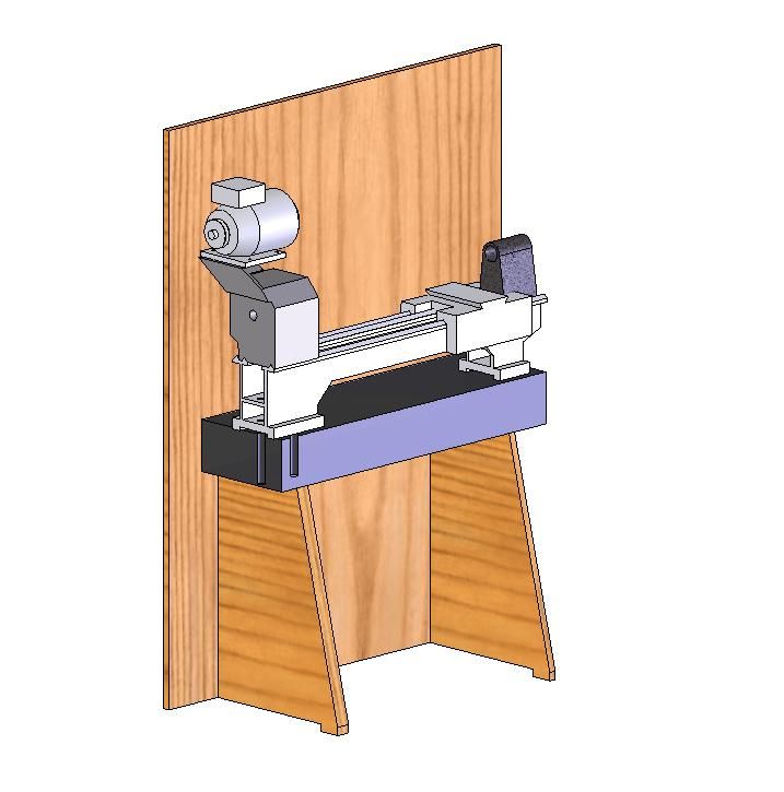

                        #640175
                        Niels Abildgaard
                          @nielsabildgaard33719
                          My ideal looks something like this three point furniture:
                          #640176
