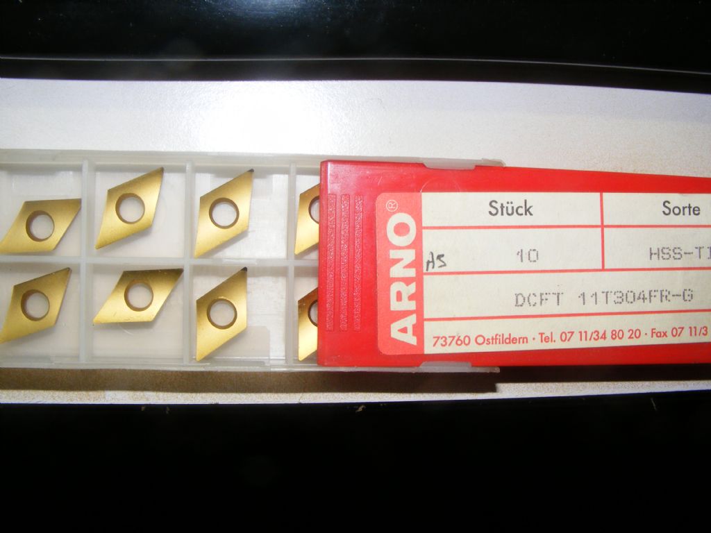

                  I wonder – why has no-one offered HSS inserts for us amateurs to use on the carbide holders we bought and then put to one side?
                  Or if they do, name & address, please.
                  Cheers, Tim

                              Tim, Re HSS inserts Arno werkzeuge do hss in most of the carbide geometries Here is a box I got at a good discount but are still very spendy Hss Inserts
