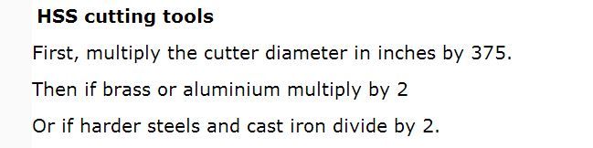

        I was reading through Practical Engineer part 1 article on this forum  regarding cutting speeds but I am a bit confused.
        The article states:
        1" x 375 = 375 RPM for steel
        1/2" x 375 = 188 RPM for steel
        1/8" x 375 = 47 RPM for steel
        What am I missing?

          Seems it should say divide 375 by cutter dia
          375 / 1 = 375rpm
          375 / 0.5 = 750rpm
          375 / 0.125 = 3000rpm
          Link to article if anyone else can come up with an explanation

            #160331
              Jason,
              You are obviously correct, regarding the error in the formula
              Mistakes like this are easily made when an author is describing a "convenient rule of thumb" that has been stored away in his subconcious: The underlying theory gets skipped-over, and the error is not noticed.
              I know that MTM runs as a "lean" operation, but this is a perfect example of material that needed "peer review" before publication,
              There is an insight to the origins of David's rule, in the opening line: "Referring to a chart of cutting speeds, a 1in. HSS cutter in mild steel requires a speed of 382 RPM. For practical purposes, this can be taken as 375 RPM."
              Why would we use 375 as a "practical" approximation for 382 ?
              … Because 375 is the decimal for 3/8 … which will relate to some other convenient rule.
              [Well, that's my explanation … others may differ]

              #160339
                Yes I think you are right with the reason to use 375 Michael, maybe for the metrically minded beginner a figure of 400 would be easier to work with when using finger and thumb as most of the older MEs will know in their heads what the various figures in that decimal sequence are off the top of their heads.
                Also agree that proof reading is not enough, you need someone who understands whats being written.

                      I think Jason was correct so I've changed 'multiply' to 'divide'.
                      I'm surprised it took five years for that to be spotted, the article has well over 8,000 views!

                            #160681
                              Neil, just had a look and it will require a bit more than changing multipy to divide, try this out for a 0.5" cutter which may be a bit slow
                              "First, divide the cutter diameter in inches by 375."
                              Needs to read
                              "First divide 375 by the cutter diameter in inches"
                              J
