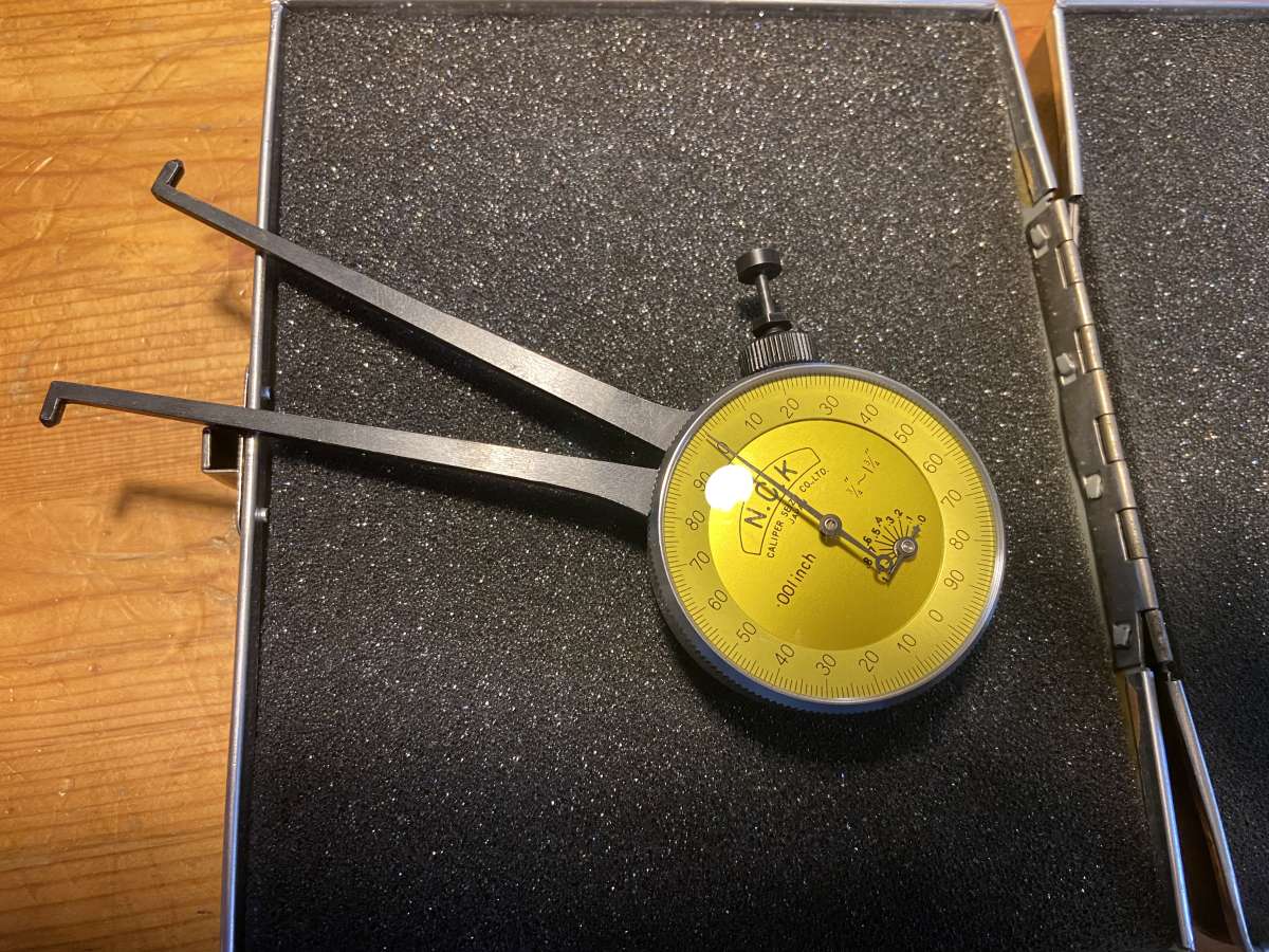

      I have recently bought this NCK-branded, internal bore, dial caliper tool, but it is proving to be a challenging measuring tool to learn to use.
      It has two “legs”, with the left leg being stationary and the right leg being spring-loaded and fully extended while at rest.
      The measurement range is from 1.750″ down to .750″.
      How does one use this this for measuring and reading an actual bore diameter?
      Does it need to be “calibrated”, and if so, how does one calibrate it?
      I did take a measurement between the tips of the “feet” on the legs, with the right leg fully extended at rest, with a digital caliper.
      It is supposed to be 1.750″, but measured at 1.763″.
      My intent is to use this for measuring bore diameters, for determining major and minor diameters for various internal threading pitches.
      Does anyone have a link to the instructions for use, for this instrument?
      Thank you for your insight, with using this instrument
          The first thing to do would be to read the instructions.
          In short, you don’t use it for direct measurement.
          It is a comparative instrument only.
          You zero it out at your chosen size using a ring gauge (or gage – I think one is metric, the other imperial). Make sure Berel is in a good mood before you attempt to rotate her.
          Poking it up your chosen hole then tells you the difference from your ring.

            As DC31k says its a comparative instrument, not direct sizing
            Simply set your final desired internal diameter on a Mic, as shown in the instruction sheet, set bezel to Zero and then continue boring out your work and testing with the calipers as you go, indicting your progress to zero.

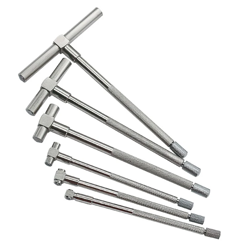

              When measured accuracy is needed I switch to a set of telescopic gauges.  They’re more costly, take longer to use, require care and a digital caliper to take off the actual measurement, but are OK in the range I work too – rarely better than ±0.02mm.   The sets cover large and small bores.

                  It will indicate the difference in size from the gauge (Ring, Micrometer, etc) to which it was set to Zero.
                  Hence, it compares the bore being measured with that usewd to set the Zero.
                  In used it will need to be be gently rocked to and fro in both planes to show the minimum reading, oe. when perpendicular to npth both axes, (diameter and longitudinal)
                  It might take a while to become used to this procedure, but practice makes perfect!
