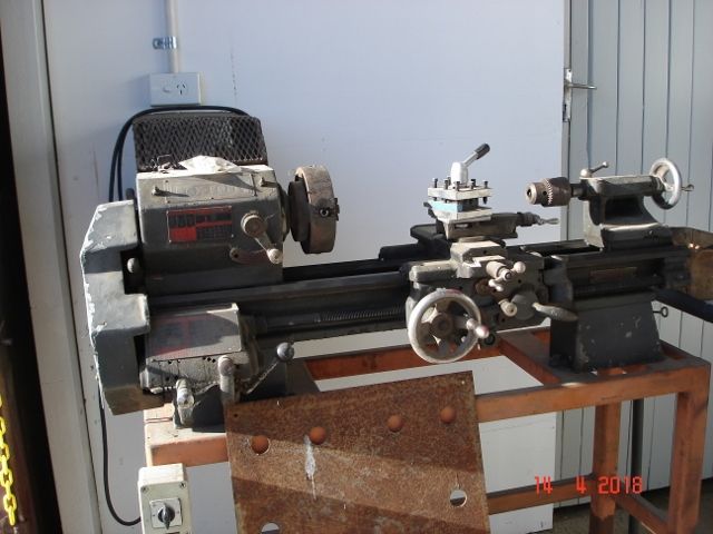

      Went back to the local Men's Shed today to do a bit more toward getting the Boxford A up and running. Problem; the 4 jaw chuck is stuck in place, it;s got to come off. The chuck it's self is damaged, 3 out of the 4 square key holes have a side out of them.
      I'v got a copy of a hand book off the web, and their suggestion is to lock the back gear, put the key in the chuck, and give the key a bump with your hand. I prefer to put a bar across the jaws and tighten the jaws on it, and I tried that to no avail, what next?
      Another wee problem, how do I slacken off the belt, it's go something to do with the lever just to the right of the thread cutting gear box, I think the set up is a bit of a lash up, the hand book shows the jack shaft tilting via a lever from the top of the head stock, but it does not show the above mentioned lever by the gear box.
      Here's a photo of the machine.

          Be careful using the backgear to lock the spindle if the chuck is firmly stuck. Busted teeth have been done that way before!
          The time honoured method instead is to use a bit of impact by the placing of a block of wood between chuck jaw and bed, with top of wood at about centre height. Using the countershaft pulley etc to spin the spindle by hand in the reverse direction, give it a good quarter to half turn to build momentum before one of the chuck jaws smacks into the wood block. This should free the chuck in most cases.
          If not, you can try the same process but under power in the lowest backgear, if your motor has a reverse switch. Keep fingers clear etc etc of course. I've never had one stuck so tight I had to go this far but it is recommended on lathes.co.uk so perhaps not as barbaric as it sounds.

              To slacken the belt you move the handle beside the two Norton gearbox handles. It goes through the base to a cam that moves the motor plate.
              If you take out the backgear layshaft you can 'get at' more of the bull wheel to grip more of the teeth to distribute the load. I sometimes keep the belt tight, grab the belt both sides of it with one hand and squeeze which grips the pulley to hold the bull wheel by its two pins not the teeth. Does that make sense? This is actually easier than an underdrive version.

                My guess is that if 3 out of 4 jaw screws are broken then you are down to unbolting the chuck. From there then WD40/paraffin/3-in-one on the end of the thread might loosen the backplate. Alternatively remove headstock from lathe and stand nose down in a tray of diesel. Last ditch, machine the backplate off.
                To remove the headstock.
                Remove the right hand layshaft bearing holder, this allows you to get the belt off the layshaft.
                Remove the changegear cover.
                Remove the banjo.
                Release the two headstock clamp bolts that are under the headstock between the ways. The front one will need a _short_ (4″ long) spanner.
                If the belt is currently tight then the belt tensioner is incorrectly setup.
                You will probably need to take the belt off the layshaft to fix. The mechanism is basically a pin in a spiral groove and the tensioner quick release lever should be pointing straight down when tight. The quick release lever passes through a threaded bush in the front of the bed support that sets the tension.
                More info about the belt tension mechanism can be found in the boxford parts list pdf in the file section of the Boxford Lathe group on Yahoo groups.

                  I have a Boxford AUD, slightly different, but DON'T lock the BACKGEAR, unless you have some spare parts. From what you say, the 4 jaw chuck has seen some brutal service. a little more won't hurt – possibly look for another one?
                  OK, this is what I would do – Put a bit of 1" square x 4" long into the chuck, drill a centre into it. Move the tailstock up to the end of the bar and lock into place.
                  Put some protective wood onto the bed ways.
                  Ensure the leadscrew tumbler gears are in neutral.
                  Make sure the motor / drive belt are engaged (not powered up).
                  Put a 1" spanner onto the square bar and give it a really good hit with a club hammer (4 lb ish) or copper / lead mallet.
                  There should be enough mass in the spindle / drive belt / motor to allow the chuck to be "shocked" off.
                  The headstock bearings are solid enough to absorb this shock.

                      As a last resort you could always unbolt the chuck and turn off the backplate.
                      Most 4-jaws have front mounted screws and a new backplate can easily be knocked up or even bought cheaply.
                      It'd be a lot cheaper than a bu$$ered bull wheel.

                        +1 for NOT engaging back gear and hitting the Chuck key.
                        Clamp a piece of timber or steel bar across the jaws, ensure that the belt is tight. You need as much inertia attached to the spindle as possible. .
                        Hit outer end, HARD with a heavy ( 2lb – 1Kg minimum) hammer. If at first you don't succeed, repeat. Eventually, the chuck should unstick.
