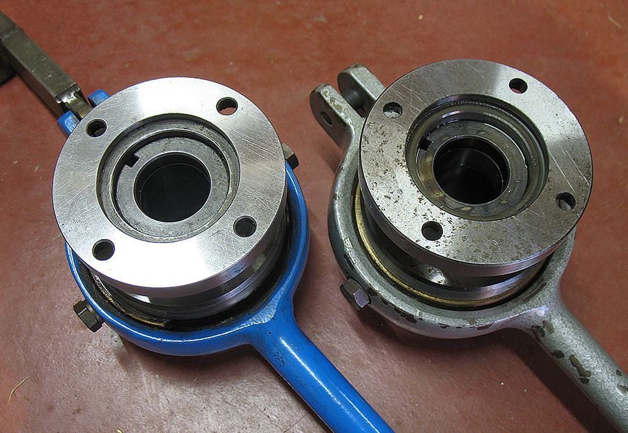

      With the recent purchase of a Myford Super 7 lathe I also received these two, spindle-mount, lever operated collet chucks and a few collets for each one.
      Now, I know that I have to affix that lever to some point on the lathe to make these work and I suppose I can figure that one out on my own, but, unfortunately, there are no threaded mounting plates included to transfer the rotation of the spindle to the collet closer..
      I've searched the internet for information, made a search of the forum articles here as well, but can find almost nothing that gives me a clue as to how to go about machining a spindle mount for these and then getting them mounted and aligned.
      Has anyone out there got this information?

          Could you flip your chucks to sit on the nose piece & post pictures of the rear face ? Should be possible to work out the mounting arrangement from that.

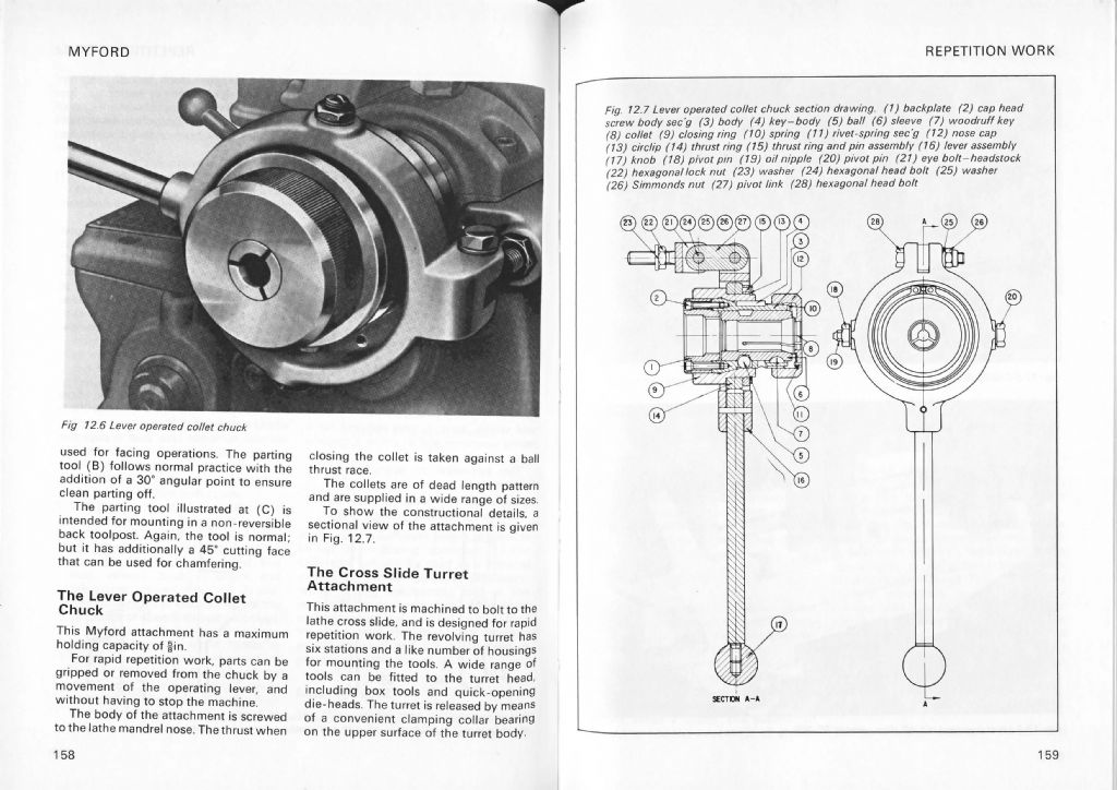

            The photo seems to show two types of collet but the chucks both look like the Myford item: £250 in 1990 with collets at £18.75.
            My price list says "It is of the backplate mounting type"
            I believe the short link goes to the threaded hole in the headstock on the far side of the spindle.
            PS p158 of Bradley's Manual gives more information; I will scan and post.

              Ignatz
                @ignatz
                Wow! Those things were expensive! surprise

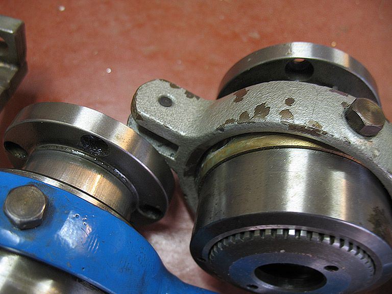

                Here are some extra photos of the back side of the collet chucks.
                Those mounting holes are not threaded, but simply counter sunk on the front side.

                    Anonymous
                      I'm not convinced that the OP has two complete sets of collets and closers.
                      The upper set don't look like the Burnerd multisize collets I have. What I assume are the metal fingers are tapered, so they couldn't slide in slots like conventional multisize collets. They look more like rubberflex collets. Same result as sliding metal fingers but different construction. Rubberflex collets were often made by Jacobs, as were the ones I use in my auto reversing tapping heads. The lower set of collets are dead length collets.
                      The two types of collet work in different ways. Rubberflex collets work by contracting as they are pushed back towards the headstock. So the collet moves with respect to the headstock when it is closed. A corollary is that the work also moves relative to the headstock as the collet closes. Dead length collets are closed from behind, away from the headstock, towards a fixed stop at the front of the collet holder. A consequence is that the collet does not move relative to the headstock when being closed, nor does the work. Hence the name dead length. It's a significant advantage on repetition and capstan lathes.
                      It would be interesting to know if the two holders work in the same way, or different ways. The internal tapers should be different as well.

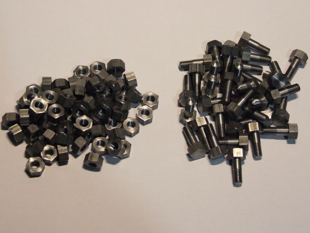

                      I think Martin is correct that some of the dead length collets are hexagon. I can vouch for their usefulness when making batches of nuts and bolts:

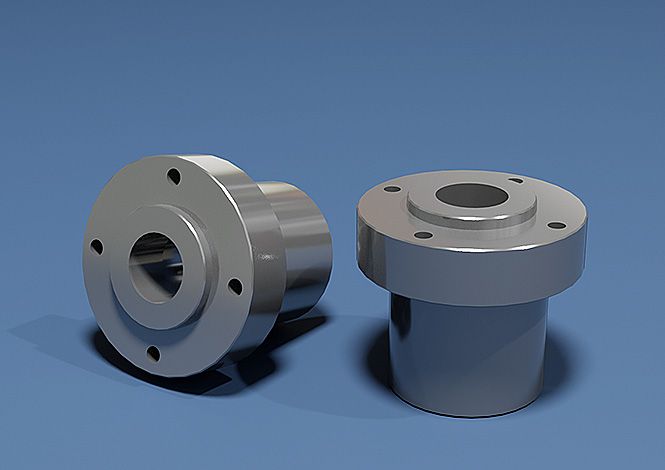

                      Ignatz
                        @ignatz
                        @Martin, … you have a point there. Most of what I do on the lathe are bits of one-off's, so I'm not sure that I actually need these collet closers.
                        On the other hand, I confess to being curious and interested to try them out… even if only for a short time before selling them on if it comes to that.
                        I guess I'll have to machine at least one backing plate to give the collet closers a test.
                        I've thrown together a rough idea of what I think the collet closer backing plate would look like in my 3D program. Not sure about the over-all length, but certainly has to be long enough to allow for proper mating to the headstock spindle… and then not any longer than that to make it work, right?
                        Does one have to do anything special to compensate for runout? I know that with some nose-mounted collet chucks it is suggested that one leave a bit of play to allow for 'tapping in' the collet holder before snugging everything up tight.
                        Any feedback happily accepted. smiley

                        ega
                          @ega
                          Ignatz:
                          Did you compare the drawing I posted with your hardware?
                          Noting that the knobs are different from drawing made me wonder if you have actual Myford items. Do they not include part no 1 (backplate) as shown on the drawing. I had assumed that this would screw on to the spindle in the usual way other chucks do.
                          I hope someone with hands-on experience can contribute.
                          Lovely "rough idea", by the way!

                          Ignatz
                            @ignatz
                            @ega, … I did check that drawing (thank you for posting), but the actual design of these two collet closers does not match the drawing.
                            If you reference the extra photos I posted (above) you will see that both closers end up with a flat face having four mounting holes. That flat face is not bolted on as an extra, but appears to be an integral part of the collet closer body. There is no threading to be seen… certainly nothing that would allow this to simply be spun onto a Myford spindle.
                            #567760
                              Looks like your sketched backplates will place the unit a lot further from the headstock than the one shown in Ega's scan which looks to have the "backplate" or Myford nose adaptor as it may be better called fitted within the main body thus keeping overhang to a minimum
                              #567763
                              Ignatz
                                @ignatz
                                Jason, … I totally agree… and my rough backplates are probably much too long as pictured.
