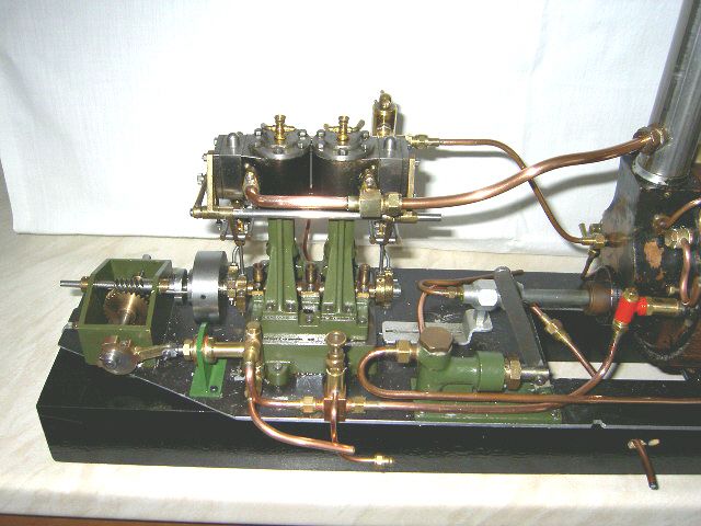

                                  You could fit oil cups to the cylinder head covers or valve chest cover which will allow you to get oil into the cylinder before a run, the cups on my D10 are of the taper cock type.
                                  They will also allow you to put oil into the engine after a run to help stop condensation.stuart d ten.jpg
