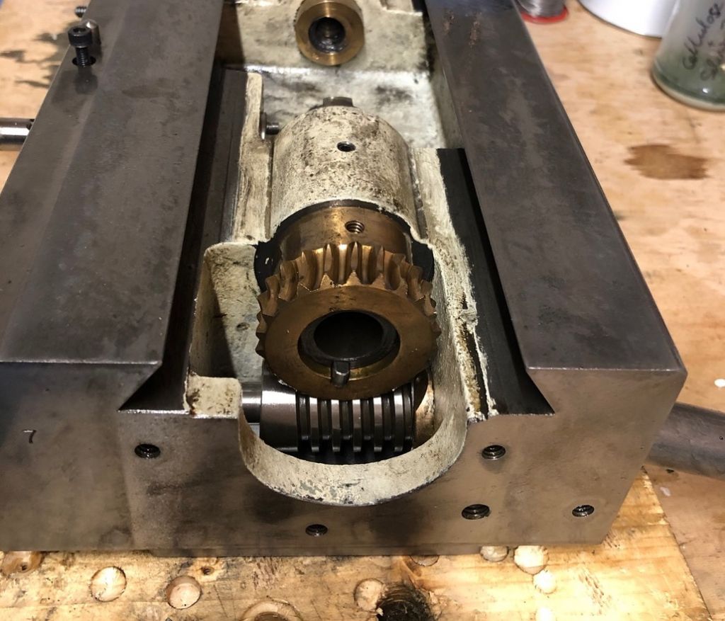

      [Complete beginner to this task, so please bear with!] Surprised when I disassembled the saddle for my Senior M1 to find no gasket on the end plate, which encloses the oils trough to immerse the worm/wheel table power feed. See photo of plate removed.
      Anyway, upon refilling with new oil, there was clearly a slow leak. I want to fit a gasket.
      I have a 0.8mm thick "Flexoid" gasket sheet.
      • Is there anything else to it other than accurately cutting out the sheet to match the mating surfaces?
      • Should I score out the paper using the peen head of a hammerr against the plate as a template?
      • Should I prime the gasket, I heard vaseline?
      Any help is appreciated.

          Oh, gaskets are sooo last century…
          I'd suggest either a neutral-cure silicone 'instant gasket' or a non-setting sealant like Hylomar, or Red or Golden Hermetite (if they are still available). No cutting or fitting needed and no risk of moisture, absorbed in the gasket material, causing corrosion. If using silicone, only a tiny bead is needed (eg from an hypodermic syringe without a needle), around where the oil may 'come over the top'; be careful to get 'neutral-cure', otherwise it will be the type that releases acetic acid on curing which can cause quite spectacular corrosion (ask me how I know…).
          I don't know the composition of Flexoid sheet, so can't comment on its suitability, but, if you want to keep the machine 'period', oiled brown paper makes pretty good, cheap, gaskets, when the mating surfaces can be assumed to be well-finished and flat. (Oiled so corroding moisture doesn't get in.)

              My 1967 motor cycle did not have a gasket between the crankcase/gearbox halves. It did not leak.
              One possibility is that you over-filled the oil bath? A better question might have been: How did they avoid oil leaks from this installation? Fitting a gasket may not be the correct procedure.

                You may have a leak because the oil you refilled with is too thin or the wrong oil. Worm gears require a specific oil because of the rubbing action.
                The suggestions of using an instant gasket type material is a good one but use it very sparingly. Someone used a lot of it in reassembling one of my engines and that gasket material squeezed out everywhere. Externally that wasn't a problem but it wasn't good inside the crankcase.

                  Just another thought, sparked by NDIY. The oil level should be about half-way up the sight glass (IIRC there is one…). I'd expect this level to be below the bottom of the semi-circular cut-out in the end of the casting – the worm really only has to dip into the oil. So is the leak in fact from one of the tapped holes, which has been drilled right through, into the oil resevoir? A bit of thread sealant will fix that.

                        Hi, if you have a sight-glass, it is normal to fill to half way of the glass, which will usually put the worm about half into the oil. Don't forget that when in use, a certain amount of oil will cling to the worm-wheel and will also get splashed about the inside and if you don't have enough oil for this, you'll get starvation on the bearings and between the worm and worm-wheel.

                            Yes, probably, but my experience is that big tubes like that, intended for mastic guns, end up with >90% wasted – it's difficult to seal the tubes. I don't know what's available in your locality, but I'm sure the motor factors and engineering suppliers (and possibly the DIY stores) have smaller tubes available (actually, there's usually too much choice). Just look for 'neutral cure' on the tube. Some say 'sensor safe' or similar, and are intended for use with things like exhaust gas oxygen sensors. Presumably they have a high temp. tolerance too. If it doesn't proudly claim to be neutral curing, beware!

                                The warning about silcone rubber formed in place gaskets is quite accurate. Once saw an engine seized because over zealous application blocke the mani oilway from Folter to Pressure rail.
                                Use very sparingly, a bead just smaller than 1.5 mm will be sufficient. Don't let it cure. A preformed bead will have a finite thickness, affecting the worm / wheel meshing, and will torque relax, so that the cover becomes loose before too long.
                                The object to is have a metal to metal joint with the sealant acting as a gap filler.
                                If you want to play safe, apply Hylomar as a non setting jointing compund.

                                  I always go for Hylomar for metal to metal joints, you only need a very thin smear to fill the machining marks and you have plenty of time to assembly the parts. It has the benefit that you don't need to try and guess gasket compression when you are designing an assembly of parts.
                                  You need to be careful if there are any nitrile O rings though, the solvent in Hylomar causes the rubber to initially swell, but as it disperses the rubber shrinks to less than its original cross section and you can get leaks. Not sure if Viton and Silicon is affected in the same way. You can get away with it if you let the solvent evaporate before assembly. Not an issue in your case.
                                  I can't see if the tapped holes break through into the oil space, that will dictate where you apply your sealant. Oil will always find its way down the threads.
