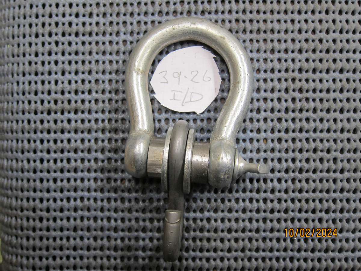

      I am currently using a length of nominal 44mm O/D scaffolding pole as an overhead gantry system for my model engineering purposes and have been gifted a shackle complete with a suspension hook which on the face of things should be an ideal match for the pole. Unfortunately the I/D of the shackle measures 39.26mm as opposed to the 44.3mm of the pole. Health & Safety orientated members look away now, but how would it be possible (or advisable) to ease out the I/D of the shackle to give a sliding fit over the pole? A form of angle grinder perhaps?

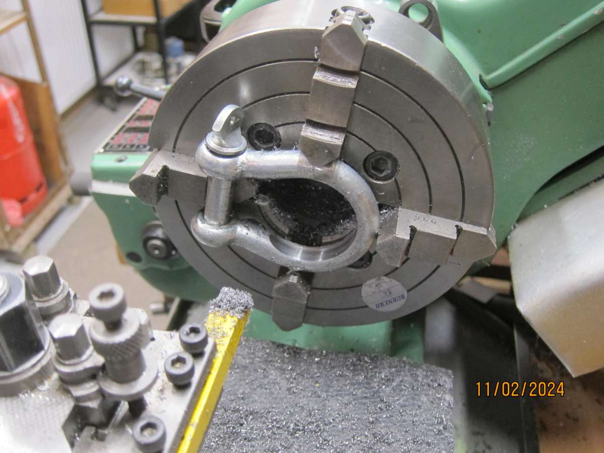

                  I have attached a photo of the shackle in question.  I had not thought in terms of using a carbide tipped tool but will certainlty put it up in the 4-jaw and give it a go.

                              Well, for what it is worth I have taken up Jason’s idea and turned to size using a carbide tipped tool and the shackle mounted in the 4-jaw. No issues, no panic moments and I now have the required sliding fit. Sharp edges removed using a half round file. Probably will be kept under the bench and held in reserve.

                                A blacksmith solution is probably best  hammer it on the beak of an anvil rather than cutting away metal.
                                #713972
                                Nigel Graham 2
                                  @nigelgraham2
                                  I’d never even consider trying to modify a shackle, either by cutting it or by bending it.
                                  Machining it at all will obviously weaken it but not at all predictably, and bending it even if more scientifically than bodging it with a big hammer, would ensure the pin will no longer fit correctly – so scrapping it.
                                  Buy a shackle that fits correctly – take a sample of the tube and that hook to the stockist to test for fit.
                                  Lifting-tackle is not ever so expensive, and it’s not worth taking risks with it.

                                    We don’t know how Greensands is using any of this gear, or at what loadings, … but I suspect that the tube is being used as a substitute for an overhead rail.
                                    Without the detail, and lacking the analytical tools, I suggest [gut-feeling] that the tube would fail long before the modified shackle … and also that the substantially larger contact patch will decrease, rather than increase, the risk of risk of indenting the tube.
                                    Obviously all of this project is outside normal ‘lifting & handling’ regulations, but if Greensands is happy with that, so be it !!
                                    The machining looks well-done, and the modified shackle may [for all we know] still have an enormous safety margin when loaded as he intends.
                                    Note: I am happy to retract any or all of the above if/when the configuration is disclosed.

                                          Well, obviously we don’t know all the criteria in Greensand’s application – including the maximum mass he wants to lift, and the span and supporting arrangement of the beam.
                                          Even so, although his modified shackle may be fine there, for any other purpose it is effectively scrap.
                                          The turning seems to have retained roughly 2/3 of the diameter of the bar. That would make me think the shackle’s maximum SWL is now about half original by area alone (4/9). What it has actually become by shape effects, is another matter. At least the outline has given smooth transitions from machined to uncut surfaces towards the pin.
