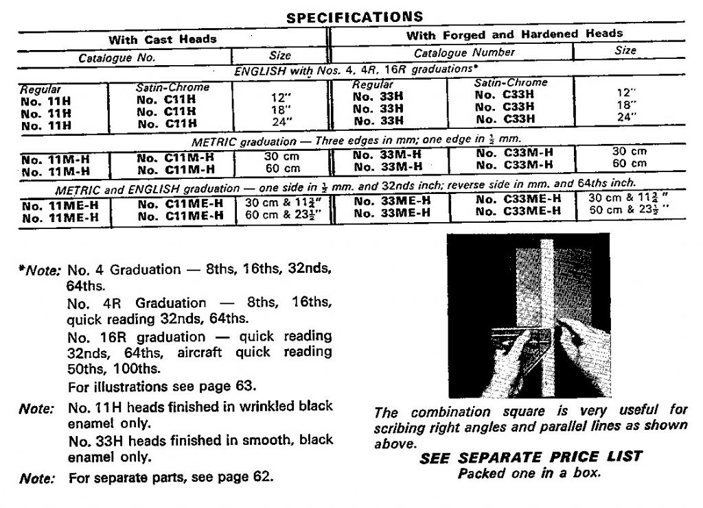

          The Starrett 1980 Anniversary catalogue lists both wrinkled and smooth finished items. The various parts were available separately.

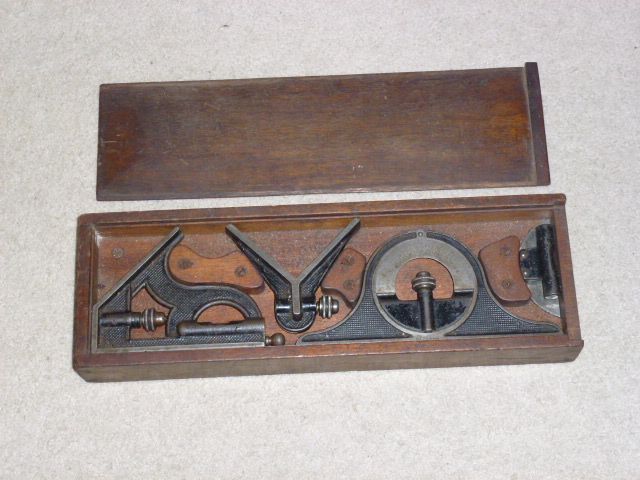

                  Here's mine.It was given to me about 65 years ago by a great uncle who had been a toolmaker at Austin.( He could talk about someone by the name of Herbert who used to wander about the works! ).
                  The protractor is neatly stamped "Pat. Aug. 7 1883".
                  The box is nicely made from mahogany, the sliding lid is about 5mm thick max. no plywood.
                  I also have some other hand tools that he gave me, dividers, calipers etc. some of which are hand-made, as you did in those days.p1020937.jpg
