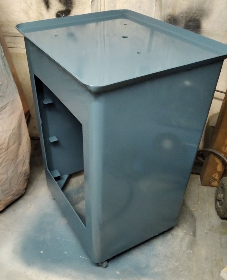

                                              Why is it late in the year to paint something? I've just been in my unheated garage to check the Union T&C Grinder cabinet I sprayed Sunday afternoon and it's as expected, just fine, I'm genuinely confused why you shouldn't paint at this time of the year?
                                              #623859
                                              Baz
                                                @baz89810
                                                No reason at all not to paint at this time of year, in fact I am painting a set of loco frames in the garage at the moment. Temperature this morning was around 10 degrees C. Frames have been sprayed with Upol acid 8 and left a few days to dry and now they are being painted red inside using Precision paints Signal Red. Paint is brushed on because I think it is easier to get into all the little nooks and crannies with a paintbrush rather than an airbrush, cab and tank etc will be airbrushed. The paint is going on beautifully at this temperature, I am using 1/2 and 3/4 sable brushes.
