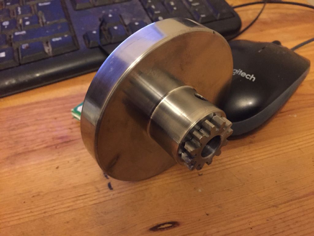

      Title is a bit vague – how long is a piece of string (longer than you think!), so I'll give a particular case.

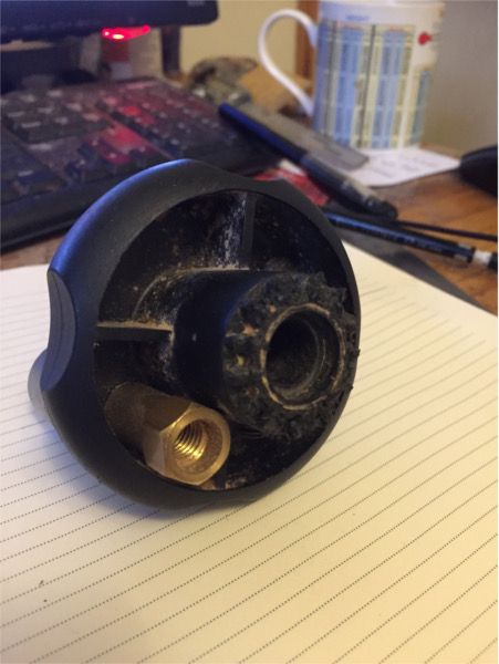

      A while back I was approached by a woodworker who had who had acquired a Kity table saw which he was thinking of scrapping because the moulded handwheel which controls the rise/fall and tilt of the blade had failed:
      It's a bad design because the nylon (I think) gear meshes with with a steel rack cut in the pressed steel housing of the machine, with a predicable result.
      I made a replacement in steel which involved measuring up the original, drawing it out (in my primary school way):
      and making a new one in steel:
      It's straightforward enough lathe work, but I have no realistic idea of how long it took because I am quite disorganised.
      I suspect that I am slow – perhaps it took me 2 or 6 hours from start to finish. Maybe more!
      I'd be interested to know how long this would take others using manual machinery. In my head it was "Half an hour mate, stick a lump of 3 1/2 inch in the chuck, twiddle some handles, bung it on the mill, drill and tap a few holes, job done." But of course it isn't really like that.
      Robin

                Extra time if you made the spur gear instead of buying it in! Same with the handle.

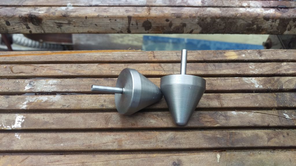

                            Howard's post above shows why it's useful to have more than one way to do a job! If you break a clamp in the first setup, then move onto another that you rejected for whatever reason, lubricated with plenty of Anglo-Saxon.
                            Take these jack adaptors
                            which are about 40mm diameter, 1/4"pins and the radius/taper(which aren't particularly critical) worked out from the distances in CAD. They're one piece just like the original I was given, but that's wasteful in time and material. I should have made the pins separate and loctited them in, which would have been quicker, easier, cheaper and made a stronger part.

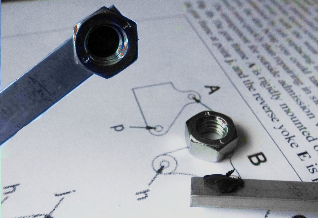

                                        At the moment I am getting more than a little frustrated by my small Chinese lathe, which … has the problem that chucks are bolted to the spindle with minimal finger clearance for the nuts. …
                                        This is a problem, even if you do have small fingers.
                                        I found a home-made tool like this helped:
                                        Just a suitable strip of metal, or Lolly Stick, and a blob of Modelling Clay. Grease works too, though messy. Magnets don't!
                                        The tool let me catch the nut on the thread so it could be spun tighter with my little finger and then spannered. Also helps to make more room by not pushing the chuck fully home on the register until the nuts are on the studs. Then push it on properly and tighten the nuts.
                                        The strip can also be used to direct nuts spun off by one hand into the other.  Really annoying when a nut hides in swarf.
                                        I always put a bit of wood across the ways in case the chuck falls off before I get the first nut on. Not happened yet…
