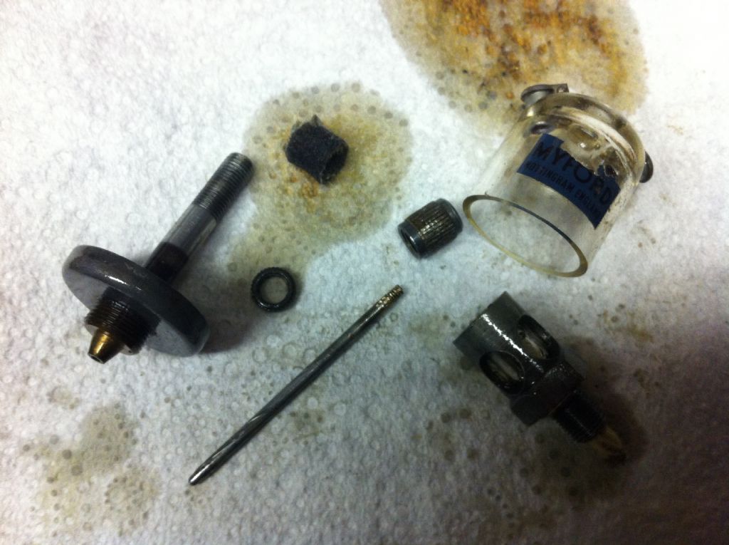

              I managed to get them apart partly. There were no springs. The diagram in the manual shows springs but no wicks, so they have been modified. The needle screws into the top cap. In one oiler, the needle was so tightly jammed into the brass seat that I needed to use great force to get it out. I can't see the purpose of the (missing) springs except perhaps to hold the cap/needle assembly at the set position. I'll fiddle some more in the morning.oiler bits.jpg

                  On this type, there was no toggle lever and the spring cannot be acting to close the needle but rather, bears on the needle adjusting cap, tending to push it open, but of course, it is held by the screw threads. I still don't understand the spring's purpose.

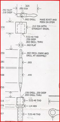

                      Normally the needle would have a collar or e-clip for the spring to push down on, your needle is not original. The top lever acts like an over centre cam when flat the spring pushes the needle down to stop teh flow, when up the needle lifts, amount of lift and therefore flow is adjusted by teh top knurled cap which the levert bears on.
                      Make them all the time for the hit & miss engines, the spring would fit just above the collar on the needle.

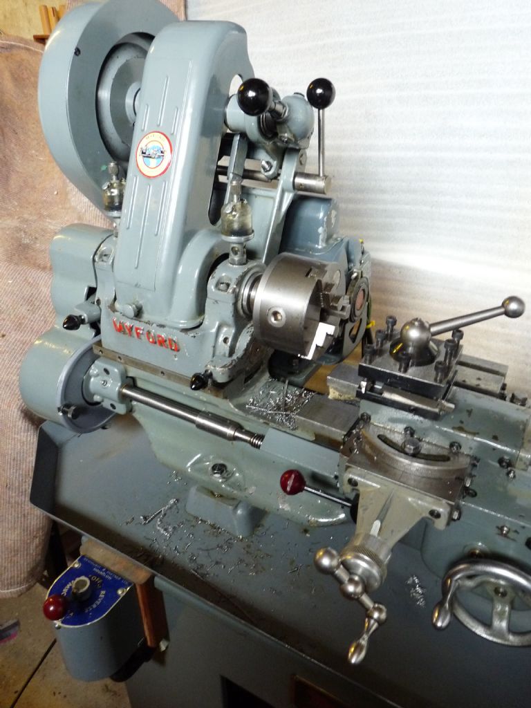

                        What you have are the original Myford drip-feed oilers. No springs, just manual screw adjustment of the needle valve and a little felt filter to catch any foreign bodied in the oil and no wicks in the ones on my machine.  The oil just drips straight into the bearings.
                        Here is my ML7 (1965 vintage) fitted with these oilers.
                        At the start of a session I undid the needle valve screw a couple of turns to get a good drip going and then turned it down to about 3/4 of a turn from closed, setting a regular drip which was visible through the little windows in the base of the oiler. I put an index mark on the top of the knurled knob to help gauge the position of the needle valve. At the end of a session, I gently closed the valves, otherwise, they emptied overnight.
                        One thing I did do was to seal the bowl to plastic cap joint with silicone sealant to stop them leaking, the original cork gasket was not effective. Overall they worked very well, and never thought of replacing them with the flip-top spring activated type.

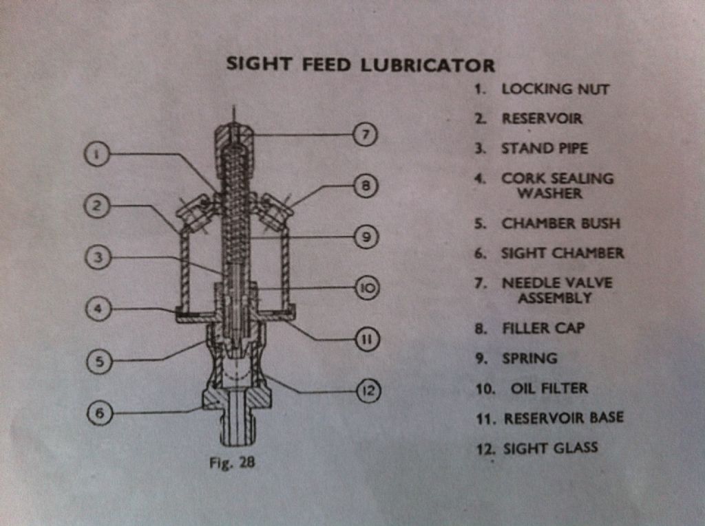

                          Thanks Jason for the nice diagram; that explains the "spring closed" type. Phil's is like mine for sure, and mine is a 1964 model, K66083, so close in age too. Thanks Phil for the photo. Yours looks like a posh one with a clutch(?). The only question remaining is whether my felt wicks were added by someone. They look as though they belong but how would you know? I will now turn my worry to how the bearings might have suffered from oil starvation. Without pulling it to bits, how would I know if it is in good order or not? The diagram is from a downloaded ML7 manual and is why I thought there should be a spring. oiler diagram.jpg

                            The spring around the needle is to resist the valve turning under vibration, which I missed in my first post. The later ones use a spring loaded lever mechanism to operate the valve.
                            I'm pretty sure the needle was riveted to the knurled knob,  and there were no felt wicks; the oil just dripping directly into the hole in the bearing in accordance with the total loss method of lubrication.
                            My ML7 came with the clutch when I bought it back in 1969ish – very handy removing a lot of strain on the motor and switch gear. Its now gone to a new good home being replaced with a Super 7, so did not have the lathe to pull the oiler apart.

                              I read that, thanks Phil. The needle is, in fact, screwed to the cap, 1/8th Whitworth, I worked out. I will track down some correct oil. The previous owner also greased all the oil points too, instead of oiling. A club member gave me a vertical slide for it too a day or so ago, not that I can imagine ever using it seriously, bit it does make it complete for the model making of that era.
