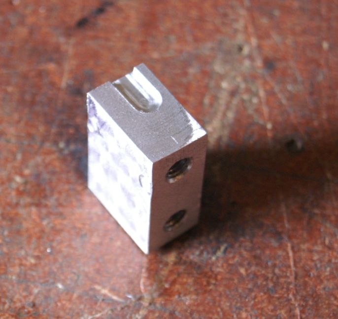

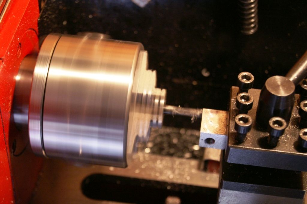

              milling exp sm (1).jpgThe problem I found was the home made cutter was pulling itself into the work, no matter how much I tightened the chuck. I got round it by turning a shoulder that fitted into the jaw serations.
              Hopefully the new gear will run better, find out in a bit when I get to the shed
