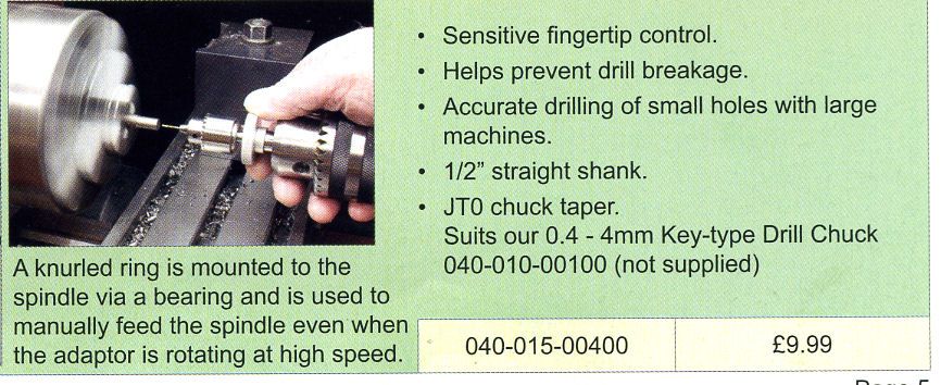

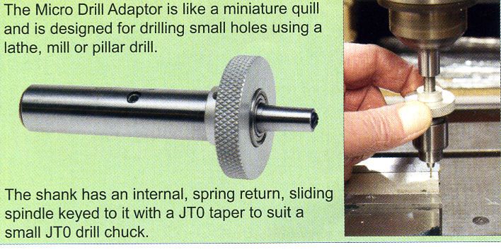

        Les Jones 1
          @lesjones1
          Hi Chris,
          Drilling very small holes with a normal size drill press is difficult as youdo not get the feel of the pressure on the drill bit due to the strength of the return spring. I made a drill stand to hold a small Minicraft drill (I do not think these are still available.) for drilling small holes in printed circuit boards. It uses part of the print head slide from an old printer to give a very smooth action with a long tension spring which only just supports the weight of the drill. Arc Euro Trade do a "Micro Drill Adaptor" (Item number 040-015-00400 for £9.99) This is basically a sliding spring loaded sleeve to take a small chuck which can be used in the lathe or pillar drill. There is a collar which you hold to apply the drilling pressure. Threre is no picture of this item on their webpage so I will try to attach pictures from the catalogue.
          Arc Euro Micro Drill
          One of these may be the solution to your problem. You could probably make one yourself if you are in a hurry. There was a thread recently on removing broken taps. This may help you to remove the broken drill.
          Les.

            Chris
            For small holes you need the fastest speed and to keep clearing the drill from the hole (pecking) to prevent build up of swarf in the flutes that can jamb and break the drill, and take care to ease back as the drill breaks though, having a light tuch helps.
            Stew

                  This is a good tool. We used it at a company that I work in and drilled a 0.4mm hole with it.
                  Andy.

                                        Chris,
                                        I understand your pain here! I managed to get through a number of small drills while practising drilling fairly deep in aluminium on my bench drill.
                                        I now have one of the 'sensitive' drill adaptors shown above and a small chuck to mount onto it.
                                        I have yet to use it in anger, as I resorted to larger holes rather than keep eating small drill bits!
                                        The whole setup makes sense with it though and here is a summary of the advice I recieved:
                                        1. Use a sensitive adaptor – your big drill will just crush the bit
                                        2. Plenty of cutting fluid – I used WD40 or paraffin on the aluminium I was cutting (this makes everything much easier to cut, I am slowly learning)
                                        3. Peck at the hole to clear the swarf often – very small amounts of swarf can easily get jammed inbetween the bit and the hole side and lock up the bit, your drill then twists the whole thing off the top and you expand the list of words used to describe the process…
                                        Have fun with it all!
                                        Rob
