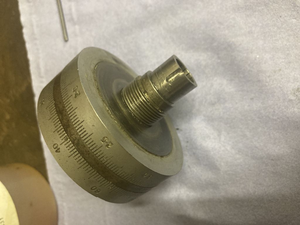

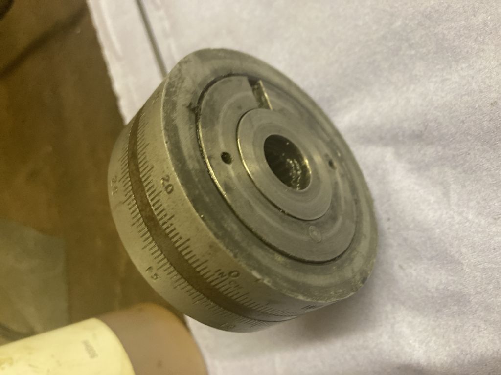

      To cut to the chase, hows this come apart!!? I don’t want to force anything but my reason for stripping it, is that it’s already seized solid, and I can’t zero the dial even with the lock ring backed right off. This, it’s hard to tell what should and shouldn’t be forced.
      Those two holes, are possibly tapped, and m3 screw fits but i’m sure it’s imperials as the grub screws were.
      Its a vickers dual metric/imperial dial and it’s been jammed since I bought this lathe. No doubt one of the planet gears (more likely, the only planet gear) is damaged.
      It wouldn’t be a problem as I don’t tend to use imperial (it’s a metric machine) but when I loosen the lock nut to zero the dial, it’s jammed solid, and I like to zero especially with these dials as the major and minor graduations are a bit odd!

          Looking at your 2nd pic it looks like the 2 holes that are opp to each other would accept a spanner similar to the ones used for removing a grinding wheel. Not sure of the name
          Steve.
          #499999
          Emgee
            @emgee
            Perhaps if you add screws to the holes and turn in they may act as drawers/pullers to remove the end plate, I don't think they are for a pin spanner because of the threads.

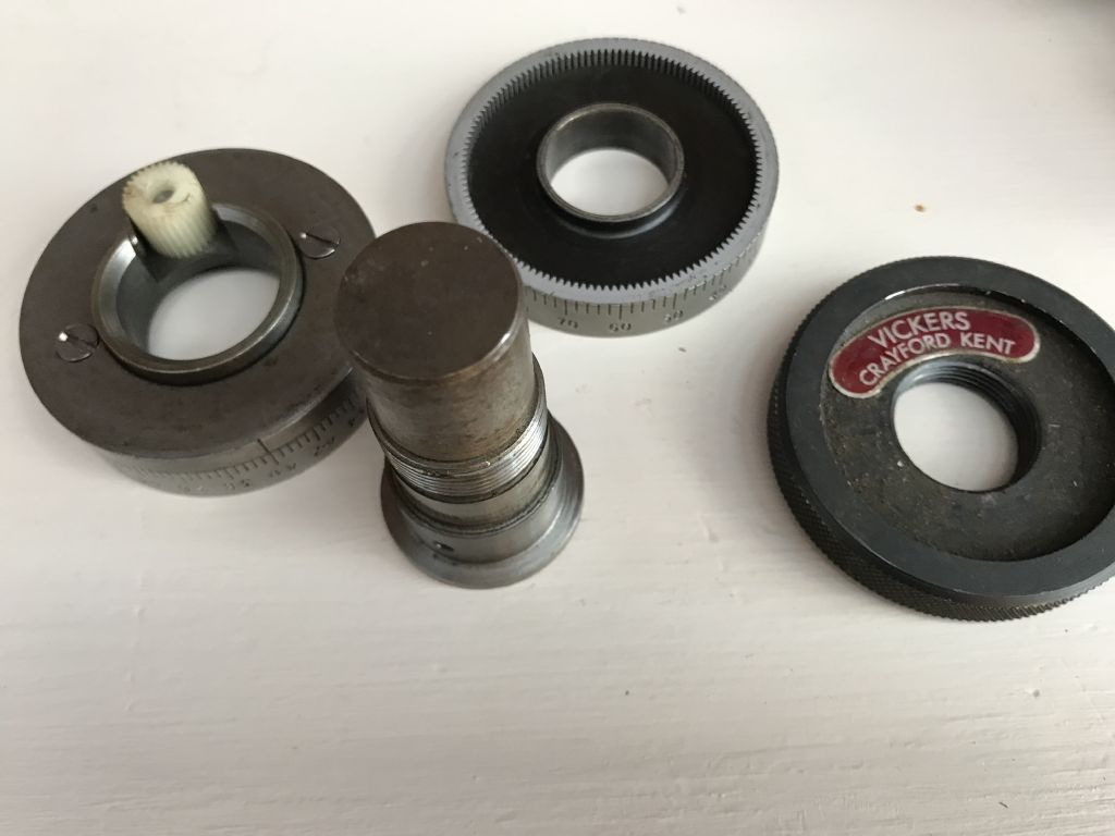

              Hello Russ,
              These are very nice bits of kit. I have some NOS ones of these and will dig them out to check the disassembly method. I think there are some instructions I have on fitting and maintenance, but will need to dig them out tomorrow.
              From a very cloudy memory there is a hub held in by a snap ring (eared external circlip style) which should be on the outer side from your photos – the side visable in the photo is the machine side rather than the handle side. The slot between the two holes takes a pin (set in the, say, cross slide casting for example) which is the restraint for the centre hub. I believe there are two planet wheels, one for each of the dials and the clever bit from memory was that they were identical tooth wheels but of slightly differing diametral pitch so giving a differential gearing.

                    I have now managed to get in to it. The two tapped holes are a red herring, they secure the centre steel plate to the backplate retaining the driven gear/dial.
                    It was simple a case of tapping the threaded end of the shaft back though the assembly. It was incredibly tight due to damage and burs on the shaft from a previously botched repair. To worsen matters the black steel hub which is a press fit into the driver gear/dial has been beaten to death with a hammer on the inside spigot which is a close fit inside another shaft, which caused it to seize.
                    Add to this that the press fit hub isn’t pressing all the way in, and they are the main causes of the issue. Someone’s had a go at fixing it, and beaten it to death. I’ve done my best to dress it up with a file and stone but Vickers really put some close tolerances on these things so it’s still drags slightly here or there.
                    I need to determine why the hub isn’t pressing all the way in tonight because it’s causing the driver gear/dial to rub on the steel centre part (which is secured with those 2 internal screws). The plastic gear inside is toast but I’d be happy just removing it for now if this press fit weren’t rubbing and seizing. Currently the only way to use the machine is to loosen the lock but fully and allow the graduated metric ring to spin freely, which makes it hard making things to a dimension!

                        DC31k – I did say "From a very cloudy memory" as it was 40 odd years ago since I had one apart!
                        Russ – Right I have assumed yours is the 2 1/4" diameter dial. I have 2 1/4" and a 3 1/4" dials. The differences are that on the 3 1/4" unit the threaded holes are not opposed diametrically so suggesting a different internal assembly. I have stripped the 2 1/4" unit and taken photographs which I will post in a following action.
                        The news is that the threaded portion that has been assumed to be for a face pin spanner are in fact retainers threads for the internals. I think the 2 1/4" is a 4BA thread, the 3 1/4" unit is definitely 3/16" x 32 BSF.

                            Here is the strip of my unit – more photos in my album "Vickers dual dial handwheel indicator" for those that are interested.

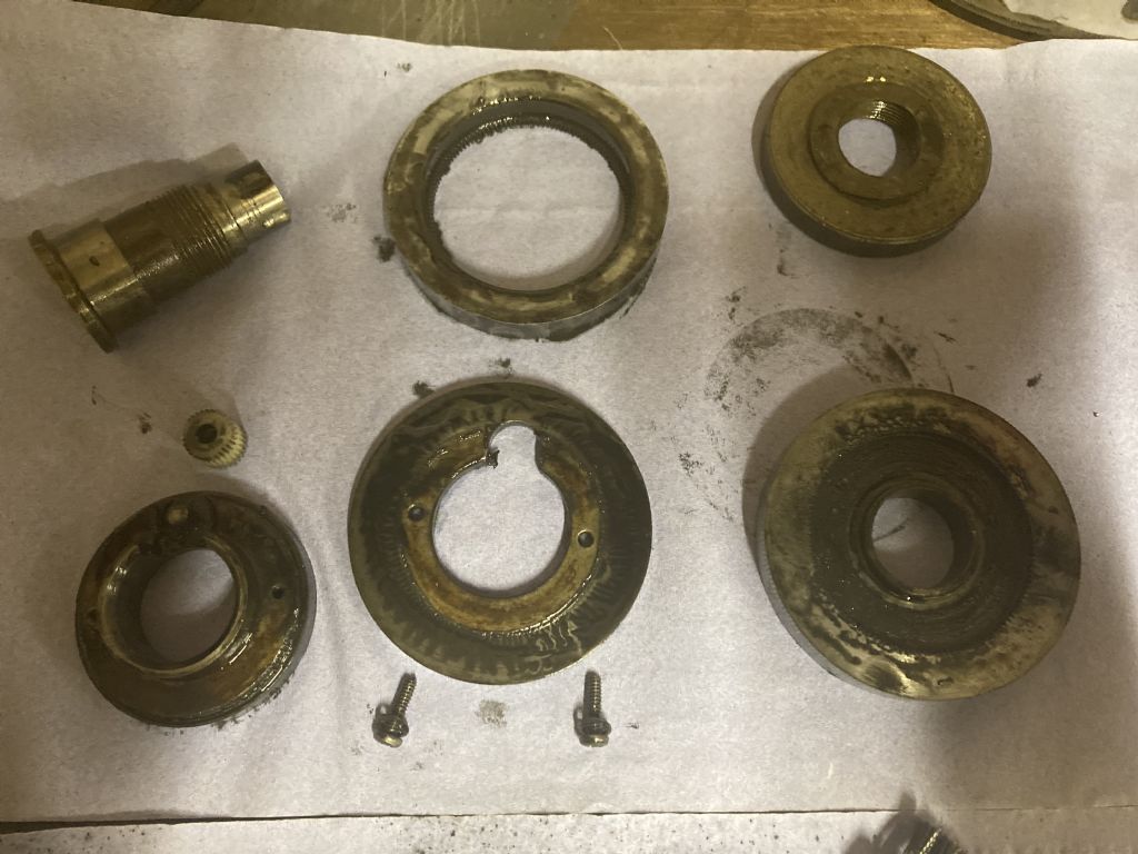

                              Yes the photos would still be very useful considering mine still doesn’t work on reassembly!
                              As i’ve said i think the steel hub isn’t pressed all the way into the driver/dial. This steel hub locates against the face of the first step on the shaft and because the gear/dial is standing proud it’s locking against the middle fixed steel plate when there should be a very small clearance I had initially wondered if I was missing a shim, but given the close tolerances of everything, Vickers probably didn’t need to shim anything!

                                    Starting from the rear of the assembly (i.e the face which abuts to the machine slide) the centre hub has a 0.010" stand proud, the rear satin chrome ring – metric grads is 0.0075" less than the 'hub'. Holding the hub and rotating the satin chrome ring the plastic gear wheel spins freely.
                                    Assembling the Imperial graduated satin ring onto the centre shaft the rings become locked to each other when turning one against the other – as you would expect as the nylon gear interferes. The plastic gear protrusion prior to assembly is 0.1225" and the depth of the internal ring gear in the Imperial dial is 0.1245" measured from the dial periphery. Measured to the hub centre spigot it is 0.130" Just to clarify this is the measurement from central hub spigot to the bottom of the recess – think this then allows the dials clearance to spin freely when the hub and centre shaft are clamped by the black knurled outer ring. This makes the black ring the dial unclamp/clamp system.
                                    The black knurled outer ring – retained by the thread and a circlip releases the assembly to allow the dials to spin to a zero position (depending on whether you want Metric or Imperial). The plastic gear is 0.476" dia x 0.4305" long with a 0.1876" hole (measured by pin gauge) the teeth are 30 (or 31! – need to get my eyepiece out) which makes them either 67DP or 69DP probably a modified 68DP? might be reproducable by my instrument restorer?! and made in brass??

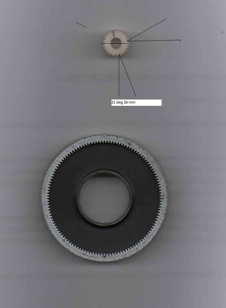

                                      The nylon gear is 29 teeth! after repeat counts and confirmed by putting on a shadow graph. The tooth form looks straight sided. After discussing this with my instrument restorer he thinks this is normal for such a small internal meshing gear. He has a cutter which I can check to see if it is suitable.
                                      I assume the nylon gear tooth count is not important so long as it translates to both the inner gear counts within the dials to effect the 5.08/5.00 (probably 254t / 250t internal teeth – don't fancy counting them!) turn ratio needed to give the required differential.

                                        Posted by Oily Rag on 07/10/2020 19:01:09:
                                        I believe the ‘straight sided’ form of the gear is necessary because it meshes with two different tooth counts of the same pitch diameter.

                                          It certainly looks that way Michael – Problem with the shadowgraph is the small size of the gear in relation to the length of the tooth which causes an 'out of focus' blur around the tooth form, I'm looking at making an imprint and then shaving it to about 2 or 3 mm to give better definition. If we are going to make one we need to get the angle correct for the tooth flanks – I suppose CAD could be the answer, but I was asleep in class for that part of the lesson! In fact I'm so old I may be the only one who knows what a chisel point HB is when it comes to tech drawing.
                                          #500132
                                            Posted by Oily Rag on 07/10/2020 19:43:32:
                                            Problem with the shadowgraph is the small size of the gear in relation to the length of the tooth which causes an 'out of focus' blur around the tooth form, I'm looking at making an imprint and then shaving it to about 2 or 3 mm to give better definition. […]
                                            You might also try putting it on a flat-bed scanner, at 1200 dpi
                                            … The results can be very satisfactory.

                                              So, my steel mid section is actually thicker than yours, exactly 3/16” in the centre. It’s obviously been rubbing this for some time as it’s worn down a thou around the edges.
                                              I’ve determined from careful measurement and sketches an interference between the steel mid plate and driver wheel of 0.1305mm or 5 thou, it’s right there on paper, double checked the dimensions and laid it out twice.
                                              No way around it, it just doesn’t work.
                                              If my mid steel plate was 4.5mm like yours, I’d have exactly 5 thou clearance….. sounds comfortable to me.
                                              I need to get some 4.5mm plate or find someone with a small surface grinder!!

                                                Taking Michael G's suggestion (thanks Michael!) of scanning the gear I have measured the tooth form of the dual dial driver gear as 21 deg 28 min included angle between the straight flanks, 0.034" depth of tooth, and with 0.0145 flat crest on tip and a 0.010 flat in the root. I can knock one of these up for you if you need me to but would prefer to make in brass (I hate machining nylon!)

                                                  Well, I got there in the end!
                                                  After all the trouble I had with the crossfeed dial I decided to strip and clean the compound, which turned into a full strip and clean of the compound slide.
                                                  Interestingly when I stripped the much smaller vickers dial, it was actually exactly the same internally, the graduated dials were just machined down to around 3/8th larger than the press fit hub as per martin’s photo above actually, you can see comparing his dials to mine, mine have much more meat on the dials!
                                                  After some comparison between the two, I reached the same conclusion but for a different reason which is kind of important just in order to understand what went wrong. Basically the press fit steel hubs internal spigot had been machined or rubbed down, presumably damaged OR a replacement part intended for what looks like the later design that Martin has NOS of? So when the knurled wheel was tightened, rather than locking the steel hub/graduated dial to the shoulder on the shaft it was pushing it into the steel mid plate. After machining the mid plate down there was then a small interference with the gear carrying backplate that retains the driven wheel and mid plate, only very minor, a quick hone and everything was as good as new, almost. The locating peg that holds the driven half of the assembly in place is a bit damaged, and slotted more than it should be! The whole assembly has obviously seen some abuse.
                                                  So all functional now, albeit without the imperial readout as I had to remove the damaged pinion gear.
