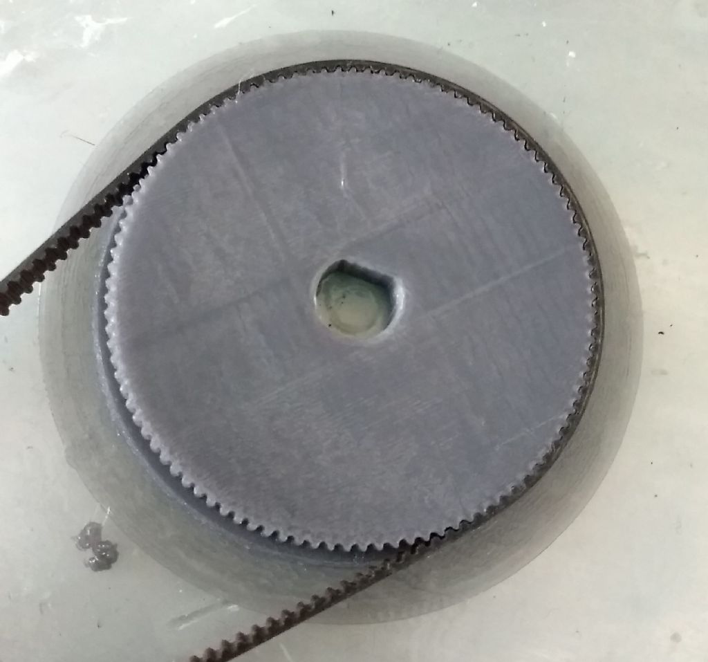

        I 3D printed a timing pulley, calculating the diameter as:
        pitch x number of teeth / PI
        The result was a (100 tooth) pulley that was about two pitches too large in circumference. (A 20-tooth pulley seems fine as the error is too small to have an effect).
        I couldn't find a clear calculation online, but measured a real 66 tooth pulley which was just over 98.2% of the calculated diameter.
        I did find a diagram that showed how the pitch line is some distance 'up' the teeth, but no formula for calculating the amount of compensation for this.
        I'm printing a second pulley using the empirical figure of 98%, as this seems right if the original size was two pitches too large for a 100 tooth pulley.
        But it would be nice to know a formula for calculating the correct figure, especially if I create machine pulleys in the future.

                I did spend about 20 minutes looking.
                I've now found this:
                Pitch Diameter (P.D.) = (Pitch x Number of teeth) / Pi (3.14159)
                Timing belt pulley Outside Diameter (O.D.) further builds upon the relationship between the timing belt pulley and timing belt. The Outside Diameter (O.D.) of the timing belt pulley is in contact with the tooth bottom of the timing belt while meshing with it. The distance from the timing belt tooth bottom to the tensile cord (pitch line) will determine the Outside Diameter (O.D.) of the timing belt pulley for any timing belt pitch/timing belt tooth profile.
                Outside Diameter (O.D.) = Pitch Diameter (P.D.) – (2 x U)
                Note: “U” = distance between the tensile cord and the bottom of the timing belt tooth
                The challenge is now finding 'U' for a 1.5mm belt, which seems to be a bit obscure…

                      From Gearotic:
                      HDT5 100 tooth wheel.
                      O/D 158.0119
                      Outside Radius 79.006
                      Pitch Radius 79.5775
                      Root Radius 76.846
                      Edited By blowlamp on 23/05/2020 16:59:23

                        From an article that i wrote in MEW 164 there are some calculations for 1/5 xl 3/8L and 5 mm htd i can't find the article among my notes .For 1/5 xl it is .200 x number of teeth divide by Pi – .020 inch = OD,
                        100 tooth pulley = .200 x 100 = 20 inches divide by Pi =6.366 inch – .020 inch = 6.346 inch ,in all
                        cases the pitch diameter is always is always greater than the OD.

                            It seems U is about 0.5, but that's me trying to measure it with a calliper!
                            Still my new pulley seems OK. 0.1mm nozzle is very precise, but very, very fussy about settings!

                              It seems the calculations are different for different pulley sizes. For the 1.5mm belt the 66 tooth pulley is allowing about a ~0.5mm reduction.
                              The 100 tooth pulley was designed with a greater reduction than that but printed slightly oversize soworked out with a 0.5mm eduction below theoretical size.
                              That's not what I expected from the print, but the ridged surface does mean that prints are often slightly oversize, even with me using a correction, its the one for a larger nozzle.
