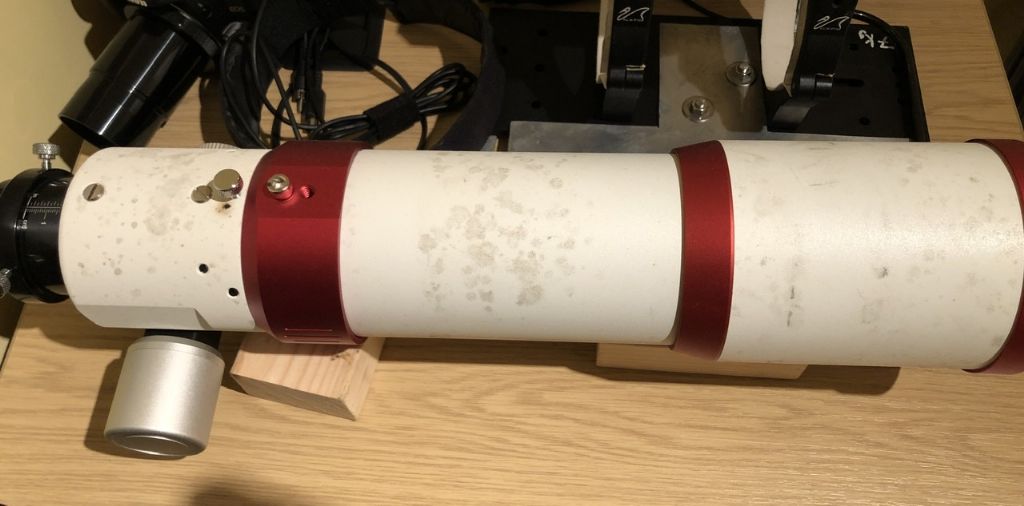

      I left my astrophotography gear under cover outside for the winter nonths – a mistake I know.
      When uncovering I found mould had grown on the powder coated (?) telescope tube. See photos below.
      Any recommendations on how to clean it?
      From Internet searches it seems bleach with a toothbrush is a good way to go, but thought I should get some extra advice before driving in! Thanks in advance.

        #461665
        Hopper
          @hopper
          Here in the tropics where we get 8 feet of rain a year snd things tend to go a bit mouldy we generally use a mix of household detergent and bleach. Bloke i pay to do the outside of my house swears by it too .

            Dilute vinegar would probably work too..many moulds are sensitive to pH

              HG mould spray is very effective but vile if you breath it in, probably just a bleach though.

                Bleach does not kill mould, it just bleaches it. Anything sold as a mould killer won't be just bleach.

                      That looks like a decent scope so don't attack it with bleach! Best to try simple warm soapy water and a soft cloth first – you can give it a good rub but don't damage the paint. If that doesn't clear it try isopropanol – you can get that via the internet. Keep well away from Meths/white spirit etc as they will almost certainly damage the paintwork.

                          " When uncovering I found mould had grown on the powder coated (?) telescope tube "
                          Polyester powder? If so, it shouldn't be used for external usage. Solution, use Epoxy powder or don't leave outside.

                              When you read Google carefully it mostly says hard surfaces, as in glass, metal and glazed surfaces of tiles which will clean with a cloth anyway.
                              Most coatings have a porous bit which is why moulds get into gloss paint and silicone sealer.
                              Linky this is as good as any link
                              In the OP's case there's apparently no mould on the hard anodised surfaces, just the powder coat, so it may have grown into the coating. There nothing to stop trying bleach, it may reduce the black but it will grow back given half a chance.

                                        The best product I have used for the removal of black mould and the staining it produces is 'Kilrock BLAST AWAY Mould Remover'. While I don't know what the effect might be of applying it on the painted surface of your telescope I have used on a variety of surfaces including emulsion paints, oil based paints, various plastic surfaces, silicon sealant, acrylic sealants, bare plaster and have not noticed any detrimental effects to any of these surfaces. That said one of its constituents is clearly a bleaching agent similar to normal household bleach probably sodium hypochlorite. Not only does it remove all traces of the mould, including any staining, it also seems to actively inhibit regrowth especially on the more porous surfaces.
                                        It might be worth testing some on a small inconspicuous area to see how quickly it removes the staining/spores and check if it has any detrimental effect on the coating. You can purchase as a liquid spray or brush on gel from various high street outlets or from ebay.

                                                  Thanks for the help all. Scrubbed on branded mould cleaner with a tooth brush, took it off within about 5 secs. Then I liberally wiped with a damp cloth afterwards to remove the residue bleach.
                                                  —> now good as new!

                                                      An effective, safe fungicide is benzalkonium chloride. This is used for everything from eye drops to patio cleaner. Dettol dishwasher cleaner is a good low volume source. It works well on sensitive surfaces. Bleach (Sodium Hypochlorate solution) most certainly DOES kill fungal growth and inactivates spores. It also bleaches any colour deposits. The disadvantage is that it causes corrosion.
                                                      Killling and removing the fungus may not restore the surface finish. Chemicals secreted by the fungus can etch or corrode the surface causing damage that has to be repaired by re-finishing or polishing. Fungus won't grow on aluminium but it will grow on contamination on surface, even finger prints. Th secretions can still etch the aluminum giving the impression that the fungus "eat" it.
