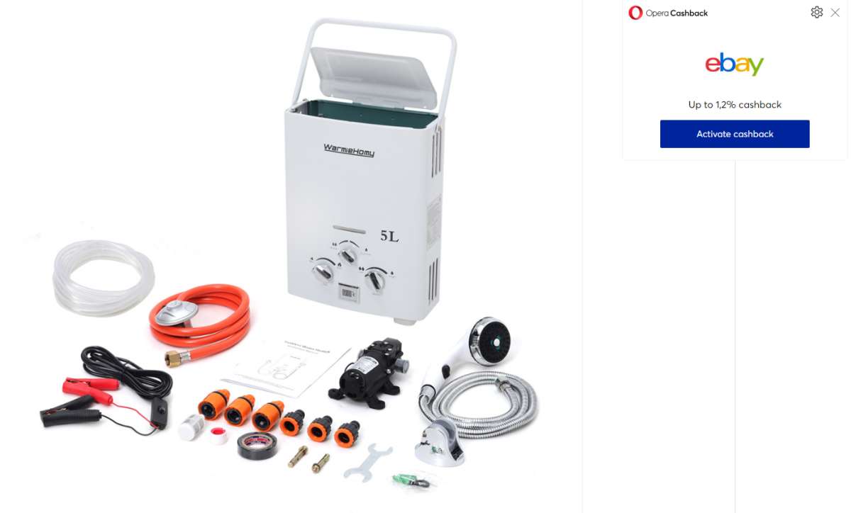

            How about a propane tankless instant water heater;
            I’ve no experience of them, but here’s one example from Amazon.
            Some are designed for outdoor/camping use, so likely work off a 12v pump and bottle gas.
            Other sources and models are available.

              Oh right, someone’s stolen the photo again
              image_2023-12-25_161730220
