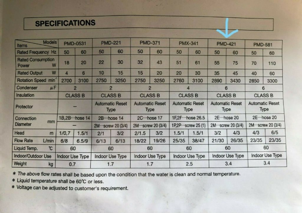

      Im looking at a water pump on ebay **LINK**
      the item describes the thread coupling as 2E – hose 20: 2M screw 20 (3/4). Whilst I can make assumptions as to what the thread is can someone in the know please tell exactly what this means in easy speak? Thanks.

          3/4" BSP

            Like Colin, BSP would be my first thought., with the OD and pitch to confirm. Europe calls BSP "Gaz"

              When I click on the ebay link the description says "Sanso Magnetic Pump PMD-421 with a 3/4" connector (standard Hose Connector). Not as stated above by Fizzy "2E – hose 20: 2M screw 20 (3/4)". ??????
              With the conversion to metric, imperial BSP sizes were rounded up. 3/4" became 20mm
              The European terminology for the use of G (BSPP) and R (BSPT) originated from Germany (G for gas, as it was originally designed for use on gas pipes; R for rohr, meaning pipe.)

                      It gets more confusing. Here in France 1/2 in BSP thread is called 21 mm, 3/4 BSP is called either 26 or 27 mm.
                      Note – Colin, 3/4 BSP has thread OD about 33 mm not 20 mm.

                          I'm pretty sure that you will find that the 3/4" refers to the OD of the connector and that it will be 1/2" BSP.

                            measured od at 26mm which i think makes it 3/4 bsp….s-l1600.jpg

                              NPT uses different pitches, as well as thread form,(60 degrees ) from B S P. (55 degrees )
                              Many seem to differ by just just one pitch over an inch.. The combination renders them non interchangeable .
