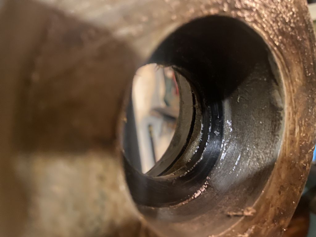

        Actually, its a bit of a mystery.

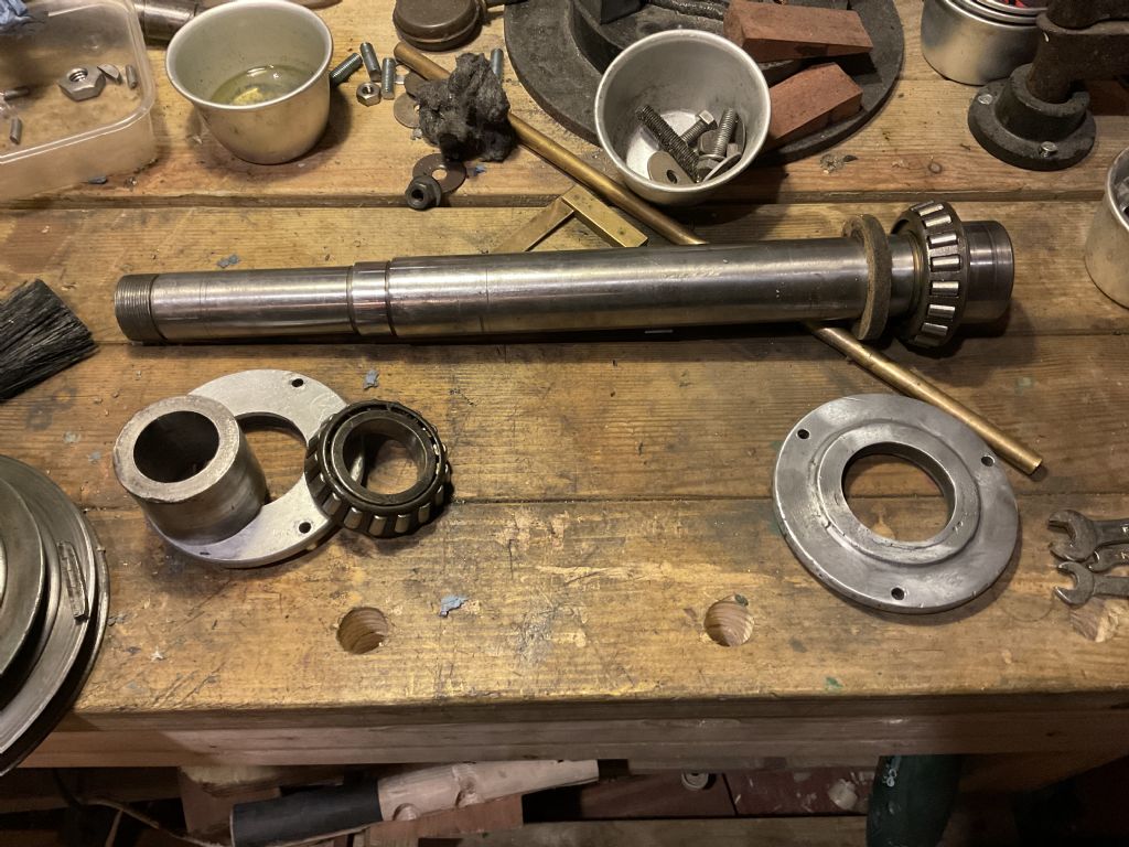

        At the nose of the spindle, there’s a cover, followed by a Timken bearing, followed by a felt washer, followed by a bearing seal, to keep the grease in I guess.
        But at the tail end, from the outside in, there’s a cover, in which goes a steel bushing, then a Timken bearing. No felt washer, no bearing seal. I wonder if these are missing, or if this is how it is meant to be?
        The bearings all look in good condition, and the spindle also.
        a few pics below.

          That might well be right – it's not likely for to debris to enter the back bearing, and the sleeve should be 'a-close-fit-with-a-little-clearance' in the cover – I think in standard format the central portion / pulleys and belt were enclosed within covers, and the take-off for the cross-feed drive lies well below spindle height.
          Seals generate friction so could have been omitted to make setting bearing tension and adjustment easier / more consistent in use..
          Unless you find (or someone has) compelling evidence of a seal I'd be inclined to rebuild it as found.
          There's a slim possibility that the one I used to own might still be available to inspect, I will endeavour to track it down (if it's still even extant), Covid permitting and as time allows..

            Ok, well if you do have any chance to get any info, that would be gratefully received. I think you are probably right though.
            How does one set bearing tension in this arrangement?

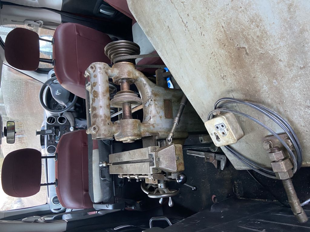

            Having now stripped some of the paint it seems likely it has been repainted at least once.
            With any luck I can strip it on Sat, start the painting on Sunday. Might even have it back together by Christmas.

              In essence you need to eliminate any play in the bearings by applying a very little tension (or pre-load) using the adjuster at the back, at the same time taking care that the spindle is free to rotate without excessive friction.. ..because there is no prescribed tension or measurement provided, you'll need to run the spindle to finalise the setting by 'feel'.

                  In automotive use, Taper Roller bearings are set with end float ( 0.002 – 0.004" usually)
                  This is not the case with such bearings in machine tools, where the preload is likely to be of the same order, to eliminate any possible movement.
                  Do not overdo the preload., otherwise bearing life will be short.
                  If in doubt, just apply the minimum of preload.

                    ..I think because in this particular case you are re-tensioning 'already-seated' bearing pairs, you should exercise some caution to not 'over-load' the bearings from the off – gently does it, with as much judiciousness and patience as you can muster, as you won't have as much of a 'running-in' grace period – it will be easy to add a little more tension later if necessary.

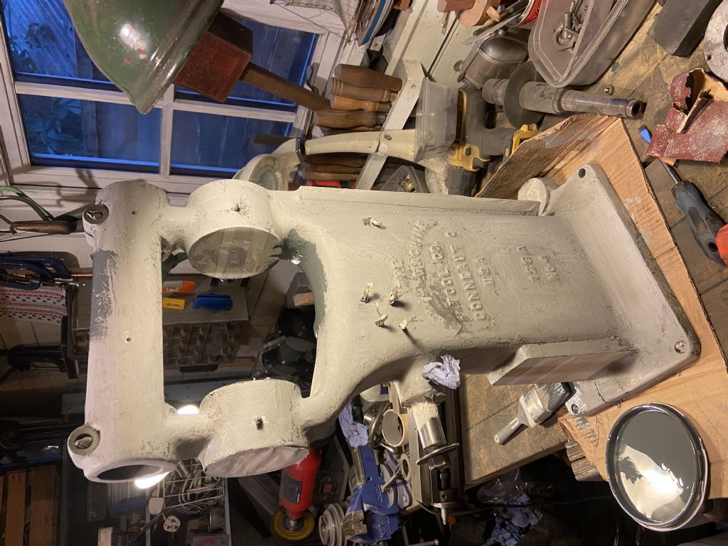

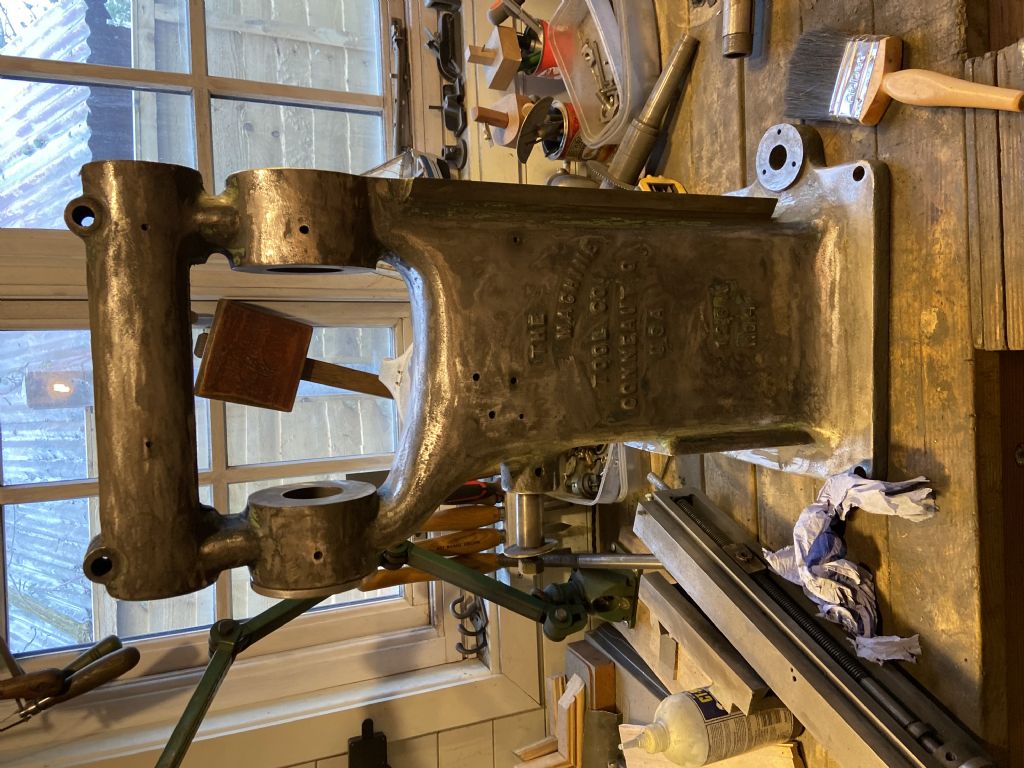

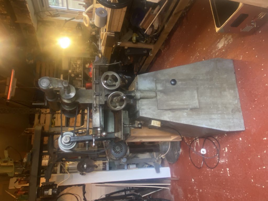

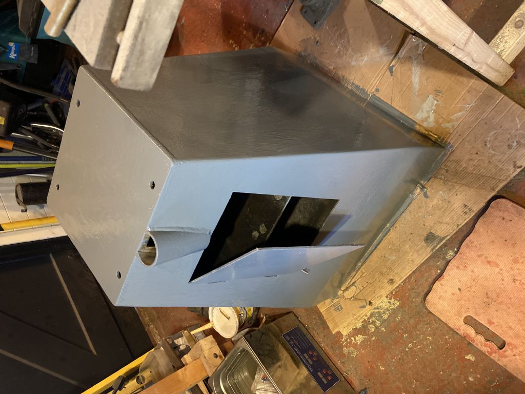

                      Thanks very much for the info chaps. I’m well into the refurb now and it’ll be a few days before I get to reinstalling the spindle and bearings, but then I’ll return to this. Last weekend was stripping, priming and painting. Stripping was a miserable job!
                      Space left to try to restore the BURKE lettering ground off by someone for inexplicable reasons….

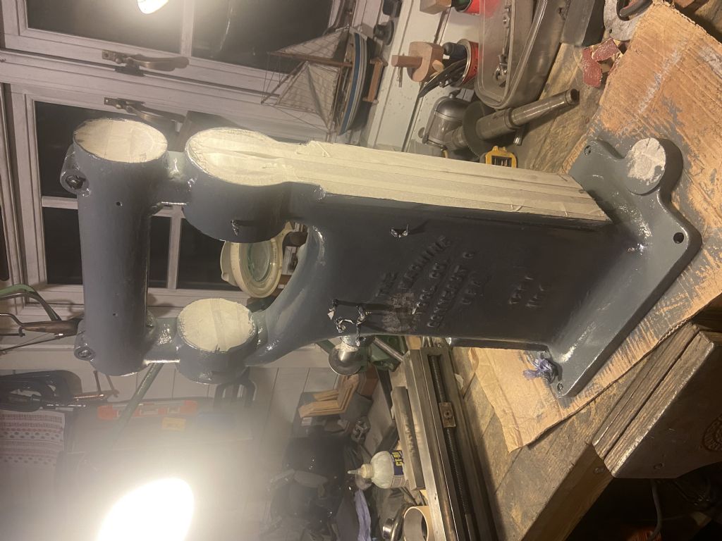

                        Starting to come together now… just the motor to do.
                        then tidying up frown
                        As was…

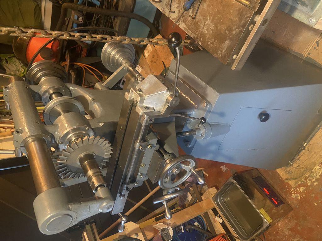

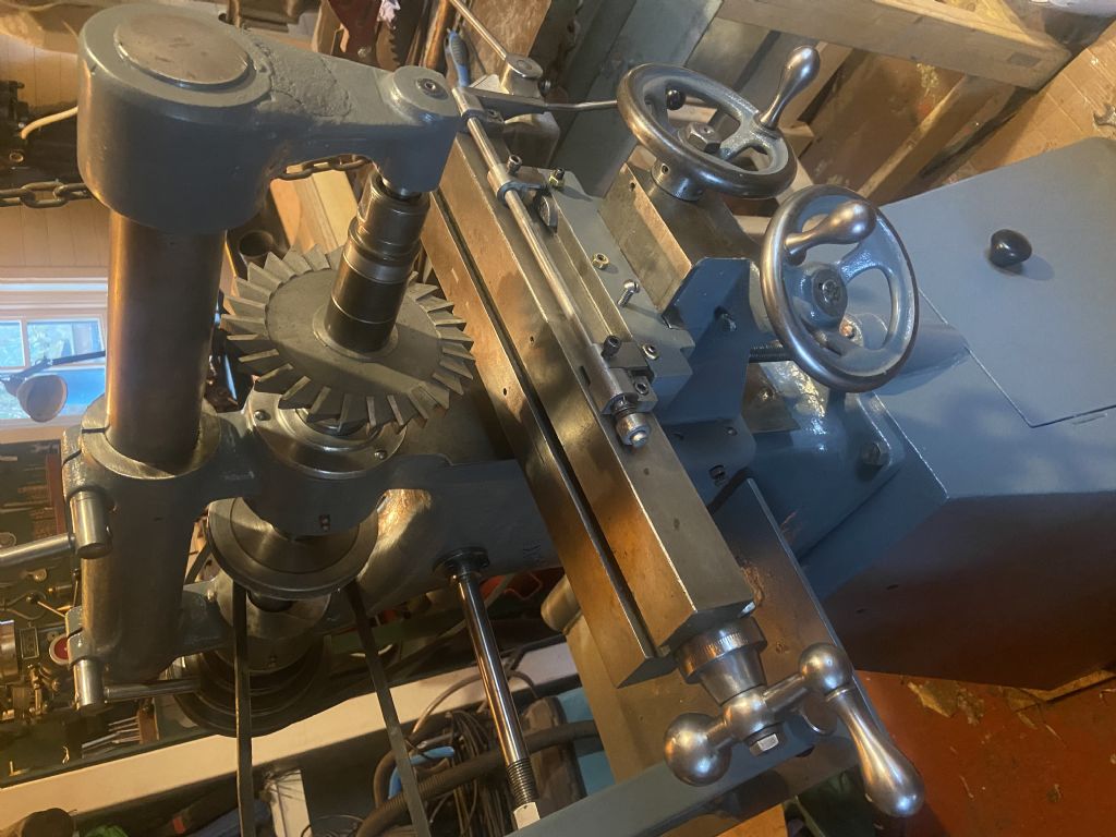

                          Looks like a decent set-up, good to have all the traverse and the knock-off bits still there.
                          ..just as an observation in passing, I think as far as cutter size for lightweight horizontals goes, less is most definitely more – using the smallest cutter that will achieve the cut you need is the way to go – for anything wider than a slitting saw, I'd rather have used a 2 1/2" or 3" cutter any day than a 4 or 5" one..
                          #577169

                            It’s certainly a damn sight better than it started out. But I won’t be able to cut metal until I’ve got a new belt or two unfortunately.
                            That’s the biggest cutter I have, more for impressing the wife than actually planning to use it at this point
                            Final task is to install the MEM Startet I acquired for it.
                            and then the tramming, adjustments, swearing etc.
