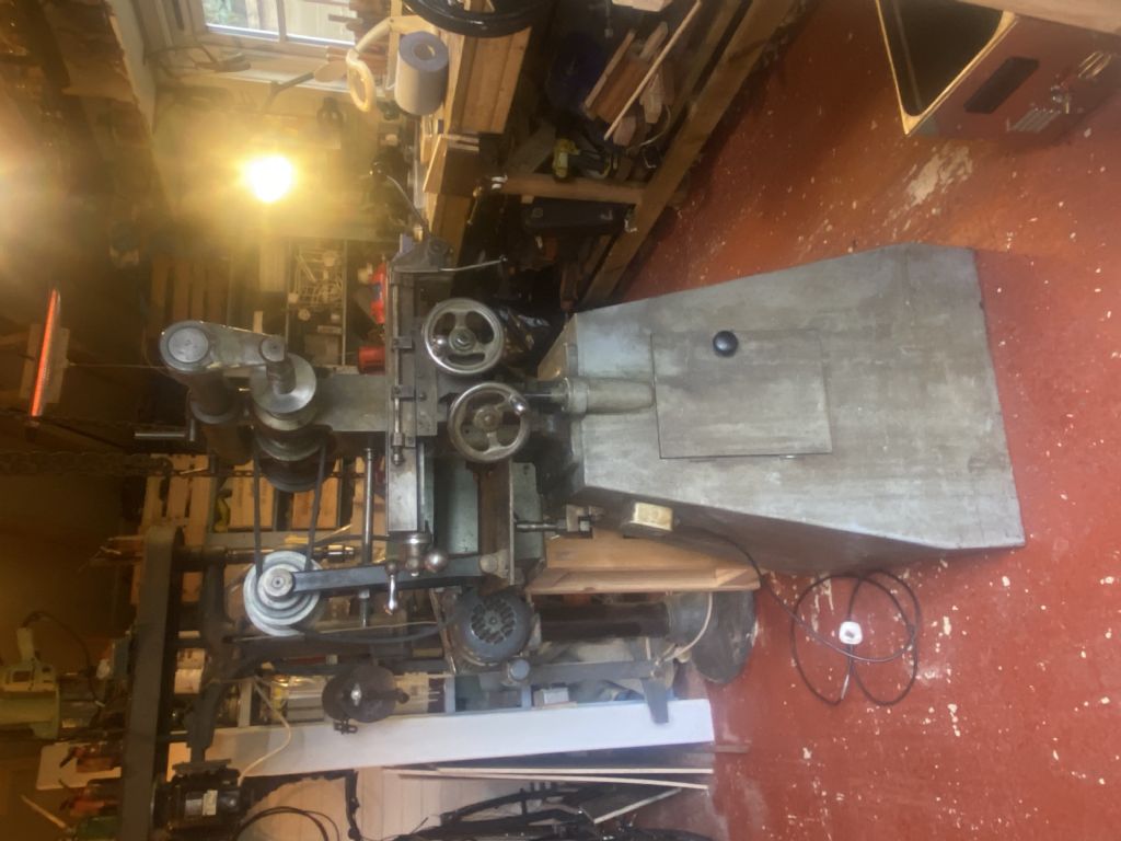

      Hi all

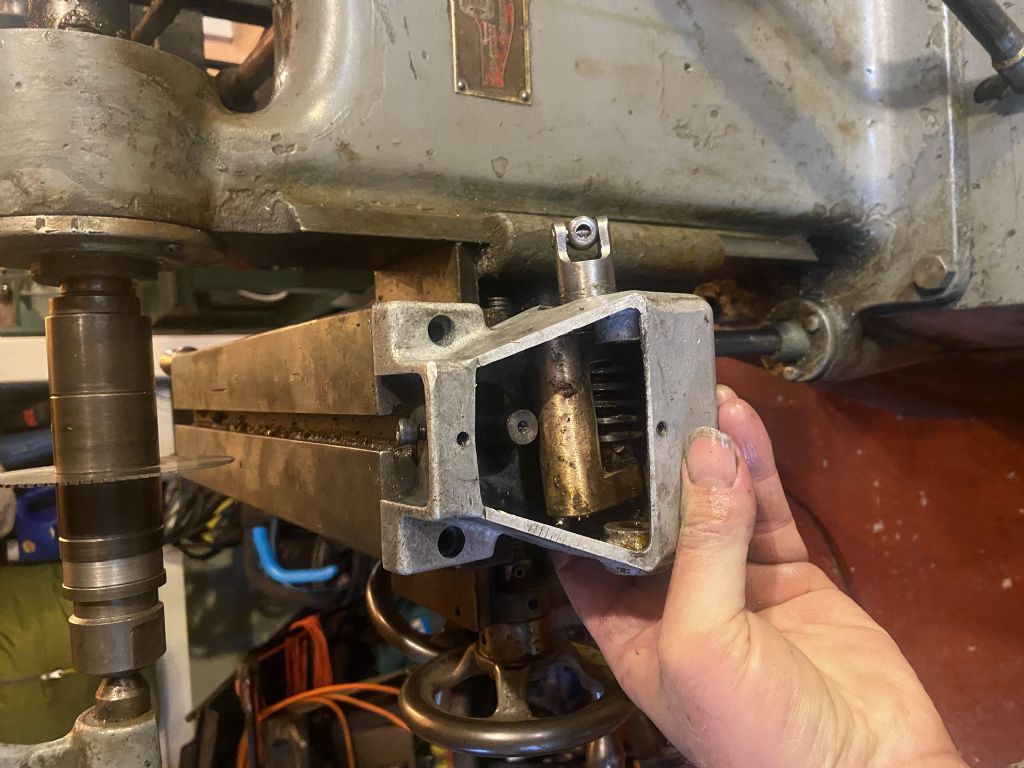

      As stated on another thread, I picked up a Burke horizontal mill recently, refurbing it is now my exciting new project now the Zyto and the Dore Westbury are working acceptably.
      I eventually managed to get it into the shed and assembled. Next step is to strip, clean, replace, refurb all the bits etc.
      I am already stuck.

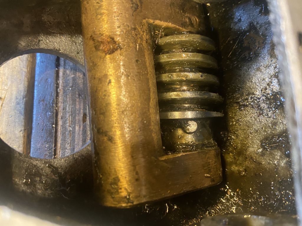

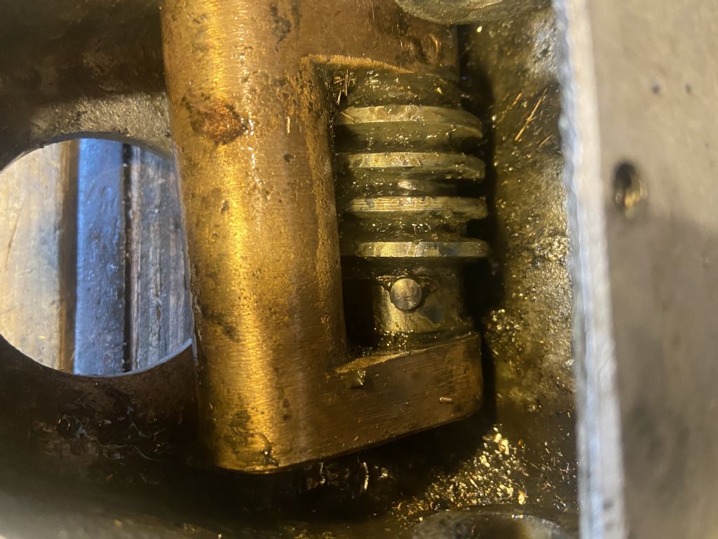

      There is a little power feed gearbox on the end of the table. it’s basically a worm and a gear attached to the x axis feed screw. I’ve got it mostly to bits, it was pretty much full of ancient grease and what looked like brass or bronze chips. So I’d better fully disassemble it.
      To get the worm gear out , it looks like there is a pin through it’s spindle holding it . One end is rounded, the other looks like the end to try to knock through, I have tried hammering it carefully using a brass rod so as not to flatten it. But no movement. I’m reluctant to hit it too hard for fear of damaging something.
      Any thoughts? Heat it? Freeze it? Drill it out?
      Thanks
      Steve

          I'd try flushing it out first Steve – degreaser and old paint brush to get things moving.

            Posted by Steve355 on 12/12/2021 10:05:04:
            The pin may be tapered, in which case I suggest it's knocked out from the rounded end. If so, worth making a punch with a basin end to avoid spreading the pin end.
            My experience of removing pins is limited, so wait to see what others say. However, when I fixed the shear pin on my lathe I had to remove the whole assembly and hold it in a vice. Then the pin came out easily! With hindsight, I think the problem was inadequate support in the lathe: I should have made something to hold the joint secure whilst tapping the pin out.
            Are you an experienced dismantler with a good memory? I'm not! Taking anything remotely complicated apart I take copious notes and photographs, and carefully keep related parts together in boxes and trays. The number of times I've ended up with half a dozen screws, washers, collars and larger components left over…

              Options: 1)soak the subunit and flush as per IanT and re-examine whether it's really necessary to disassemble. 2)Try tapping from the other side – however much it looks wrong – in case there's a subtle taper. 3) Heat as brass will expand more than steel, 4) drill out the centre of the pin carefully with an endmill if you can set it up for that.

                DPound to a pinch it’s tapered use a dremel  to clean ends to determine which end is the smaller of the two and bingo

                  Be very sure that there's enough clearance behind to knock the pin completely out. If you knock it half way out and it hits the housing behind, you will neither be able to get it out nor turn the shaft to knock it back in again.

                    Well, I think I might pgk’s advice above and not fix it if it isn’t broke. I was really struggling to get the grease and swarf out from behind it, but I’ve achieved that now, and it seems to be in good condition, turning smoothly, looking straight.

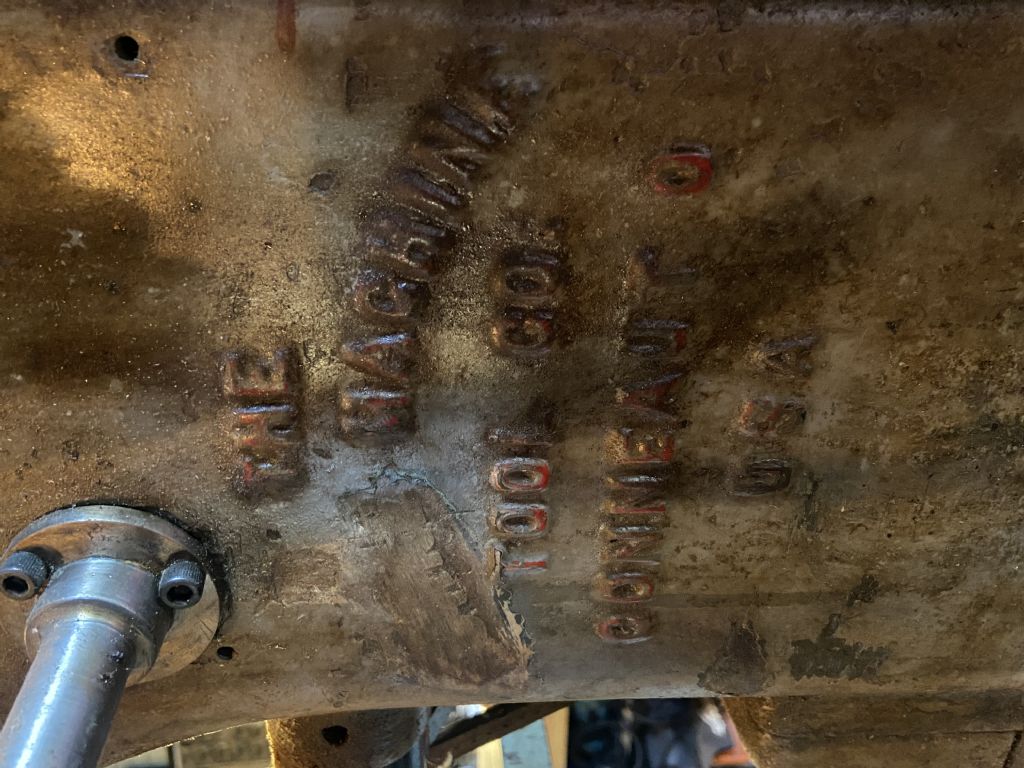

                      Also, at some point in its history somebody has ground off the name “Burke” from it. I’d really like to restore that if I can. Any thoughts as to how to do it would be welcome.

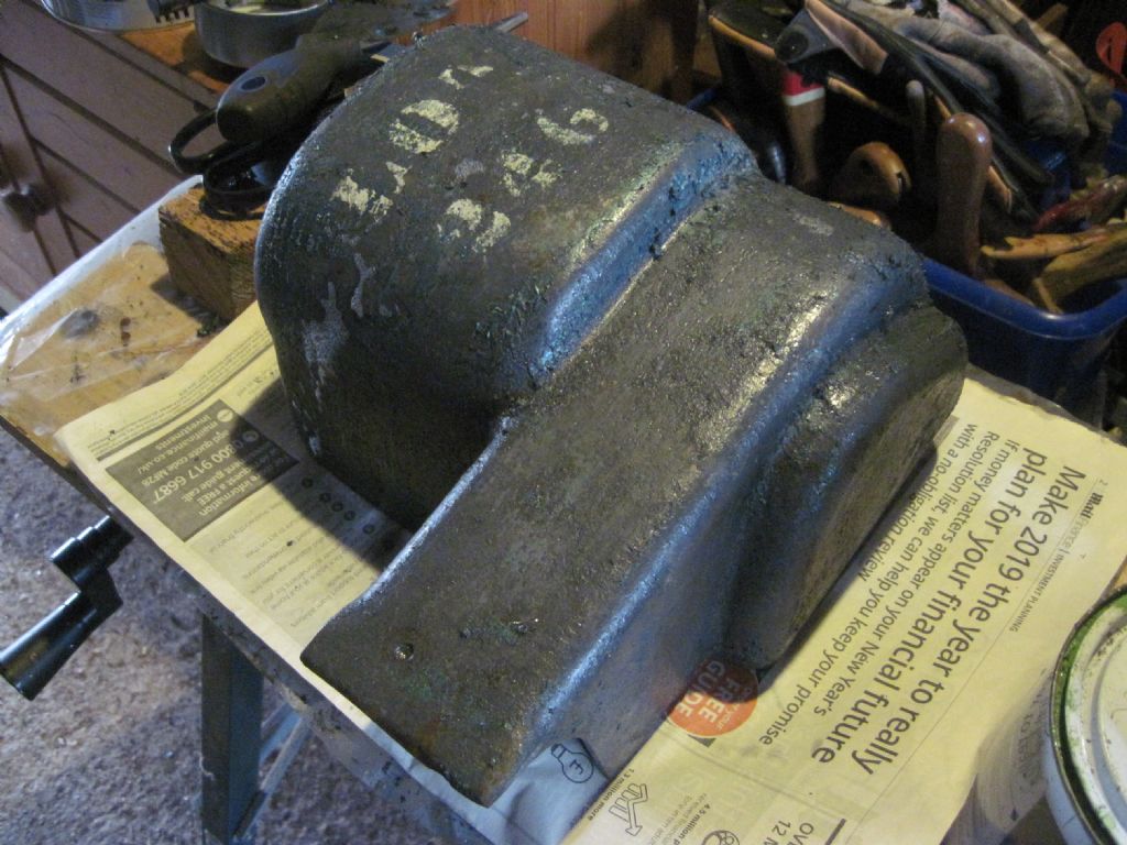

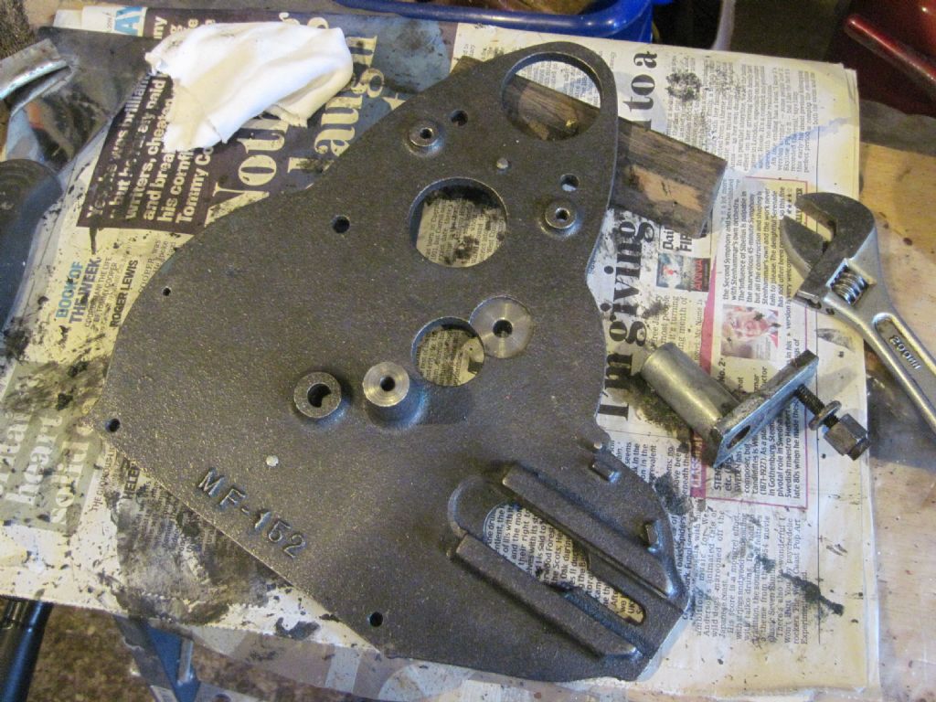

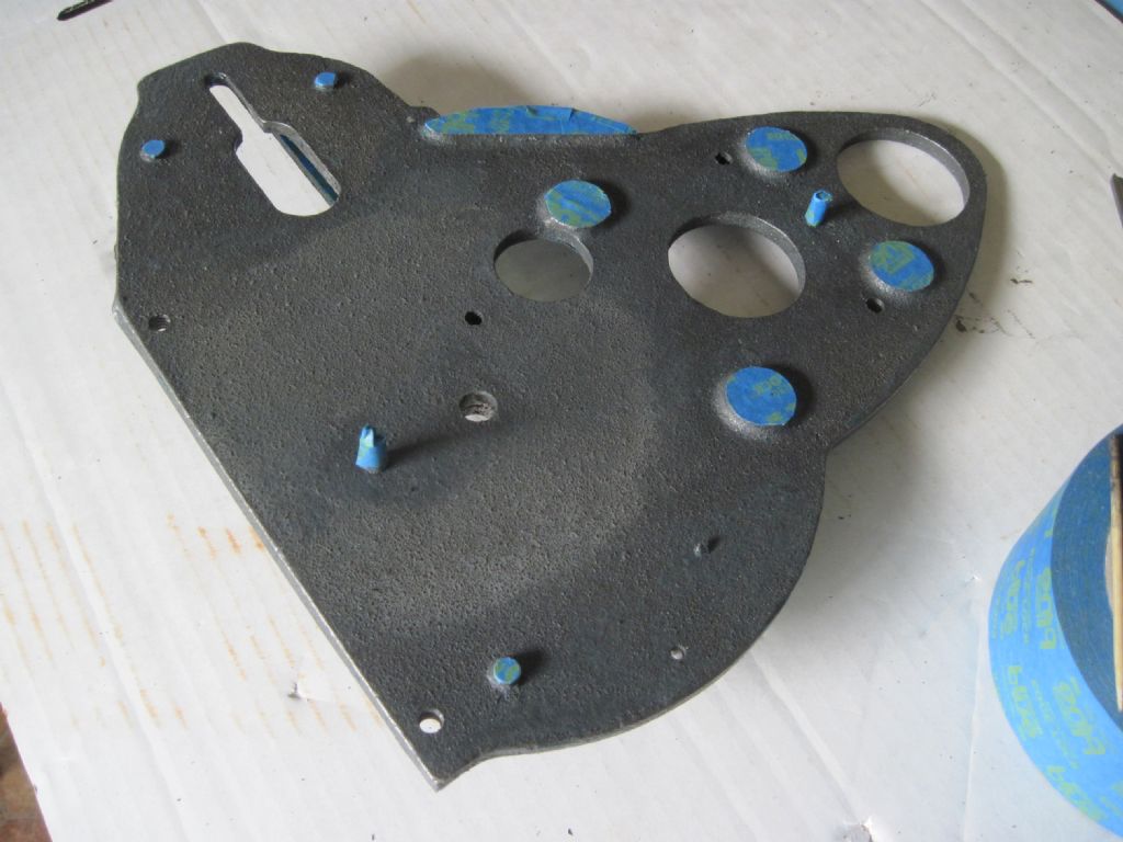

                                It will add quite a bit of time to the re-build Steve but generally I think it's worth doing if you are stripping the machine right down – and you intend to keep it.
                                I started out to fix a few things on my Atlas MF but had to virtually completely strip it to get inside the headstock, so decided to re-paint her whilst in pieces. So everything was disembled, stripped, cleaned, masked up and brush painted (inside and out). I've used a good quality machine enamel btw. Found some worn/broken/missing parts in the process, so I'm making replacements and I've also decided that I might as well change all the bearings including the main Timkens!
                                It still won't be like 'new' but hopefully she will be much improved and more to the point, I won't be using the machine wishing that I should have done 'this or that' when I had the chance….
                                But it all takes time.

                                  Excellent, Ian. On my Zyto I left the paint as is (for now) but on the Dore Westbury I completely disassembled, cleaned, and sprayed over the old paint. It wasn’t in too bad condition, mainly ugly and chipped in places. But on this Burke mill I think it needs to go back to bare metal.
                                  What stripper did you use?
                                  thanks
                                  Steve

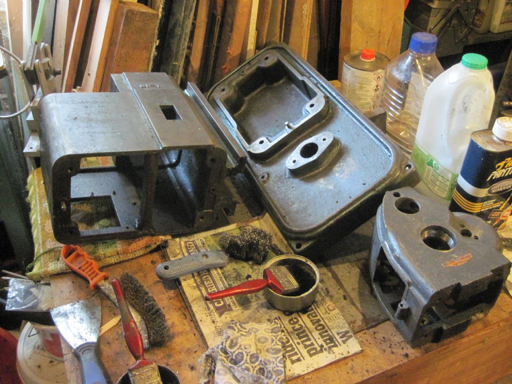

                                    IanT
                                      @iant
                                      Paint Panther mostly Steve. I also used Screwfix 'No Nonsense' paint stripper (easier/quicker to get locally when I ran out).
                                      Both worked but the Paint Panther seemed quicker on a purely subjective basis and possibly needed less coats to get right down to bare metal. The No Nonsense certainly worked but seemed slower – on the plus side it is about half the price though.
                                      I was very much a Nirtomors advocate at one time but it doesn't seem to be the same fomulation these days.
                                      A messy job but old machines tend to use good quality castngs – always nice to see.
                                      It's worth taking time to mask up carefully – just for the smaller detail here
                                      Brush painted but hard wearing. Painting over small masked parts makes life easier. Colour may be contentious but it only has to please me!
                                      But it does all take time….
                                      Regards,
                                      IanT

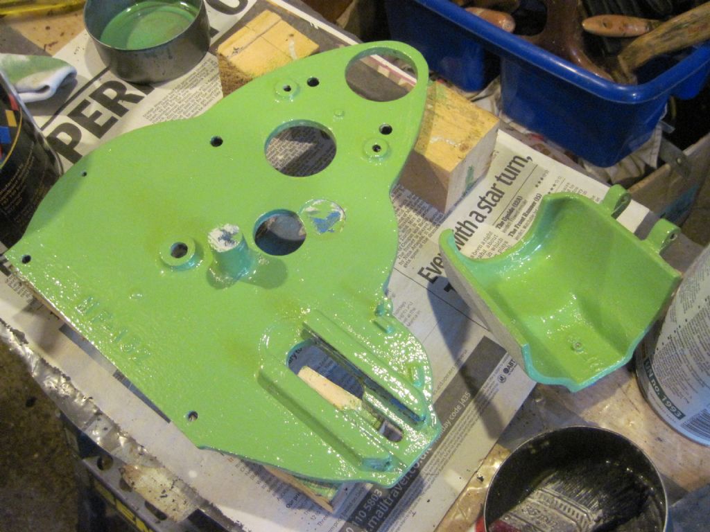

                                              Steve355
                                                @steve355
                                                here was my DW mill masked up…
                                                and finished…..
                                                was definitely worth the trouble.
                                                Anyway, paint ordered now, decision made 😁

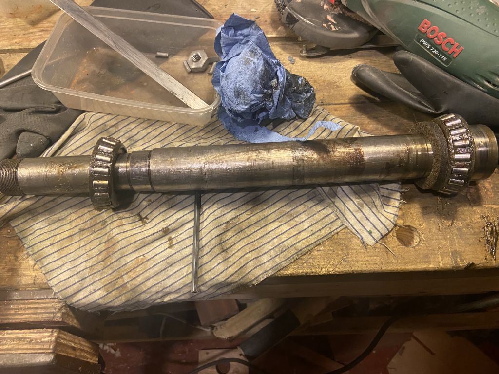

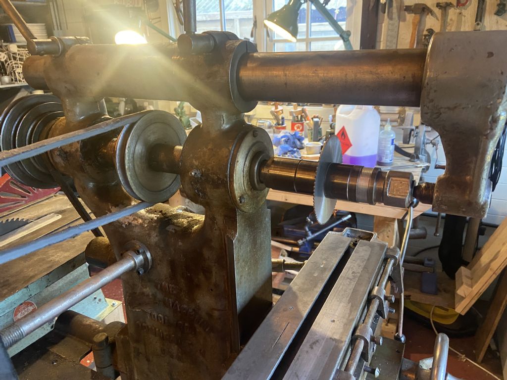

                                                  On another refurb topic, any thoughts about getting this spindle out? I’ve removed all bolts I can see, bearings at both ends are visible. I can’t see any more retaining fixings. Tap it gently from the back?
                                                  #575440
                                                  DiogenesII
                                                    @diogenesii
                                                    Yes, I think so – try it gently – it's been a long time..
                                                    BUT first ensure the pulley is free to slide so that the spindle will come out – it'll be a pain if it's seized on the key/spindle and you have to 'persuade' it off with everything else moving about..
                                                    I goes without saying to take great care not to damage the bearings & seals which might be eye-watering to replace, but do also be attentive to those areas of the spindle that runs in the seals, take care not to accidentally mark it on the main casting as it comes out, and be aware of any shims that might be fitted – unless you really NEED to, I'd keep any disassembly to a bare minimum, and record the relative positions of any- & every- thing that comes out – I can't recall exactly what is in there.. ..big T/R bearings with felt rings, IIRC.
                                                    If the felts look tired, new square section band is still available, I think.
                                                    Best wishes!
                                                    #575444
                                                    Steve355
                                                      @steve355
                                                      Posted by DiogenesII on 14/12/2021 18:38:06:
                                                      Best wishes!
                                                      well its out!
