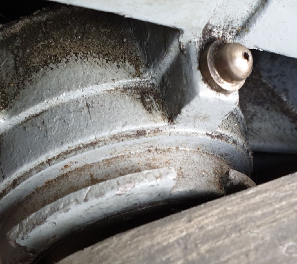

      I have a Kennedy hacksaw with original Hoover motor. The bearings have lubrication points as in the photo. Up till now Ive only had oil cups on my machines, what do I need to apply lubricant to these nipples?
      Firstly are they for oil, or for grease?
      Secondly what tool do I look for, preferably vintage to apply the lubricant?

            Clive Foster
              @clivefoster55965
              That is an old style low pressure grease gun fitting.
              Needs a simple tubular "push on the end" style grease gun. Often supplied for use with motorcycles of the 1930 – 1960 (ish) era.
              Mine is about 1 1/4" diameter by 6" long. Main body in brass with a zinc alloy screw on nozzle. I also have a larger one of the same type maybe 2" by 10" with a push handle on a stem but thats not really the right gun although the end is the same.
              Could dig them out for pictures if of interest.
              Sealing on the fitting can be a problem. Common way is to put a piece of clean cloth over the nipple and push the grease through it.
              Modern push type oil guns may also fit.

              Dave Halford
                @davehalford22513
                I believe oil
                Webb's push lawnmowers from the 60's came with a concave ended plunger type oiler that looks like a grease gun.
                You might get one at a car boot.
                Seeing Clives post the only way to be sure of which type is to take the motor end cap off.

                  Chris V
                    @chrisv
                    Thank you all, and there was me yet again thinking wrongly it would be a simple answer! (-:
                    Clive yes please I would certainly be interested in seeing some photos. Thanks for the how to do it tip also.
                    I will get it rewired and consider whether to take apart or use it as is for now, possibly/hopefully someone who owns a Kennedy saw might actually know for sure…..

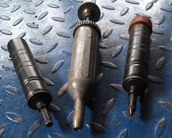

                    Clive Foster
                      @clivefoster55965
                      If you are not sure which type of gun you have the test is simple :-
                      Grease guns generally have the push plunger on the top end and always leak when filled with oil. It pretty much runs straight out making a big mess.
                      Oil guns frequently have a sliding nozzle assembly which moves back into the body as the oil is dispensed. They usually leak when filled with oil. Slow flow though so usually a smaller mess. Storing nose up can help.
                      Allegedly the expensive Wanner breed of oil guns, now sold to use with Myfords, and similar are better than older varieties. Various claims for superior seals. But I'm not going to hold my breath.
                      Clive

                        Clive Foster
                          @clivefoster55965
                          Chris
                          Can't find my push type grease gun of the first type mentioned, annoying as its a good pre-war one I've been looking after for almost half a century but here are the other push guns I have.
                          Middle one is a grease gun with hollow end which probably matches your fitting.
                          The other two are oil guns one with male cone end and one with a female cone. The nozzle ends push up into the body to drive the oil in. Those ones leak in storage!

                                    Andrew Moyes 1
                                      @andrewmoyes1
                                      Hi Chris. Having just stripped down the 1/6hp Hoover motor on my Kennedy hacksaw, I can confirm they are definitely ball bearings and it should be grease not oil. The bearings are shielded on their inner sides (to protect from dirt and retain the grease) but open on the outer sides so they can be regreased.
                                      I have replaced the bearings in mine and tried to obtain bearings with a single shield but without luck. The original bearings are 6203-Z. I think the suffix Z means one shield and ZZ or 2Z means two shields. Although I carefully ordered suffix Z, they came with two shields. Rather than trying to prise out one shield, I decided to fit them as they were so it is now a 'lubricated for life' motor, a nice euphemism meaning they can't be regreased. They will see me out.
