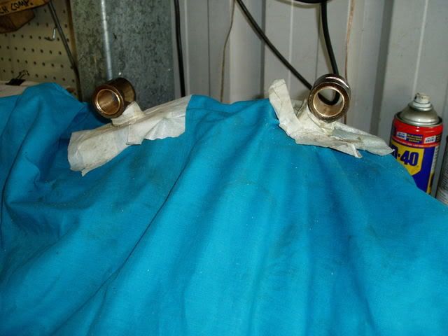

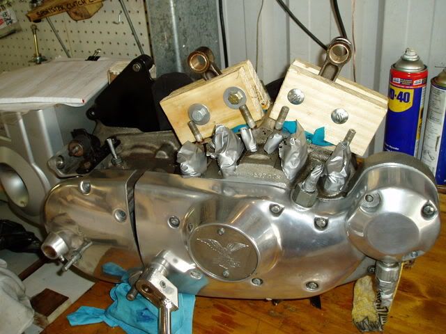

                    I've been doing this same job for years on Harley engines. I usually use an adjustable reamer. I hold the rod still by clamping it with two pieces of wood about 3/4" thick and 3" x 4" or so with two bolts through them so one each side of the rod and sit the the wood on the crankcase mouth and do up the bolts. With the rod held firm like this you can incrementally ream out the bushing. Reamer will usually follow the hole so it ends up square to the rod. Take multiple light cuts. Ream until the gudgeon pin is just a light push fit through the bush by thumb pressure. If in doubt make it a bit loose so it will not seize in operation. As Mr Harley said to Mr Davidson, a little extra clearance never got in the way.
                    Can check alignment afterwards by putting two pieces of 5/8" square key steel across the crankcase mouth and put the gudgeon pin in place and check it touches both sides.
                    I would not try to remove three thou with a brake hone etc as the hole could end up bellmouthed etc as that is a lot of metal to remove with a hone. And the piece of sandpaper flapping around works for small bore master cylinders on bikes where the rubber seal will take up any irregularity but is not suited to this job at all.
                    I sometimes finish off the last couple of tenths of a thou with a brake cyl hone just to give a good finish but definitely not much more than that.

                                    Thanks for advice Hopper,
                                    all done now, as per your photos and pin is a nice sliding push fit.
                                    Mike.
