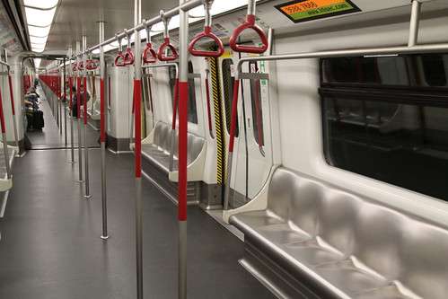

      My son has just sent a couple of snapshots of the seating on this super-efficient transport system:
      [ I will try to upload them later, the forum is refusing ]
      Does anyone here know how they are made ?
      Traditional press-tooling would be awesomely difficult, so I guess they might be hydro-formed.

        If you mean the standard MTR seats, about six in a row with a moulded “bum bucket” for each passenger, it would be a pretty simple piece of press work, speaking as an ex-apprentice from the car body stamping die toolroom.  Might be a multi-stage pressing with the basic shape done first, then a trim die to cut the edges to size then a third to roll that front edge over. Quite simple compared with say the floor pan of a large car, or a station wagon roof etc.

          Thanks, Hopper … Yes, those are the seats in question
          My curiosity was aroused by their use of Stainless Steel … which I presume would add some level of difficulty to the process.
          Perhaps I have simply not kept pace with modern materials.

              I dont remember if they are stainless or aluminium for light weight? But could be a ductile grade of stainless made for that purpose. They probably use the same sort of stainless that kitchen sinks and the like are made from. Those would acutally be a more difficult pressing with the sink cavity being a fairly deep draw with straight sides, very prone to tearing the sheet metal during pressing if not set up just so. The MTR seats could probably done in a more standard form die, probably with the seats rotated 45 degrees from the way they are used so the pressing is a long V profile with the bum and back shapes formed either side. Could even be pressed as individual one seaters and then six are welded together and the welds ground down. That would keep tooling and press size to a minimum.
