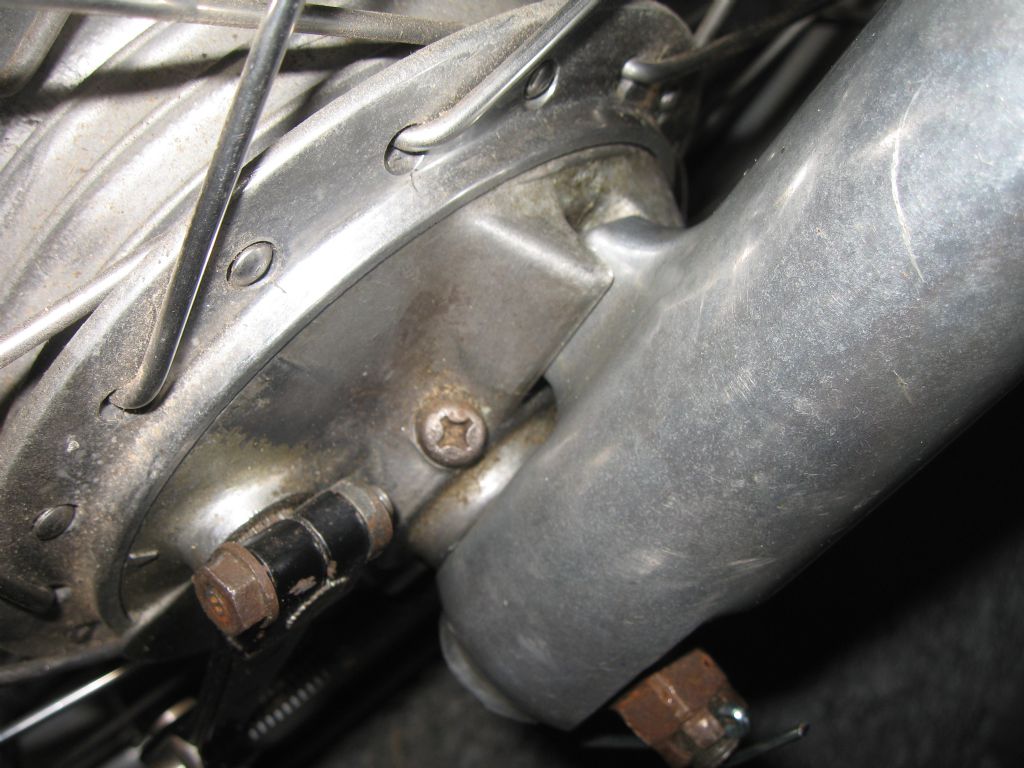

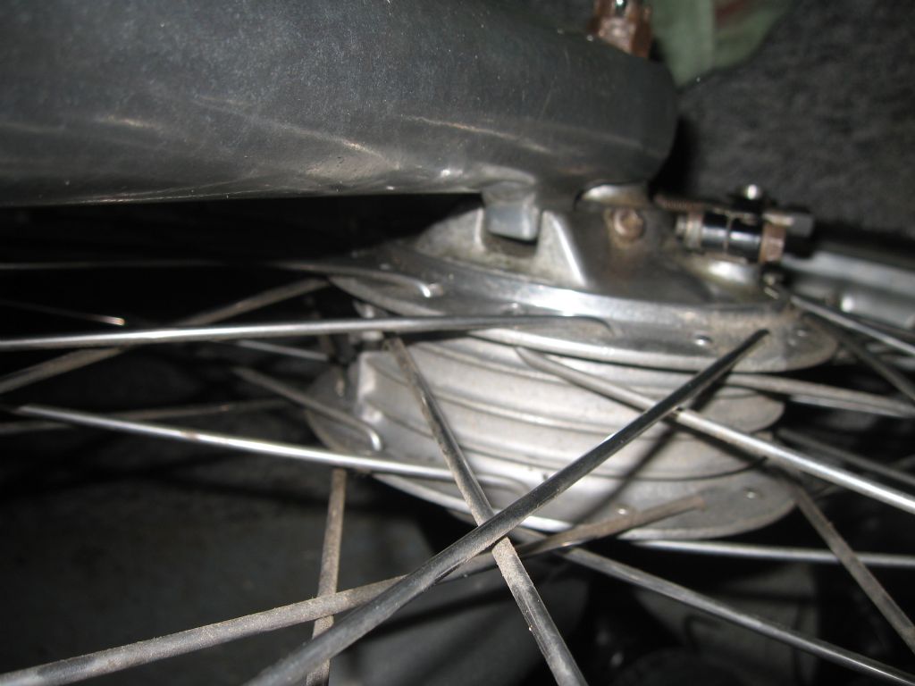

      The outer cable at the handlebar end is correctly engaged. It looks 'off square' because it is being pulled sideways as it is shorter than required. The inner cable terminations connect up with the brake lever and the hub as expected. If the inner & outer were just 100mm longer respectively, it would be prefect.
      The brake drum lever is installed as per the pictorial references I have. Thanks to the Grindstone Cowboy for his link, these pictures are very reassuring.
      With respect to installing the brake hub itself incorrectly – the brake lever side has a cast U shaped feature that locates with a spigot on the inside of the 'nearside' fork leg. So there is only one way it can be assembled. It is also the reaction point for the torque when braking.

            My money from the one photo is that the backplate is not located correctly in the fork. yes, I agree with others who have said this. Leave it wrong and the brake may not work properly at all, or the plate may rotate, destroying itself, the cable, and the speedo cable (which should also be checked – if this seems too short then my suggestion is really the problem.)

                Looking at pictures on Google images of other SL125’s the brake plate is in the correct position ,compared to BSA’s it does look wrong.

                  I am sure I have the Brake Hub is correctly located – although I am happy to be corrected on this.
                  Please see photos below.

                      A photo is worth 1000 guesses. So, we are left with a cable that might be wrongly routed, or non-standard control lever assemblies, or wider than standard handlebars, or forks fitted too low in the yokes, or the wrong fork tubes (too long – any of which might have been a mistake by a previous owner). Fork tubes are the most likely replacements after an accident caused by eg brakes not working.
                      Do you know of another similar model in your area, to compare with?
                      And do please check, because any change in the wheel position will affect the steering, as well as the fit of the cables.
                      Honda used the same or very similar forks and brake drums on a wide range of models, go-to-work road bikes, trail bikes, motocross machines, etc, and a wander round a second-hand bike showrom could well produce similar models with cables just that bit longer – then you know what to ask for. And it is not difficult for an experienced mechanic to make up a cable to whatever length as a last resort. Just make sure that you get the result properly tested so the nipples don't pull off.
