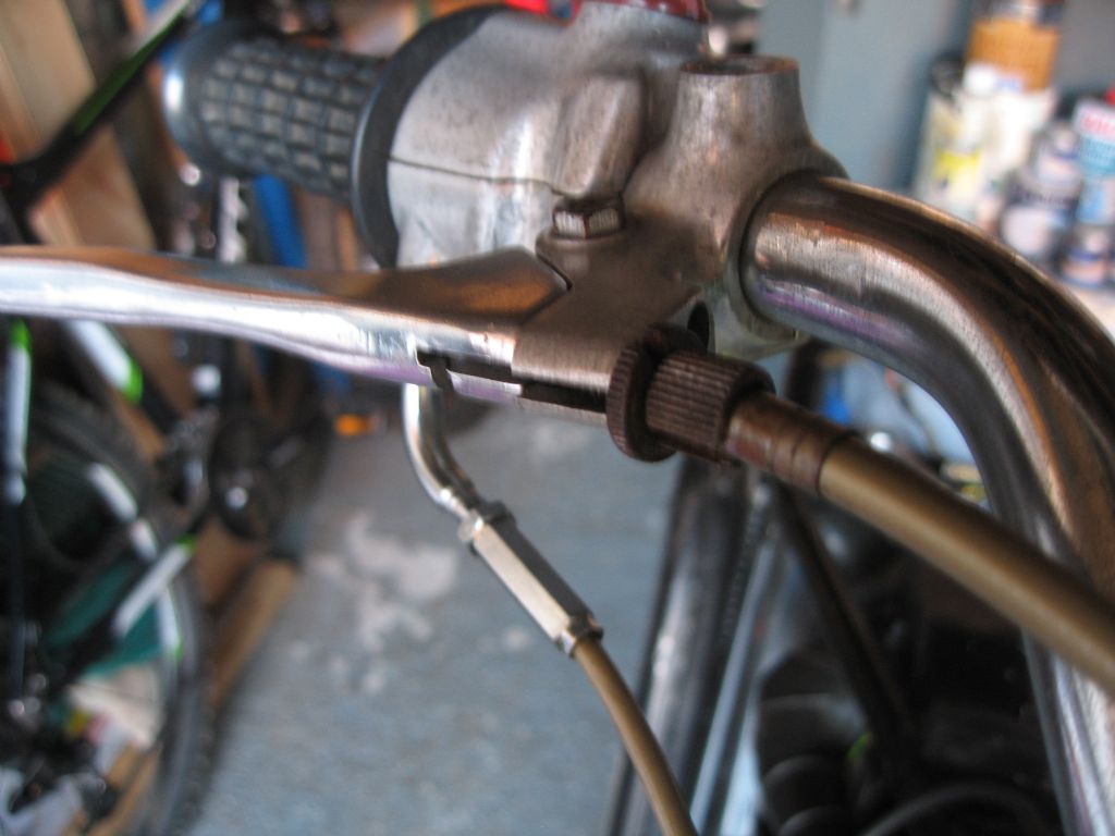

        Hello all.
        This is a long shot – but I know many of you will have an interest in ALL things mechanical, so I hope it is acceptable to post this query here.
        I am currently rebuilding a Honda SL125s registered in 1975. This was purchased as 5 boxes of bits – not a built bike. Even the engine was stripped down to its component parts.
        The front brake cable has now been fitted and has been found to be too short (as can be seen by the taut outer cable in the photographs). A returned purchase (even shorter than current unit) and subsequent investigation has shown that the correct length brake cable appears to be unavailable – although there are plenty of allegedly correct cables from most suppliers. All being too short. The current fit has an outer sheath of 1120mm long, and inner cable with all attachments of approx 1250 long. I believe that I need an extra 100mm on both of those lengths for it to be a 'comfortable' fit.
        My question is – has anyone out there had a similar problem with this bike, and did they manage to find a suitable alternative brake cable. If 'yes', do that know what the cable came from and better still a Part No. for it.
        I did say it was a long shot …………. but nothing ventured, nothing gained.
        The photos below show the end fittings.
        Well ……… fingers crossed!
        Best regards to all.
        Alan.

            Are the bars stock?
            If so try a CB175 cable, alleged to be 53"

                      #447390
                      Brian Sweeting 2
                        @briansweeting2
                        A couple of thoughts…
                        1. Are the fork legs correctly fitted in the yokes?
                        2. Have the handlebars been fitted with risers?

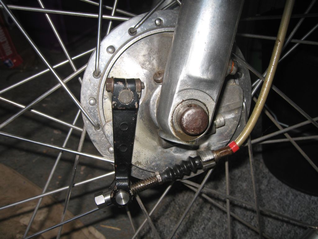

                                Lever on brakeplate looks to be splined to shoe shaft? Have you got the lever on the correct spline position.??

                                  May sound silly ! But is the brake back plate in the correct position ? Rotating it anti clockwise would give you a better cable run? Noel.

                                              Is the outer cable fitted correctly into the adjuster on the handlebar lever?
                                              It is hard to tell , but in the photo it seems that it might be sitting proud of the adjuster ring.

                                                I think his main problem is the length of the outer cable is short by severeal inches, causing the sharp bend at the bottom instead of the normal sweeping curve.

                                                    Have you got the brake plate in the correct position, i tried to zoom in on your picture.

                                                      Ian beat me to it. You should be looking to have the cable at 90% to the lever on the drum as the brake shoes bite onto the drum to get the maximum mechanical advantage.
