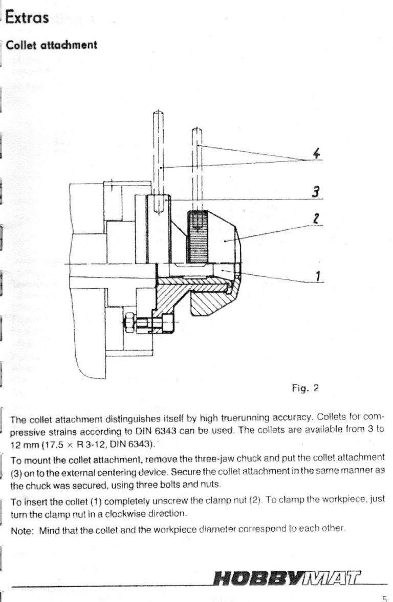

            Hi Paul, this is all there is in the user manual that I have, if it's any help.

                As Nick says, they are DIN 6343 collets, size 125E (or F17).
                The parallel portion that locates the collet at the back is 17.5mm dia.
                The major diameter at the fat end of the taper is 22mm.
                The taper half-angle is 15 degrees.
                Overall length is 51mm
                Looks like Santool in Germany still sell them in 0.5mm increments from 1-14mm at about Euro 20 each;
                Santool online shop – Collet Type 125E, F17, DIN6343
                Beaten to it by John..

                  Many thanks Gentalman ,now i know the collet type and its No just acase of chasing em down , Many thanks for the drwg ,Nick .I have the chuck and have just made a couple O tommy bars for it ,But still hunting down the actual collets!. Regards & keep Whu-Flu free Paul S
