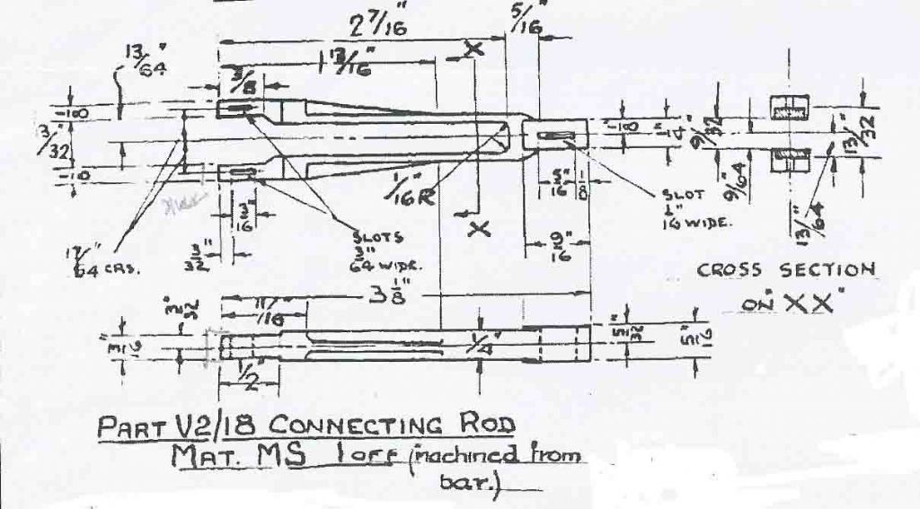

      I am currently building the above engine from Hemingway Kits, having completed a Stuart 10V, a Mount Cross Engine, A Vulcan Beam Engine and part completed a Sir William Pumping engine. This time I fear I may have bitten off more than I can chew.
      I have now got to the stage of making the connecting rod and have no idea how to proceed. In particular the 3/64'' slots for the bearing strap cotter pins seem impossible.
      Having followed the Stuart Victoria thread I wonder if I could crave some of the same advice.
      Thanks
      Peter

          Hi Peter,
          For Norden I had to make similar slots 1/16" wide. That extra 1/64" seems a lot!
          The slots will be hidden so they don't need to be perfect, although the end the key bears against needs to be correctly placed.
          After I finished my engine someone suggested drilling axially down from the curved surface for the bearing. This can remove a significant proportion of the metal the slot has to cross, and at the centre, the hardest part to reach.
          Now chain drill the slot with a 3/64" drill as accurately as you can. It may be worth drilling from each side in turn rather than trying to do so in one go.
          Now cross your fingers and using a 1mm end mill as fast as it will go and taking cuts of no more than 0.4mm or less gently remove the metal between the chain drilled holes.
          If you are lucky the tip of a flat but pointed (does that make sense?) diamond file will enter the slot and let you tidy it up.
          An alternative rout would be to make a chisel from gauge plate or silver steel with a short tip 3/64" thick and 3/32" broad. Bevel it so the cutting edge is at one, narrow end. A second with the cutting edge on a long side could be useful.
          You can either use this by hand to chip away between the drill holes or, if made on the end of a silver steel rod, you may be able to use in the mill with a gentle up down planing action.
          Final thought, as 1mm end mills snap very easily, an alternative would be to file a d-bit shape on the end of 3/64" silver steel, just for about 3mm. Make one at each end of the rod so you have a spare immediately to hand. This will be slower, but if carefully tempered will probably outlast and end mill (which will probably be far too long in the fluted section, and therefore too fragile).
          P.S. I'm sure someone else will suggest spark erosion, and that's probably the best solution of all, but requires making a whole new machine.

            Peter, take a look as Jo's thread on her S&P she has posted about wedge and cotter slots several times.
            I tend to drill out as much as possible, mill and then file with ground down needle files, these are all 1/16" wide.
            As for how to generally proceed with making the conrod I would take an overlength bit of 3/4×5/16 bar,  clamp it to the mill table and machine it to the profile, you would have to flip it over at the end to do the other side of the outer webs and then finally mill or file them to the tapered shape, something like I did here

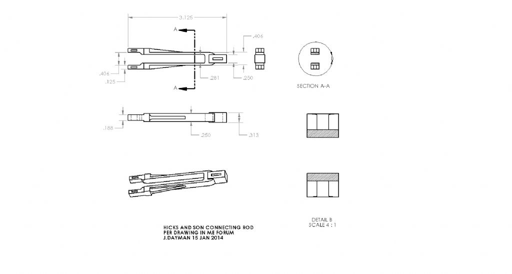

                Peter, something did not look right about the section XX view. I sketched up the rod in Solidworks and a jpeg of the drawing is as shown. The cross section hatched area should reach to each side, unlike the section on the hand drawn view as section XX. I don't think the height proportion on section XX is correct either. Hope the correct section AA view helps. JDhicks-conrod.jpg

                  Thank you for all your advice. I had previously made similar slots of 1/16'' width by chain drilling and then carefully milling with a 1/16'' slot drill. With a lot of patience a reasonable result could be obtained without breaking too many mills. However as Neil notes in his first sentence, going down to 3/64'' seems a step too far.
                  In addition I had not been able to find any mills under 1/16'' at my usual sources.
                  I like the idea of making a d-bit out of silver steel and so I will get some at Ally Pally tomorrow, along with a stock of 3/64 drills!! Then I will practice on some scrap. Having put a lot of effort into shaping the con rod I don't want to start experimenting on it.
                  The other problem I foresaw which you have identified was that of filing the slots to shape after drilling / milling. The tip of my precious Swiss files would just fit into a 1/16th slot but certainly not 3/64''. I never thought of grinding them down. to fit! I think I will have to invest in anew set also tomorrow.
                  Looking at Jasons pictures it occurred to me that i might modify the ends of the con rod forks to receive circular bearing shells. I dread making split bearings in which one half is square and the other round and at this size the problems would be even greater. I know it is not strictly correct but I am not planning to enter any competitions. These are just memento for the grand children.
                  Finally thanks for correcting the drawing Jeff. I will have to explore Solidworks. looks a useful tool.

                                                    Success. I have just made a perfect trial slot in about 15 mins.
                                                    I adopted Jo's approach. I chain drilled a series of 3/64'' holes and then joined them using a piercing saw. I then swapped the blade for a larger size, more like a fretsaw and opened the slot until I could just fit one of the tiny files I bought at Ally Pally. Five minutes careful filing and I had a perfectly rectangular slot.
                                                    No setting up the mill with a tiny cutter and no stress as I waited for it to break.
                                                    Suddenly that con rod does not look half as intimidating.
                                                    Thanks for all the suggestions.
