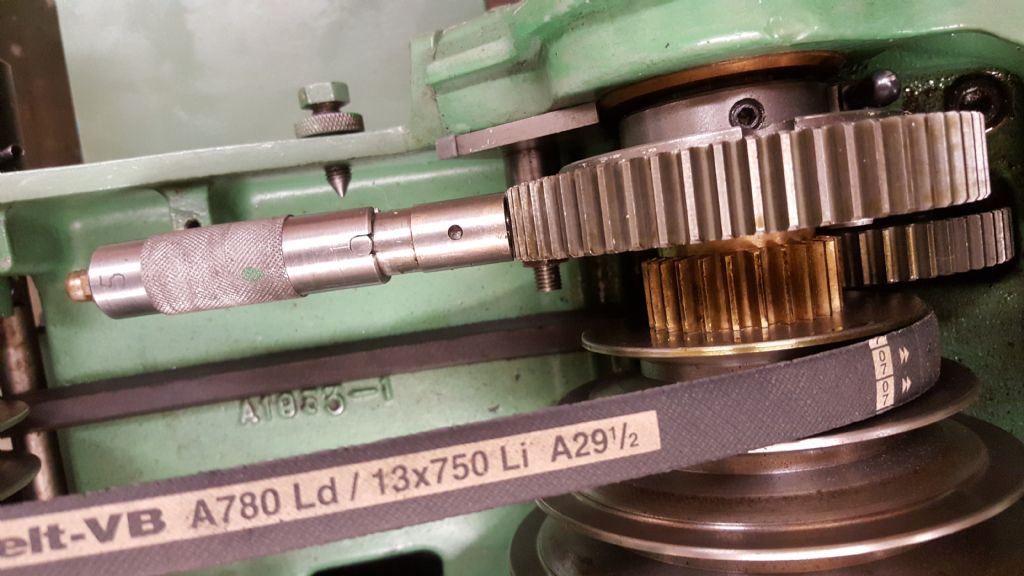

                                      Hi All, Just to keep you up to speed I am now the proud owner of a Myford Super Seven including all the accessories I will probably ever need. I have not yet used it anger as I am still studying the manuals and learning about the machine. I do have a couple of questions though. There is a 3 stage tensioned lever that is directly above the bull cog that when activated appears to lock the bull cog, there is no mention of this in the manuals, there is a small bracket next to the oil port at the front of the machine with a hole and alignment groove in it once again no mention of it in the literature and thirdly there are two small adjustable pointed screws, I think these are socket set screws on the counter shaft arm, what is the purpose of these? I will try to attach photos to illustrate, the photo below shows the lever and one of the pointed screws the other screw is directly opposite on the other side out of shot. 20211128_191053.jpg

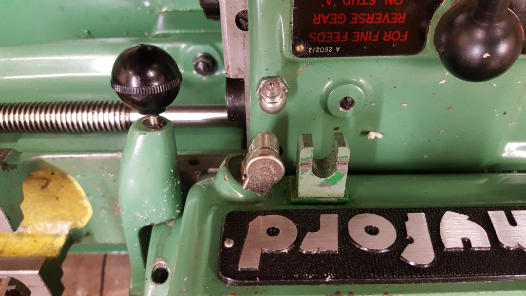

                                        Hi All again further to my last post the photo below shows the bracket on the front of the lathe (sorry its upside down) any ideas anybody20211128_191100.jpg

                                          The plunger that engages with the bull-wheel is not a Myford component or accessory, it is a dividing attachment that someone has made and fitted. Because the S7 has a 60 tooth bull-wheel it can be used to index 2, 3, 4, 5, 6, 10, 12, 15, 20, 30 and 60 divisions. This would be used with, say, a tool-post mounted drilling spindle or graduating attachment. You will find it very useful once you become more experienced with your lathe.
                                          The two pointed screws on the counter-shaft are again not a standard Myford fitting. They have been fitted by someone to hold the Radford or George Thomas head-stock dividing attachment as is the small bracket above the gear-box. These additional components are identical to those on my own lathe which I fitted myself. The Radford/Thomas dividing attachment allow you to index the spindle through any number of divisions or degrees of arc and is very worthwhile accessory to make and use. I use mine mostly in conjunction with the Radford graduating attachment but is can be used for many operations that require accurate divisions.
                                          You could do no better than to acquire a copy of George Thomas' Workshop Manual which will explain all this to you. It is not rocket science so don't be discouraged, if I can do it a mentally retarded chimpanzee can do it! Originally, I think, George Thomas published three books: one the Workshop Manual, one on Dividing and Graduating and another on building his Universal Pillar Tool. I believe that later all three books were condensed into a single expanded workshop manual, so check before you buy a used copy as to which edition you are getting. I think that the Manual is available from TEE Publishing and it is worth every single penny to the amateur craftsman, IMO.

                                            I would say it's an alternative design to Harold Hall's, bull wheel indexer.
                                            This link will give you the general idea.
                                            http://www.homews.co.uk/page541.html

                                              Might I just add that, if the previous owned has not already done it, it is worthwhile coding the available divisions on the face of the bull-wheel with coloured dots with enamel paint or coloured permanent marker pen. This saves counting the teeth when using the bull-wheel as an index.
                                              I can't remember off the top of my head the colours I have used, they were listed on a note-pad in the workshop, but it goes something like this: blue dot at tooth 1 and 30 for two divisions, red dot at tooth 1, 20 & 40 for three divisions all the way round to maybe a yellow dot at tooth 1,3,6, 9,12,15,18,21,24,27,30,33,36,39,42,45,48,51,54,57,(60 or 1 again) for twenty divisions, I am sure you get the idea and its actually the tooth spaces that are marked, not the teeth themselves as, obviously, the plunger engages in the spaces.

                                                  Hi Chris, yes the previous owner has indeed marked the cog as you have stated, in fact the whole mod has been so well done that I honestly thought it had been fitted in the factory.
