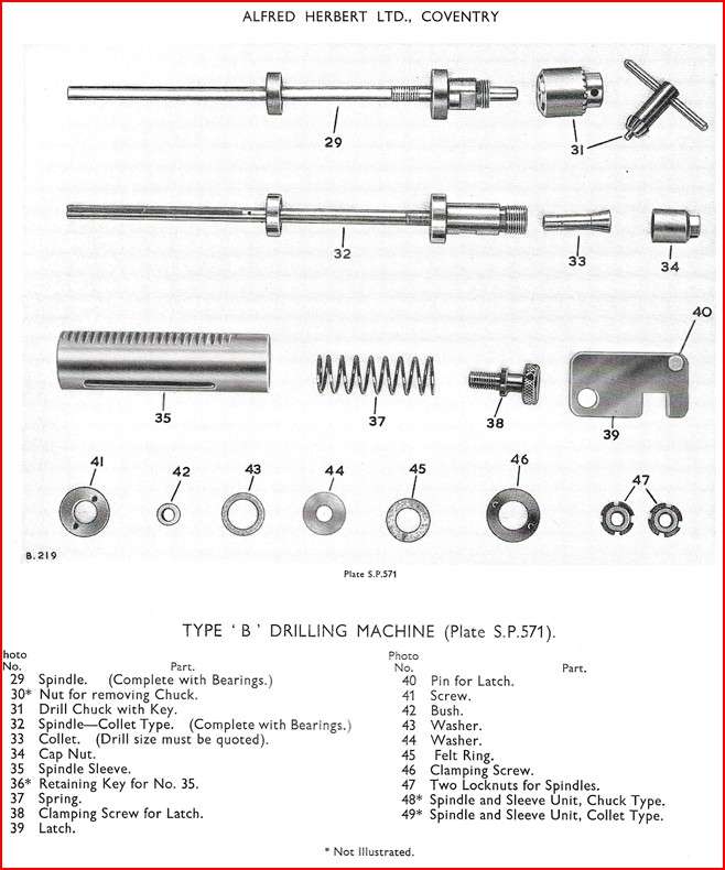

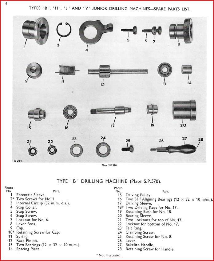

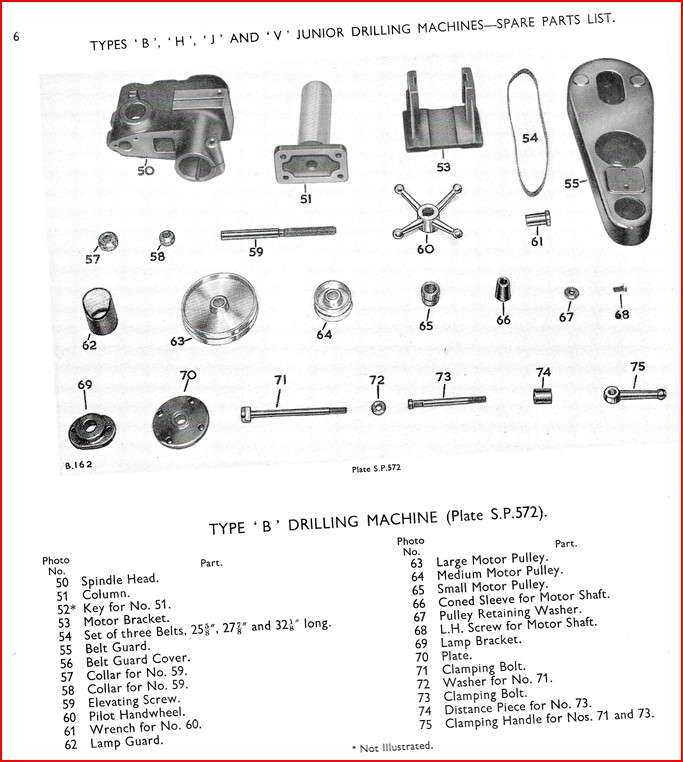

      Hello,
      Would anyone have a parts diagram for the above? A manual would be even better, but a parts diagram would help me reassemble a dismantled drill.
      Thanks in advance,
      Andrew.

        Hi Andrew, here are the parts sheets for the B.  Hope they are of use. But they will confuse you I’m sure, as they did me. Give me a shout if you have a problem and I will try to help as Im just reassembling one of these now.

              Thanks Michael, I think I have successfully created a gallery and have placed the pdfs in it. However for the completeness of the thread, and easier discussion, I’m inserting the pics also.
              H B p5H B p4H B p6

              I notice in the parts lists that the drill was available with a chucked spindle and collet spindle. Which do you have?

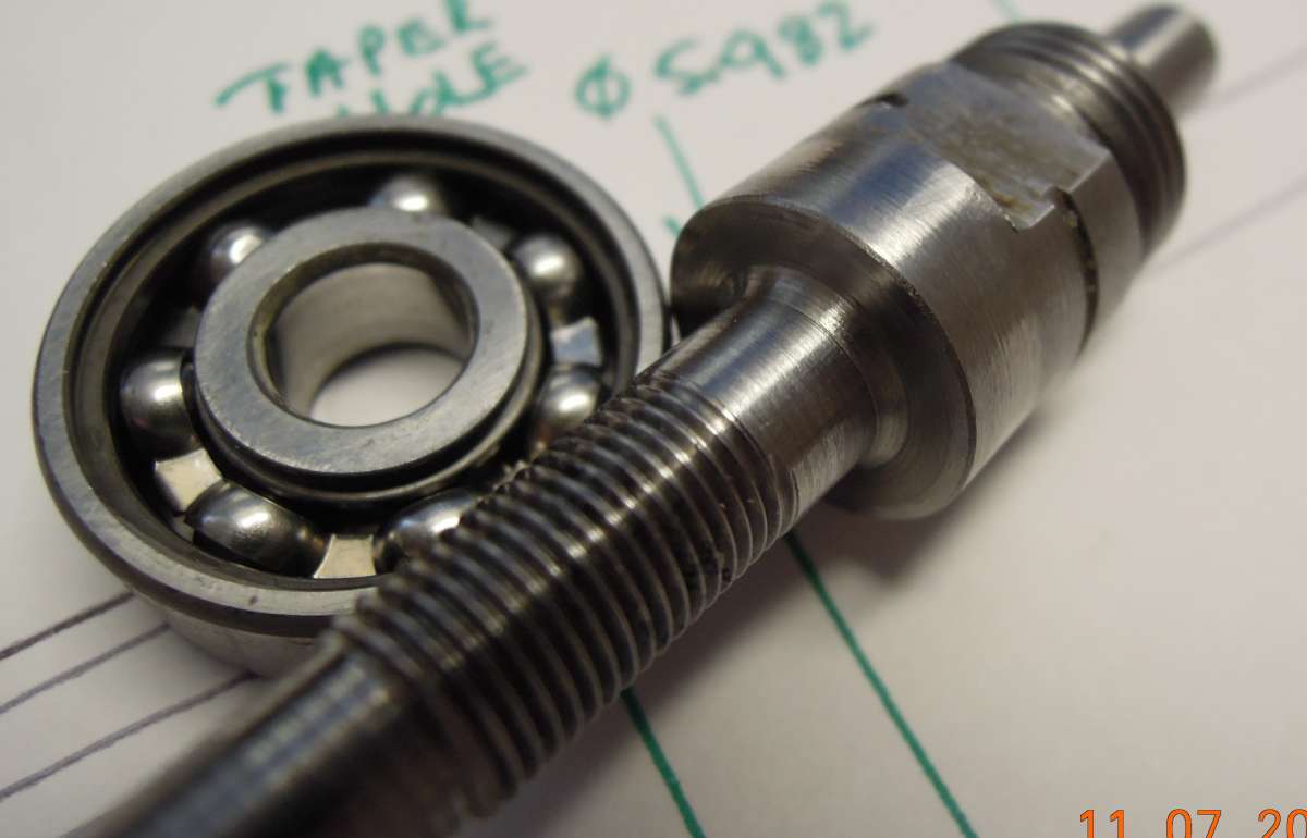

              I tend to measure up components in important areas to check the assembly quality and in case I need to make another. So if you are missing anything let me know as I may have the details. I did find that part 19 interfered with the bearings so had to machine it down to clear. I also re-installed plain single-row ball bearings in the spindle drive, instead of those self-aligning types which make no sense.
              Another mistake I discovered was on the spindle. The seating for the lower bearing contained a radius that was far too big. As soon as I saw it I knew it was too large, even before measuring it! I made this pic for illustration purposes ….
              DSCN1903
              DSCN1897
              Oversize radii cause bearings to distort and sit out of square. In a high speed application it would generate vibration too which is the last thing I want. I have therefore now sharpened up this shaft fillet to ensure the new bearing sits correctly.

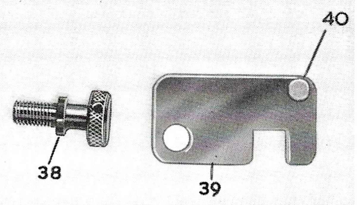

              One part my drill didn’t come with was part no. 39/40. I’m not even sure what this is for! Any thoughts?

                    I think that parts 38, 39 and 40 are made to lock the spindle while changing chucks or collets. Most people would simply use an open ended spanner.

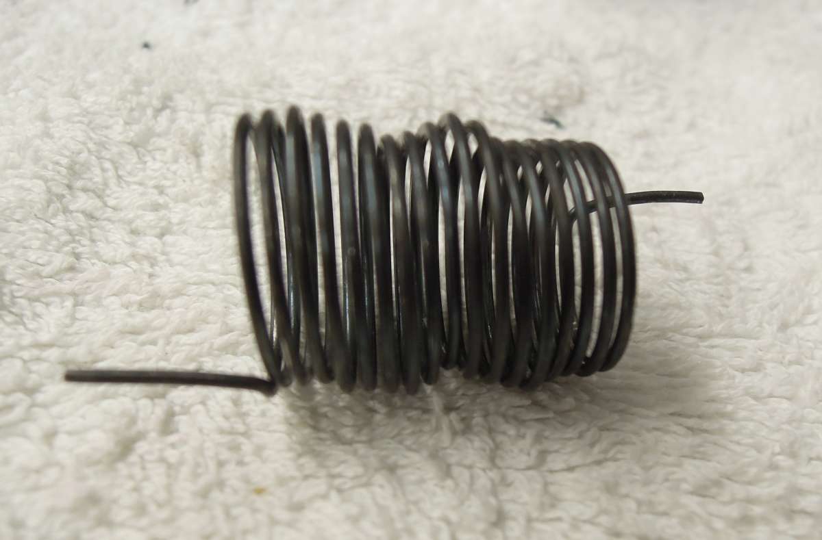

                      The handle balancing spring….
                      DSCN1944
                      This has a wire dia of almost exactly 1mm a coil pack length and dia of 24mm x 17.5 and protruding location pins of 10.7mm long.

                        Old Mart – spindle lock, yes that would make sense. There is a vacant hole in the base of the casting adjacent to the spindle. Thanks.
