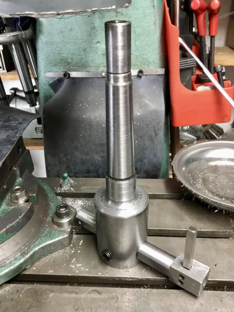

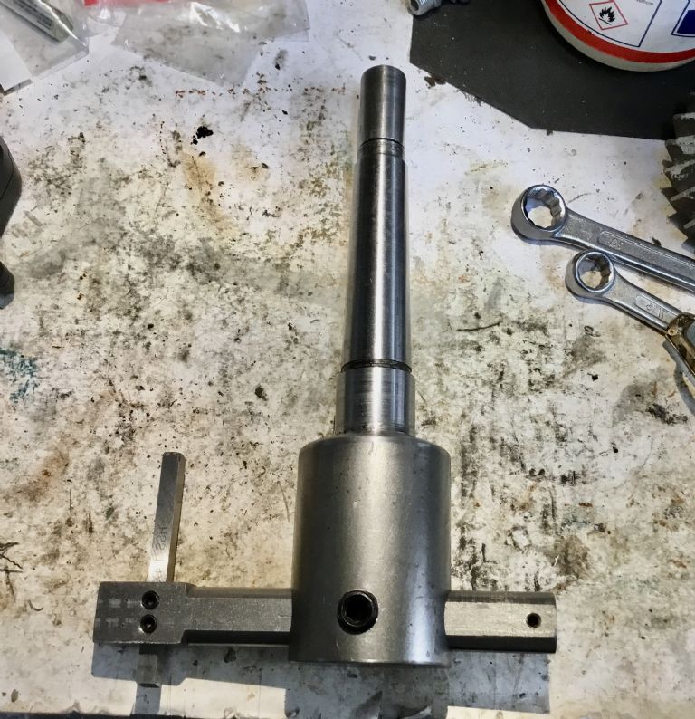

      My third Hemingway kit since doing their Drawbar and later the ‘simple’ knurling tool 2015:
      Hemingway flycutter
      The 3MT arbor was welded to the Body and with an extension piece screwed in it reached to Hemingway drawbar as do all the other tooling for the Marlow 3A.

            I had forgotten just how hard arc weld is as it soon blunted HSS so switched to TC and that produced a perfect finish.
            The screw in extension in place, and used on all of my other MT milling tools to bring them all the same height for the Hemingway draw bar to screw into.

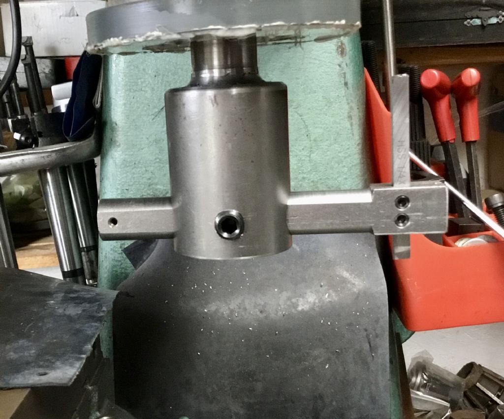

            Hemingway flycutter
            In place but needing the tool bit ground:

                      Hard to see but what is the shape of the cutter? It looks the wrong way round ie not deepest edge outwards.

                        It's just a part ground 1/4” toolbit I had, so any advice on cutter shape please, as I’ve never done one that’s at 90° to work.
                        Used the bit to produce the square hole.
                        Oh, after drilling 1/4” first devil

                          As far as cutter geometry is concerned it’s not really any different than facing on the lathe?🙂

                              The thing to remember or get your head around is that the device is moving sideways not downwards. So it is the outer edge of the tool that meets the material first. You might make that bottom outer corner a sharp but fragile one which will leave lot of little grooves on the surface corresponding to your feed rate, or round it off as with a late tool.
                              Now have a hard think about which where the clearance has to be, and the equivalent of top rake.. You might want to leave that for a cooler day

                                  I do have and used the normal angled flycutter, but will take your advice and experiment with tool edges.

                                      The hard weld blunted my tangential toolbit hence having to switch to TC.

                                        I've had the same problem with welds. And mine are so uneven that the interrupted cut chips the edge of the carbide.
