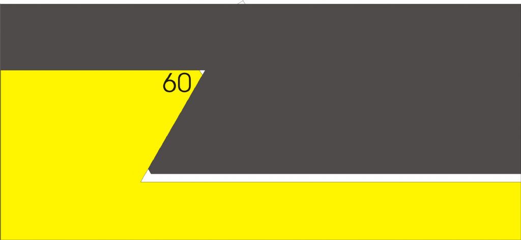

                Sub Mandrel
                  @submandrel
                  Hope you get that sorted OK. Take it gently with the cutters and they will last a long time. If they rub in the corners you can put a TINY amount of extra relief on the corners with a sharpening stone. This only means the inside corner of the dovetail will not bet 100% sharp. It is essential to take the sharp outside corners of dovetails off anyway(as any tiny interference completely spoils the fit) , so this makes no material difference.
                  Look at the pic below and note how the dovetail only contacts on one of the horizontal surfaces as well.
                  If you are fitting a gib strip, it should nearly fill the space available for it, and it should not have sharp edges fitting into the corners of the dovetail.
                  Edited By Stub Mandrel on 18/05/2013 11:11:36
                  #120148
                  Mark Webster
                    @markwebster13123
                    Thanks Neil, I will be using gibb strips. It's the first time of using these cutters so thanks for any advice. I have bought a set so am I better making my way through the range until the desired size is reached I.e. 10 mm then 16 mm then 32 mm or just doing it straight with the 32 mm after millining the centre out. It's obviously mild steel I'm cutting, I've opted for the softer bright mild steel the one with lead added
                    #120151
                    Sub Mandrel
                      @submandrel
                      Good choice of material, though good cast iron makes it a breeze.
                      Mill out the centre section square, then take progressive cuts the full depth with the cutter whose depth is the best fit. I normally do about three cuts, then take a final skim that is quite light (say 10 thou), if the starting slot is dead on size, aim to just remove any vertical witness with the final sizing cut.
                      Cut the dovetail which will be drilled for the gib screws first. The finish on this side is not critical as it doesn't slide on anything, so it makes an excellent opportunity for practice.
                      Another tip is to mill the dovetails before the outside surfaces are finished. The gib can be both adjusted in size and position to take up small errors, and then the outside surfaces skimmed to give neater joins than you would ever get by trying to get the dovetails exactly positioned.
                      If your mill is set up so you can take climb-milling cuts (where the mill is effectively pulling the work under the cutter) you may find a final, very light cut this way may give a better finish, but don't use the dovetail cutter to find out if your mill can do this. I suggest having a practice first anyway.
