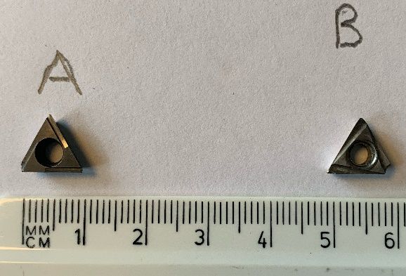

      The majority of my lathe tools are HSS so I don't have much experience with inserts.
      I do have two inserts which are in the photo below, mostly used on aluminium. As can be seen, they are damaged and I would like to replace them. The only problem is I can't identify them from among all the illustrations on the web.
      I would be grateful if somebody could identify them and also confirm that they are suitable for turning aluminium and free cutting steel.

          SUMITOMO (maybe) TPGT 0802 or 0902 or 1103 depending on the unchipped length and thickness
          Available from the usual place.
          Not cheap

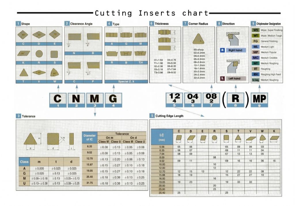

            I would venture to suggest that they are TNMG inserts. Possibly TCMG110404. You are best placed to measure the thickness and estimate or measure the rake and corner radius and apply the results to the following table:
            insert code chart
            Good luck!

              I have not seen the like of these either. However they look to have similar dimensions to the TCMT1102nn series of inserts. If it would help I could send you a sample insert that is designed for aluminium, tip definition – Aluminum Carbide Insert TCGT110204-AK–, to see if it would fit the insert bit bar that you have. While these inserts are designed for aluminium they will work on free cutting steels provided that one isn't too enthusiastic with the depth of cut or feed rate.
              If your interested then contact me via the PM system on this site and I will get one in the post.

                A = TBGT L and B = TBGT R as the chipbreaker is only on one side of each corner they are handed inserts, the B in the code may differ as can't see the angle from the photos.
                Having said that if you just wanthem for aluminium then the common TCGT 110204 would be fine for general use.

                  old mart
