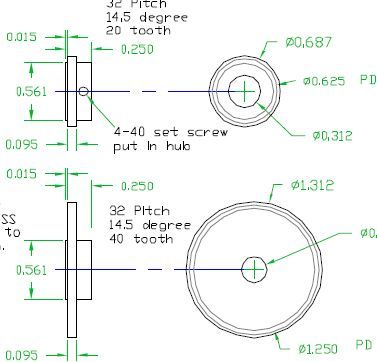

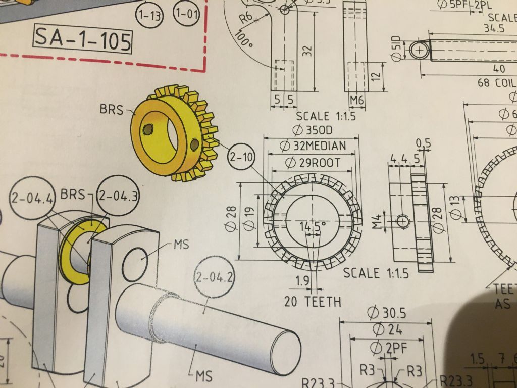

      Evening gents I’m looking over plans of an engine I’m planning to build in the future and unsure on the gears needed see pic, the plans are all in metric however the gears appear to be 16dp also the pressure angle is 14.5, for example the small gear od of 35mm which I think would be the blank size comes out at 1.59 module unavailable obviously or 16dp, can any one shed any light or am I reading it wrong if it is in dp weird that the gears all metric and annoyingly misses out the module or dp on the plan thanks Rich
      Engine

              Which of his engines is it, can you post a link to the plans
              One of the problems is he often scales up the original drawings and combine that with his CAD package not showing many decimal figures errors creep in. Ideally we need to know the gear centres but you may be lucky if that hit & miss engine mounts the cam gear on an eccentric stud as you will get some adjustment of the mesh. For example if the PCD or median of the smaller gear were shown to two decimal places it would be 31.75mm which makes 16DP the ideal size.
              Edited By JasonB on 08/01/2021 07:18:02
              #518361
                A bit of digging and his engine is a doubled up Kerzel with most sizes rounded to nearest whole mm .This engine used 32DP gears so 16DP would be the best option and locate the position for the regulator arm pivot by using the actual gears to get the spacing which should be in the region of 47.63mm not the 47 on the drawing. That's what you get when two separate diameters are rounded up but the single ctr to ctr rounded downangry!.
                You could also get away with pushing the position of the pivot out to 48mmPCD which would allow you to use cheapish off the shelf 1MOD gears from the likes of beltingonline at 32/64T or 1.5Mod at 21/42 would give PCD of 47.25mm
                Edited By JasonB on 08/01/2021 10:47:23

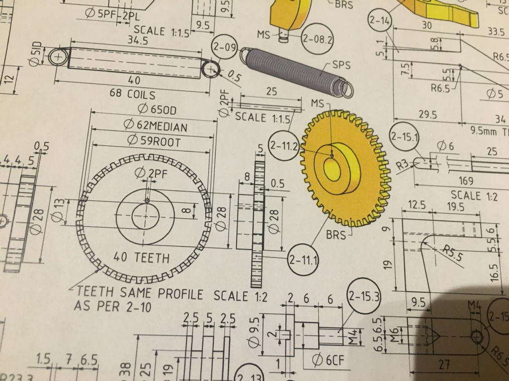

                Anonymous
                  Whoever "designed" this engine clearly knows nothing about gears. The teeth are simply isoceles trapezoids and the included angle is incorrect for the assumed pressure angle. It's half what it should be. As drawn the addendum and dedendum are the same, which is incorrect. There's no clearance allowed. sad
                  There are two choices. One tweak the position of the gears to enable use of a standard DP or Mod value as described by Jason above. Two, stick with the "median" values as shown (treat them as pitch circle diameters) and make special cutters for whatever the value of DP or Mod comes out as. Jason illustrated some simple flycutters with circular profiles for cutting gears in another recent thread. That should be fine in this application. The choice depends upon whether the OP wants to make, or buy, the gears.
                  Andrew

                          yes you are correct jason not had chance to reply at work, I looked into the metric version which is x2 as he easier for me working in metric,

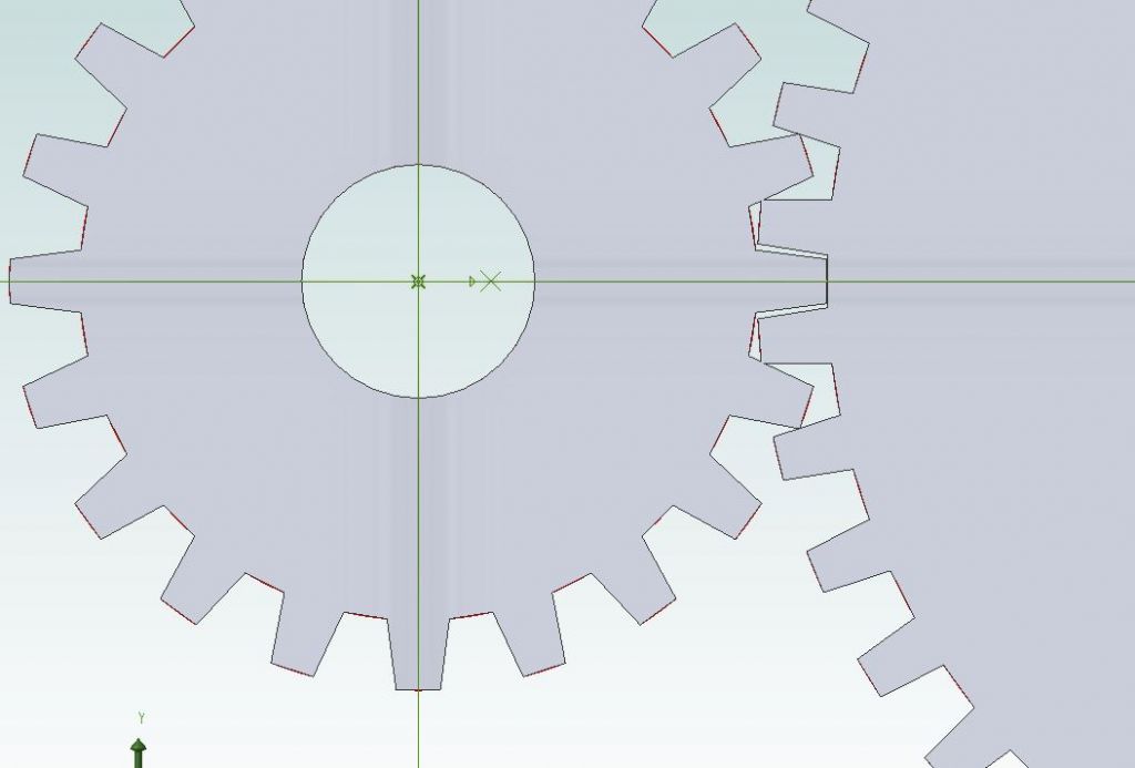

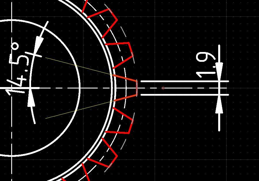

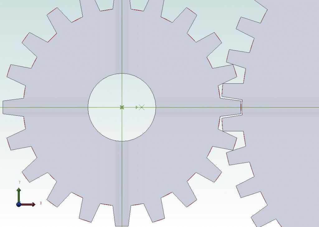

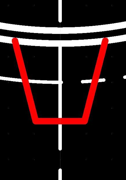

                              I agree with Andrew in that the teeth are simple trapezoids, not cycloidal or involute curves. But it may be deliberate rather than bad design. In the good old days millwrights and early engine makers didn't understand the maths behind gear shapes so it was common practice to approximate a shape and let the teeth grind themselves in. It's not a good system; at first the teeth are too tight and have to be filed to run at all, then they run inefficiently with much friction and wear out quickly. But it works and crude straight teeth are easy to make with a file. No need to worry about module, DP and gear cutting – the builder just needs to follow the plan, produce a bodged gear, and then fettle the teeth to mesh approximately.
                              Zooming in on the drawing shows all the information is there; I've redrawn it for emphasis.
                              The shape:
                              With dimensions, 14.5° each side, 29° in total:
                              This last image shows how yuk the initial mesh is, and it's obvious the teeth will quickly wear to a more sensible shape at the top.
                              Nice job for a 3D printer. Easy to knock a couple of gears as per drawing and test them.
                              Edited By SillyOldDuffer on 08/01/2021 13:35:26

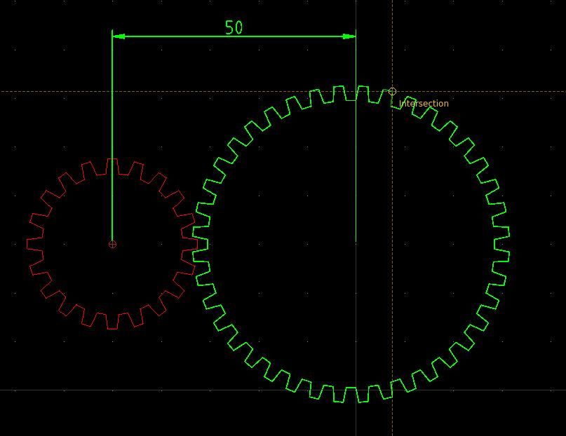

                                More likely just down to the limitations of the CAD package used. In the days of pen and pencil and basic CAD you would probably have just got 3 circles much like the original Kerzel drawing. Julius has tried to represent a gear no doubt by drawing a single approximation to a tooth and then doing a circular pattern ( done it myself in the past). Now I'd use a Script in Alibre or FMGears in F360 to get a proper representation with the rounded gear faces..
                                Same with threads, couple of lines has done us for many years, Alibre now gives me the option of "textured threads" on drawings or I can slow the whole 'puter up by doing a helical cut to make the part actually look threaded.
                                One other comment on the gears it does not really matter if you use 14.5 or 20PA so long as both gears are the same so that may open up your choice of bought cutters. 14.5PA will look a bit more like old gears.
                                Edited By JasonB on 08/01/2021 13:55:25
                                #518423
                                Anonymous
                                  Posted by SillyOldDuffer on 08/01/2021 13:34:59:
                                  With dimensions, 14.5° each side, 29° in total……
                                  Indeed, but that's not what was orginally drawn. The angle dimensioned is the included angle, not the correct half angle.
                                  Andrew

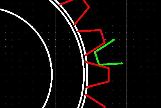

                                      The construction is all a bit hit and miss with them, that's why I suggested spacing the gears on the actual job.wink 2
                                      As you say the lack of clearance at the bottom of the cuts will clash and there is also a bit of corner rubbing when actually drawn out to what's on JDW's drawing.
                                      If cogs gears were set with a bit of paper between or set out at 47.15 mm rather than 47mm they will clear but will make a bit of a racket.
                                      Edited By JasonB on 08/01/2021 15:00:21

                                        Posted by Andrew Johnston on 08/01/2021 14:17:14:
                                        Andrew
                                        Whoops, well spotted sir! Another Silly Old Duffer mistake nailed,
                                        Assuming the design is a deliberate fudge, the sort of thing I do, the redrawn gears work better:
                                        Is it a coincidence my axles end up exactly 50mm apart? I don't have the plan.

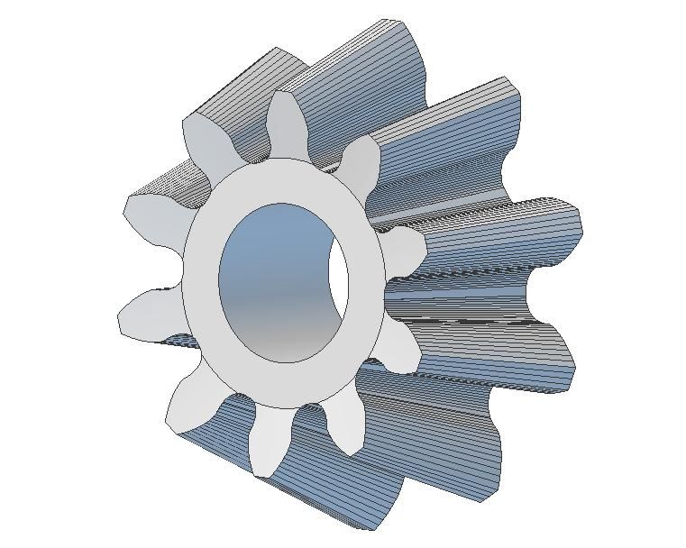

                                                      I'd vote for 3D CAD, it's a darn sight easier than some 2D CAD packages which are are just glorified electronic drawing boards. Practice makes perfect:
                                                      Bevel Gear Pinion 3D Model
                                                      One big advantage of 3D CAD is the ability to create assemblies and sectional views so that form and fit can be checked before cutting metal:
                                                      Drive Train Assembly
                                                      It is also possible to move assemblies to check clearances at the extremes. On this model of a water pump the minimum clearance between the drive rod and the inside of the ram is 15 thou:
                                                      And so it proved to be in reality once I'd made the parts. Another plus for 3D CAD is that 2D drawings are simple to create.
                                                      Andrew
