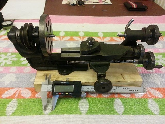

                Right then.
                Sorry to take so long, I've spent the day wallpapering (which I should have done yesterday) and cleaned up the Super Adept when I should have been having my tea.
                Here it is. (I know that the wooden block it's mounted on isn't a suitable stand. It's just to stop it falling over in the meantime…)super_adept_overview.jpg

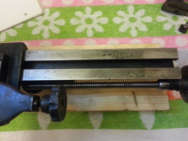

                  The ways were caked in crud which I removed with a small brass brush, and a suede shoe cleaning brush. The tarnishing which can be seen isn't perceptible when I run my finger over it. The small 'ding' on the front of the forward way is perceptible to the finger but not through the hand wheel or by pressing on the carriage as it passes over.
                  The non-machined bits of the lathe were cleaned by judicial application of a wire brush. Quite a few areas are back to the bare iron, a mistake on my part no doubt.

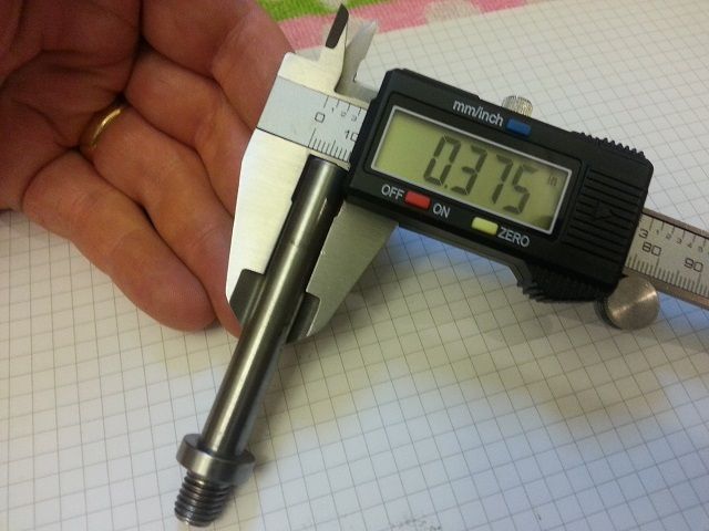

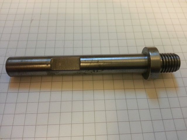

                    These pictures show the condition of the mandrel/spindle.
                    There is some tarnishing, particularly where the pulleys sit, but the surface is smooth to the touch and it seems to turn in the bearings very smoothly. There are no scores that i can feel. There is annoying brushing sound that comes from the forward face of the pulley on the back side of the nose bearing; it is also awkward to position the pulley on the mandrel so that it doesn't bounce back and forwards a little, whilst not binding, again making this noise, at the same time. Perhaps some thin brass/bronze shims would help here?
                    There is virtually zero play when the mandrel is in the bearings with the pinch-screws open. Tightening the screws is very off/on; Small tweaks of approximately 45 degrees do nothing, then all of a sudden the mandrel is gripped tight. Backing off by about half a tweak frees the mandrel to turn. I guess this is roughly the correct operating setting?
                    The insides of the bearings appear similar to the mandrel, but darker. I guess this is due to the different material?super_adept_mandrel.jpg

                      All comments/opinions are welcome. So far this little fella hasn't cost me anything except some pipe-caps which are on order from China.

                        Definitely looks like a refuge from a British Steel scrap skip.
                        Seriously you are lacking a usable motor, a usable chuck and if you buy one it's not going to fit anything else.
                        There is a good reason why these used to sell for £3. It because they cost £2 to make so if you want to convince yourself it's usable then who are we, that's the royal we, with 27,685 years work of experience [ and that's only Norman ] to tell you other wise.
                        Look at this in a different light and you might have to go back a few posts to see what i mean.
                        As soon as anyone mentions a Chinese machine with a couple of defects one of the resident bar room lawyers [ and we definitely have more than our fair share on here, if fact I'm sure some village is missing it's idiot somewhere but I digress ] spouts off about Schlesingers limits, distance selling regs and having the importer neutered [ mind you lets not just throw that one out at the moment – it bears further thought ]
                        Now fast backwards 60 odd years to when these were fresh out of the sand, won't say machined at this stage.
                        Now where was Schlesinger when you needed him? Probably still sorting out Jewish POW's to work on the Adapt lathe. But virtually everyone is coming to the rescue of the reputation of a lathe that never deserved one.
                        They were crap, they still are crap and a pair of knitting needles are more accurate and productive.

                          It’s from an age when you were lucky if you owned a push bike and wireless meant something with a cats whisker.
                          I’m totally with John – bin it.

                              Hi.
                              Thanks for your comments. I asked for all views and, well, I'm getting them.
                              I know for a fact it isn't from a scrap bin. That's not to say that it isn't scrap, what would I know, but the previous owner (my father in law, not 'Magic Mike' from down the pub) has held onto this for many years; It was his fathers. I'm not sure what he used it for. My father in law, didn't use it at all, despite being an engineer. This might suggest he knows it's crap, but by that token so's every other machine in the world cos he's not used a lathe, mill, drill (well maybe a black and decker to put up a shelf) since he was made redundant from the Senior Service cigarette factory in Hyde.
                              There seems to be a notion that this is what I've chosen, but it's not, it's a freebie. There seems to be a notion that I, in my lengthy experience of the field, am siding with some puritan notion of rejecting Chinese lathes in favour of English Vintage, that I'm determined to do it 'My Way', even though I can't claim to know what 'my way' would be in the context of engineering… I'm not, I'd love one. I could just call up WARCO (et al) tomorrow and order their Super-mini (or whoever's equivalent) and a load of tooling… except that I can't.
                              An optimistic estimate for obtaining one of these machines, new, is six months from now. And even then I'll have nothing to use it with, so probably 9 months before i could get into the shed. That may sound impatient; that's because I'm getting impatient, because I've been patient for a good while already.
                              I know I have no chuck, or motor, which is why I've asked about them…
                              And I really don't understand your comments about Schlesinger or Jews, certainly not the context/irony that I think you're implying. So I guess either that must be the point or they were for everyone else's benefit?
                              I'm sorry if I'm taking your post the wrong way? Perhaps I've been asking the wrong questions?
                              Hi Guys I'm Steve, from Droylsden in Manchester. I'm going to start building little steam engines at some point. Where do I start on a (very) limited budget?
