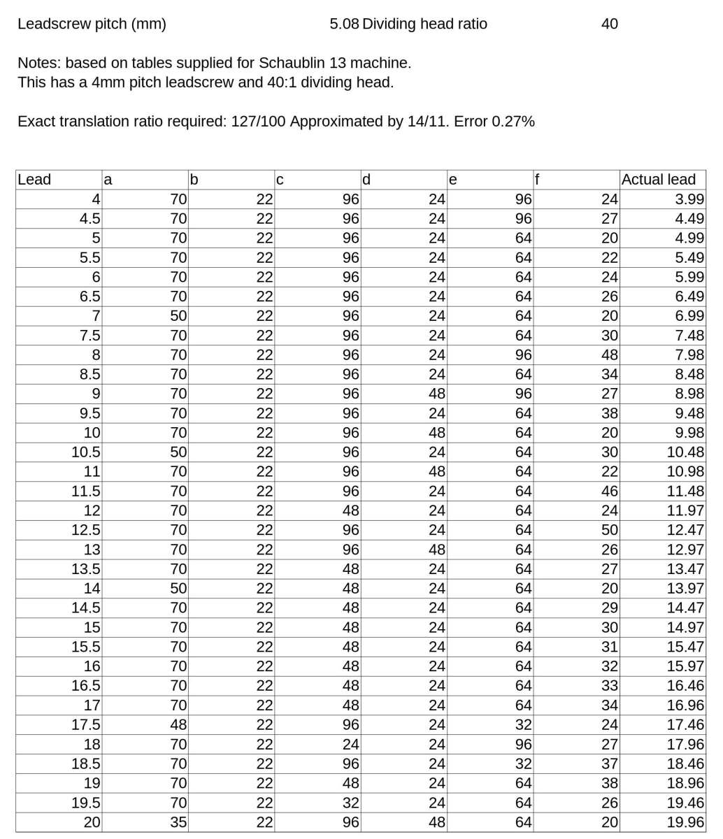

                                    DC31k
                                      @dc31k
                                      On Adam Harris Said:
                                      I would like to use common metric tables based on a 4mm pitch leadscrew.
                                      A thought struck me this morning on the train and I was disappointed in myself that it had taken so long.
                                      We are all concentrating here on the second part of Adam’s question, but the solution lies in reading the above, first part of his question.
                                      Let us say you had a screwcutting chart for a lathe with a 4tpi leadscrew. If you naively tried to use that chart on a lathe with an 8tpi leadscrew, you would very soon find out that every thread you cut was twice the tpi of the one on the chart.
                                      Hence, you make a photocopy of the chart, Tippex out the tpi numbers and replace them with ones twice as big. Now the chart matches the thread you actually cut.
                                      What Adam has is a chart of leads (to rhyme with Leeds). It will look like page 4 onwards here:
                                      https://dokumen.tips/documents/-tableau-de-division-pour-diviseur-universel-de-fraiseuse-universelle-de-grande.html
                                      The first column contains a number. The subsequent columns contain a geartrain that will produce that number, based, in his case, on a 4mm pitch leadscrew.
                                      The actual leadscrew he has is 5.08mm pitch, or exactly 1.27 times that of the one the charts are based on.
                                      If he naively uses those charts with his machine, every lead he cuts will be 1.27 times the number on the chart. So what he can do is to photocopy the chart, Tippex out the first column and insert figures that are 1.27 times the originals.
                                      That bypasses the need for translation gears.

                                              DC31k
                                                @dc31k
                                                On Hopper Said:
                                                Good idea, simplest is always best, but he would end up with a chart of totally oddball leads.
                                                What you say is completely correct, but what you would have is a set of gear trains that give you a _known_ lead. If you needed an exact number, it would give two points that would top and tail any calculation you wanted to do.
                                                The trouble with compound gear ratios is that the number of possible combinations is huge, so if you can provide an upper and lower bound for any brute force calculation, you can greatly reduce the time taken for computation.
                                                The trouble with the translation gear is that it needs space in which to exist – the time and effort needed to make physical modifications to the machine might be saved by doing some computational maths and coming up with ratios that fit in the existing space, are not exact, but are good enough.
                                                If you look at the Schaublin chart above, the leads provided are by no means equally spaced, and at the larger numbers, there are considerable gaps (e.g. it goes from 100 to 120 to 140). The table also contains some ‘strange’ metric numbers (6.4, 9.6, 12.5, 19.2), which I reckon are deemed to be ‘good enough’ to use for their imperial equivalents (1/4″, 3/8″, 1/2″, 3/4″).
                                                The one thing missing from this discussion is the worm ratio of the dividing head used to produce the rotary motion.
                                                Maybe Adam could show us copies of the tables he has, tell us what gears he does have and tell us the dividing head ratio. We currently only have one part of the puzzle – the leadscrew pitch, which is not enough to make any further progress.
                                                EDIT: for some reason, the editor is not putting blank lines between paragraphs. Sorry if that makes reading this difficult.
                                                #693865
                                                DC31k
                                                  @dc31k
                                                  I looked at the Schaublin tables, which happen to be based on a 4mm leadscrew and 40:1 dividing head ratio, and using 14/11 as an approximation for 1.27 (127/100), it seems to show promise:
                                                  helical milling
