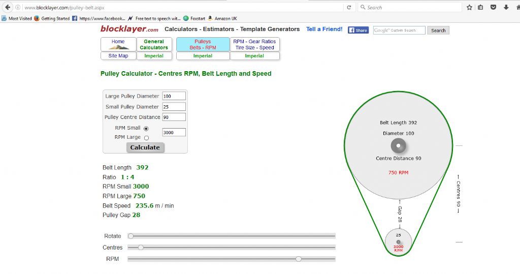

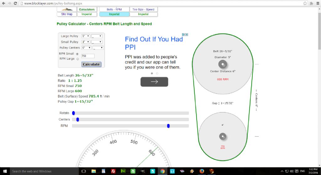

                              Oh dear this is getting confusing . I have 3 pulleys on my Drummond 3b not a round bed am using the top one which i thought to be a 4" inside and 4.5" outside. The belt runs on the brim of this as its a round profile.
                              The motor has also there pulleys I am in smallest with 1" inside and 2" outside this runs well in the v shape
                              I have a 3000rpm motor and used which is a really good site .
                              rpm for lathe
                              This said it should be running 750 . So if i use two indermediate gears with 5" as drive to 4" on lathe and 4" to my motor will this not give me 600? I understand this is the correct rpm
                              Using this again to derive the final speed from 750rpm
                              Edited By Martin Newbold on 02/07/2016 19:37:45

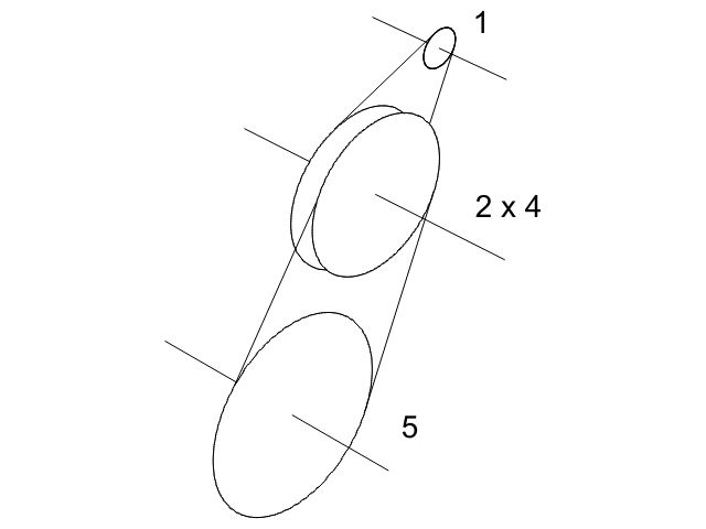

                                Hi Martin,
                                Yes if you mean this way
                                Edit
                                Whoops I got the diagram wrong.  Will try again in a minute!
                                Edited By SillyOldDuffer on 02/07/2016 20:46:17
                                #245180
                                  Hi Martin,
                                  Second attempt to get the diagram right!
                                  Cheers,
                                  #245183
                                  Martin Newbold
                                    @martinnewbold
                                    No Dave , your diagrams not right middle should be 4 and 5 and bottom 4. is what i thought from my pages and post above.
                                    So 1 to 4 sharing spindle  5 to 5
                                    Cheers
                                    Martin
                                    Edited By Martin Newbold on 02/07/2016 21:48:05
                                    #245189
                                    Martin Newbold
                                      @martinnewbold
                                      Actually i think you are right Dave but this is not going to work for me as have 4 on lathe and 1 on motor

                                            Your web calculator is only approximate. To be exact it would need to know what the belt profile was. There are several of these.
                                            It's generally not a good idea to use a pulley as small as 1" dia to transmit power so just how feasible that is depended on the power of the motor you have and the belt profile you are using.
