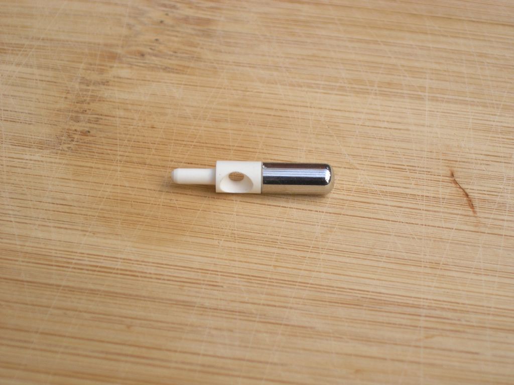

                                                Thank you all for the very helpful replies, I should have been a bit more specific in my original post though –
                                                There three parts I am making and they: are small bolts with a bastard thread (I have the unusual thread die) in batches of about 200 and concertina buttons which are slightly more complex and made in two parts, I would probably produce a batch of abound 400 of those parts at a time. I enclose an image to show what these are like. The tooling up and setup for making this sort of thing is not a problem, I
                                                make a lot of them .. if somewhat slowly on a centre lathe. Im not really interested in outsourcing the work
                                                I have just had a lot of bad experiances with doing that on any level sadly.

                                                    As mentioned in previous post here is an image of a concertina button – made in two partswheatstone button.jpg
