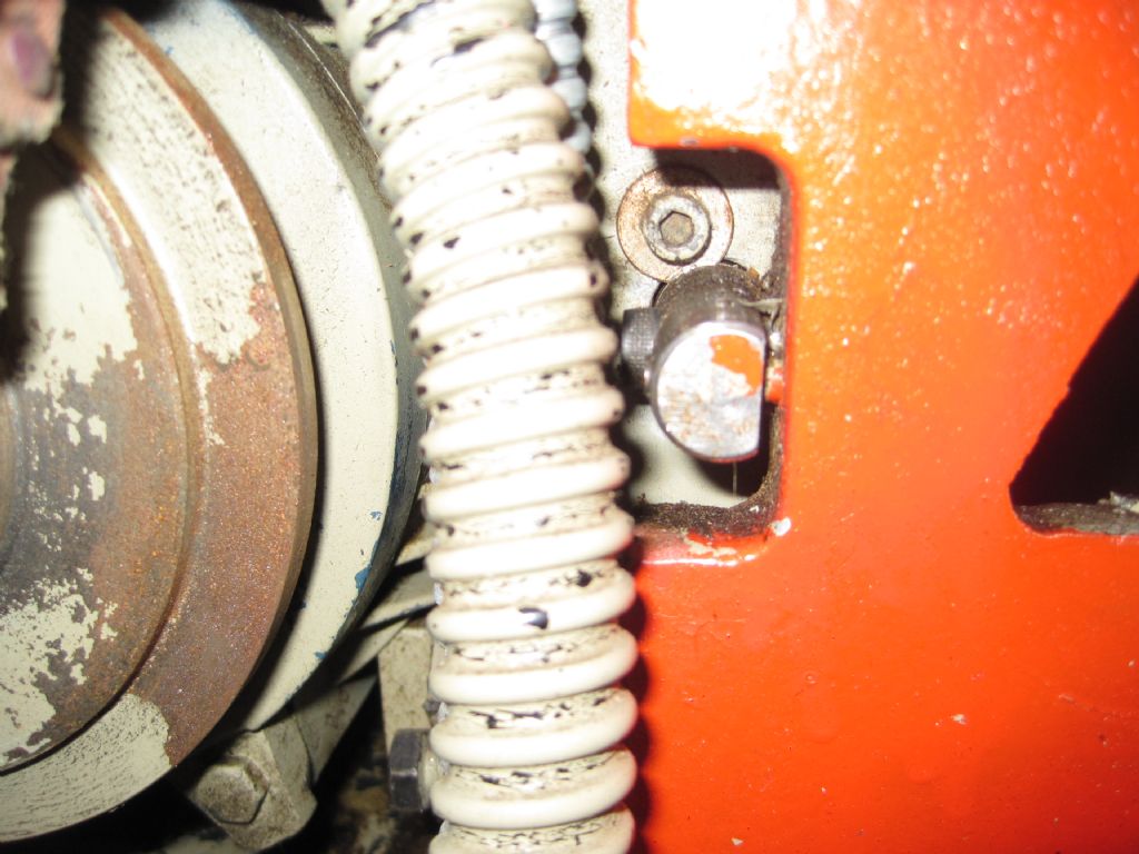

        I have just taken delivery of an M250 and in the last couple of hours have powered it up and started to feel my way round it. It is running off a static converter and my first job will be to replace it with a VFD.
        I have the original manual but its rather vague (useless actually) at describing how the motor is actually mounted. If I pinch the V belt runs together the motor moves but I cannot tell if that's because its bolts are loose or whether its on a pivoted plate hence asking the question here.

            Hi Ian,
            Pivoted horizontally in the middle, with a jacking bolt on top right corner. Motor foot may also be fitted on slots on the mounting plate, but not checked that.

                    Hi Ian,
                    Having just consulted my manual I have page 26 which is the motor mounting breakdown. My M250 is a factory single phase version, but the motor mount is the same. There is a pivot and an M8 jacking screw as Chris mentions above.
                    Winding the screw in pushes the motor out against the belt tension and vice versa. Page 26a shows the component key, but as you say doesn't give much useful information, I have good access to the rear of my M250 so I will try to take some good photographs later today and post them here. It is about a year since I checked the tensiopn so it is about time. I cleaned the whole machine yesterday anyway.

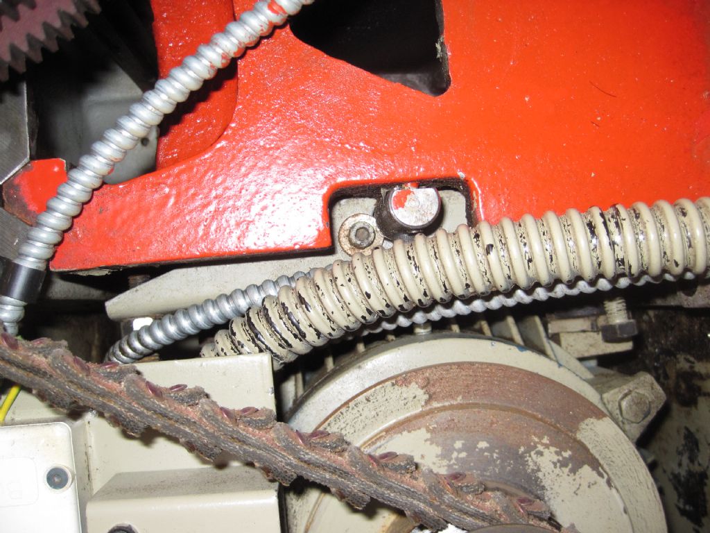

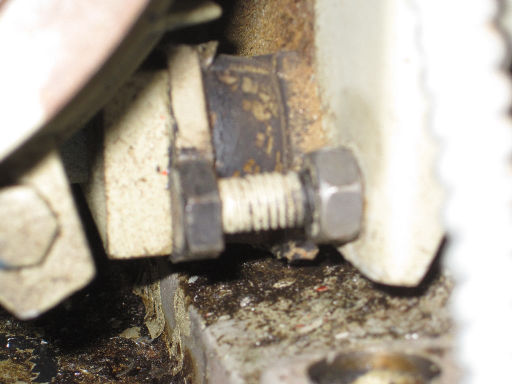

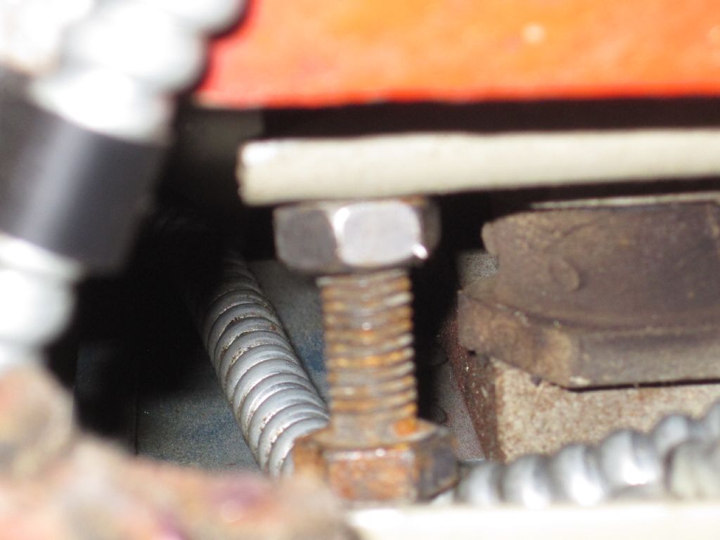

                      Here are the photos as promised. The first picture shows an overview of the adjustment arrangement. The pivot and upper and lower adjustment screws can be seen.
                      The second photo gives a close up of the pivot. The securing rawl pin and M6 bolt can be seen, as well as the keeper washer and it's M5 securing bolt.
                      The next two pictures show the upper and lower adjustment screws and lock nuts, respectively. By tightening/loosening these two against each other, the motor mount is pivoted and hence the belt is tensioned or slackened off.

                        Thanks for those Carl, it makes much more sense now. I think that on my machine both screws are backed off and the weight of the motor is providing the belt tension. As it happens the belt is covered in oil and the rubber is all soft and swollen so a new one is in order.
                        Somehow I will have to move my machine away from the wall so that I can access the motor to change it to suit the VFD. I'm hoping the presence of oil is because of enthusiastic over oiling of the change wheels.
