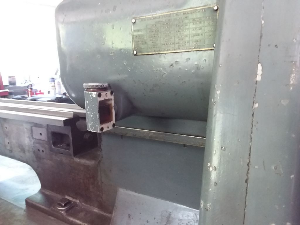

                      My machine has a combined fill, drain and level unit fitted to a boss on the casting at 20200528_092909.jpgthe rear of the headstock. Hopefully the attached photo will help you determine whether your second hand filler can be fitted.

                        Ah, I see. Thank you. I didn't realise the 5 and the 5A were that different, though my example and I think the facsimile manual are quite early versions and mine does not have a Norton gearbox..
                        The filler you show is the same as the one I have bought, and its position does correspond to the drain-plug on my lathe, and again we could be comparing earlier and later versions as well as model designations.
                        Significantly though the fitting is clearly screwed into a hefty boss on the casting, and I don't think my machine has that. Whilst it would be fairly simple to make an adaptor, I don't know if the resulting reduction in pipe diameter will matter, but more important is it being at the correct height.
                        I can only try it, and if it doesn't work, re-fit the existing plugI
