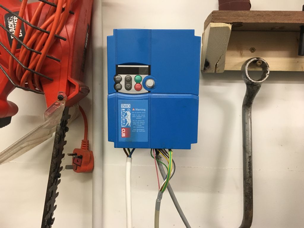

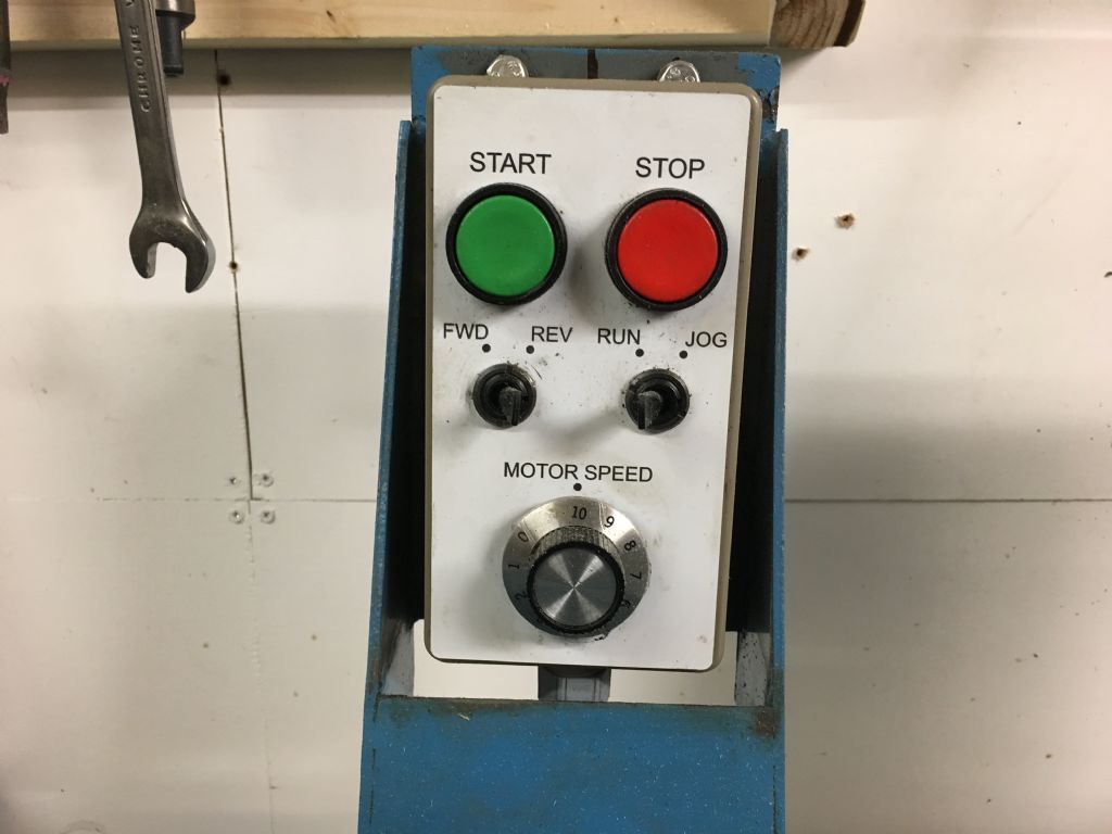

                                Couldn’t get round the back for a picture of the motor, it was recommended after talking with the people at transwave. I plan to eventually rewire the machines controls so I can get rid of the pendant. All the wiring is just connecting the VFD, motor, pendant and the mains, so simple even I managed it.
                                Two pictures showing the VFD and pendant.

                                Vfd
                                Pendant controller

                                    Emgee
                                      @emgee
                                      Hi Chris
                                      May I suggest you fit some support clips to those cables leaving the VFD, removes the strain from the terminations.

                                      not done it yet
                                        @notdoneityet
                                        Posted by Emgee on 11/03/2018 22:24:25:
                                        Hi Chris
                                        Emgee
                                        Apart from no cable restraint, not even ‘legal’ – as the conductors are only covered with a single layer of insulation.
                                        Potentially a dangerous installation.
                                        #345612
                                        Michael Briggs
                                          @michaelbriggs82422
                                          The rotating chuck could also be a risk.

                                          Chris Barry
                                            @chrisbarry
                                            Posted by not done it yet on 11/03/2018 23:00:50:
                                            Hi Chris
                                            ​Hi Emgee, they were supported before I moved the lathe 3 weeks ago to fit the new Bridgeport in, thanks for the reminder, will get the supports back in place this week, to many jobs not enough brain power etc..
                                            well I'm not too bothered about legality in my home workshop but I do like to try and do things to best practise, the tails on the incoming 240v are as short as they can be to flex enough into the terminals and through the plastic guides on the VFD , I did try fitting heat shrink over them but that didn't work, what would be your suggestion 'not done it yet'?

                                              #345649
                                              Chris Barry
                                                @chrisbarry
                                                Thanks Brian, will look it up this week on the archive, I wanted to fit it inside the electrical cabinet on the lathe but I didn't think the amount of dust in it would help the VFD at all.
