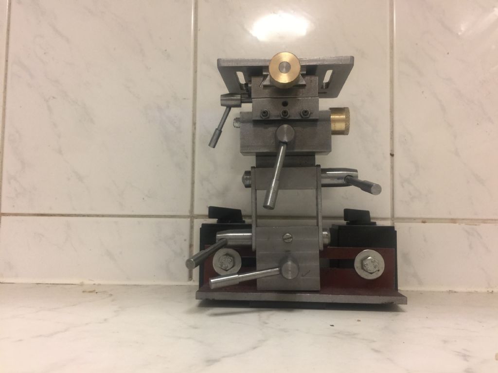

                                            JOHN BRIDGE 1
                                              @johnbridge1
                                              Well I have finished making H H's Grinding Rest and found it an most img_2004.jpgenjoyable exercise, respect to Harold ,I wonder how may of these have been made. My attempt is not as good as some I have seen done by others but I am very pleased with it,, I have still to complete the graduations on the feed knobs, I do not have a dividing head, I may make Harold's, I also have to make the accessories to enable me to use the rest. I also made this rest using bits and pieces of metal that I had lying around some of it scrap, old railings and the like except for the 50 and 32 mm square. I would also like to sat in case it was misunderstood, that I do have the two books that Harold produced 35 and 38, I did buy them, The reason I wanted PDF'S larger diagrams was that so I could enlarge them and print them out as my old eyes like the rest of me are not as good as they once where.
                                              John .
                                              #309402
                                              Thor 🇳🇴
                                                @thor
                                                Hi John,
                                                Congratulations, your grinding rest looks very nice. You just need a simple indexer to make the graduations on the feed knobs, Harold's simple one using a lathe change-wheel isn't difficult to make.
                                                Thor

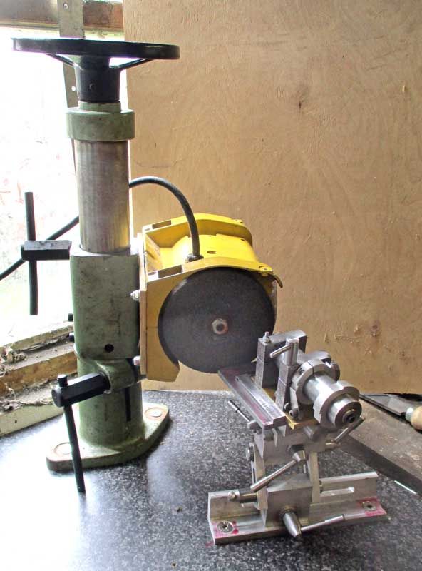

                                                  #309437
                                                  Bob Mc
                                                    @bobmc91481
                                                    Grinding jig end view I didn't need to make the grinding rest since I already had something very similar, but I did make the End Mill sharpening jig … however I thought that the original design was over complicated and I dispensed with the bushes fitted to the MT2 collett holder and the bush for the probe rest… I also cheated by purchasing an MT2 collett holder with 1" straight sides, so all I needed to do was drill through the end to fit the collett securing screw.
                                                    You may also see that I did not make the locating fitting on the end as in the original, that also seemed a bit over complicated, so I just made a wheel with countersunk locating holes which an M6 screw fitted into, the end of the screw is turned to a slightly larger angle than the countersink giving a positive lock, this fitting is only used when grinding the end of the milling cutter.
                                                    When the collett holder is required to rotate as in sharpening the flute edges, the end wheel is taken off and and re-fitted 180 degrees back on the collett holder, a small step turned on the wheel for about 3mm stops the wheel from touching the M6 locating screw as mentioned previously.
                                                    Well…it works ok… Bob..
