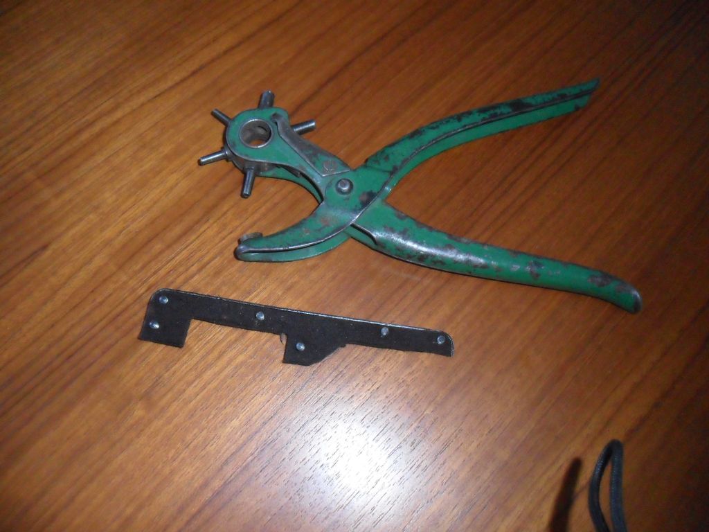

      I've just acquired a couple of old (new to me) machines that both have felt wipers that I probably will not be able to get replacements for (and they clearly need replacing – they've crumbled on removal). I've been looking for a source of "hard" felt (about 1/8" thick) sheets to make my own and although I've found several sources (e.g. British Felt etc) – it's pretty expensive stuff. Does anyone have any 'alternates' they use that are affordable? Regards, IanT
      #17088
      IanT
        @iant
        Any cost-effective sources of hard (industrial) felt alternatives for wipers?

                          Thanks for the feedback guys – If I could find the 3" x 4" pads Muzzer mentions that would be a good solution I think. I may also look more closely for old hats in my local charity shops. For anyone interested in a more expensive solution – look at Britishfelt.co.uk. A 3mm hard grey felt (183cm x 1/2m) will set you back £39.14 (plus P&P). In 6mm the same money will get you a 183cm x 1/4m piece. If you want the white felt – its 150cm wide and will set you back £55.93 for 1/2m of 3mm or 1/4m of 6mm. Regards, IanT
