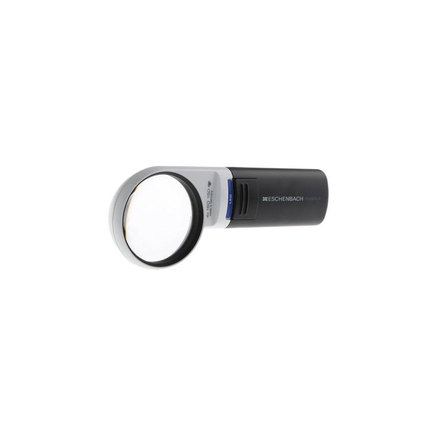

                    I use an older Eschenbach hand magnifier – 10x magnification and 35mm diameter. Illuminated and the newer versions like the picture below come with a stand. Cromwell sell them for about £45 + VAT and post and Amazon for about £70 presumably all in.

                      Even with quality magnifiers; at 10x you are more than likely to get colour fringing.
                      When teaching visually impaired children their use you always try to use the lowest magnification that was useful to give a wider field of view and longer viewing distance.
                      An illuminated magnifier or excellent lighting is as important as the strength of the lens, and a coated lens is important too, to reduce flare.

                                Thanks Nick – spot-on. Bit more than I wanted to spend, but I'll try and find one.

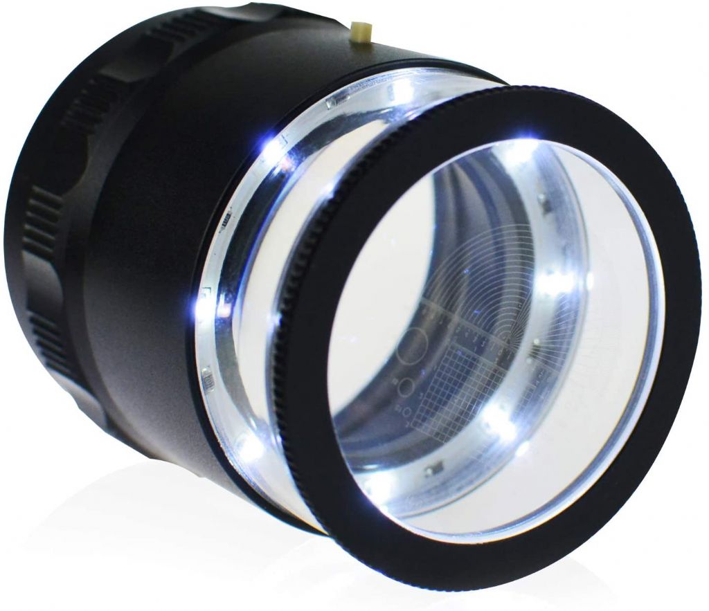

                                            I use this 10X magnifier that has a scale to inspect tool tips and other small stuff.
                                            Magnifier

                                                  Sorry Huub … couldn't understand and get past the cookie page.
                                                  It looks like what I would call a comparator – I have a similar one and it is very useful in the right circumstances.

                                                    Just search on "magnifier scale led" at google, amazon, aliexpress, etc and you will find some examples
