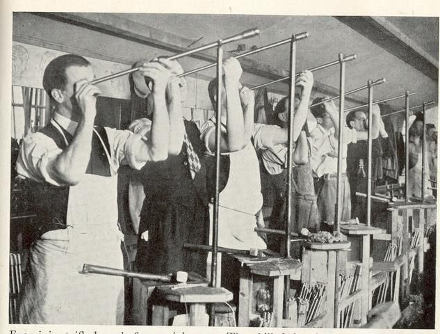

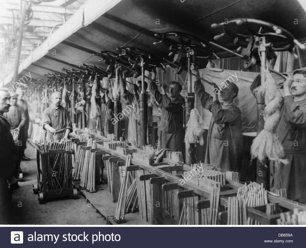

                            Hammer forging gun barrels is another example of a modern technique developed to reduce cost that also produces a superior product. Traditional rifle barrels went through several processes that inevitably left them with imperfections. Much inspecting and rejecting done! The final step with Lee-Enfield barrels was to hold them to the light and check internal reflections to see which way the barrel was bent. Any error was corrected by hitting the barrel with a mallet. Sounds crude, but it's an optical test that skilled men could use to correct unacceptable barrels to 'good' or 'excellent'. Sniper and competition barrels were selected from the best of the best.
                            Kaiser Wilhelm's Germany cheated by using machines to straighten their barrels!
                            And this method appeals to some:
                            Hammer forging removes the need for this and other labour intensive processes; the machine churns out consistently straight barrels, and they're stronger than the ordinary type. It's also possible to make them even tougher by forging from alloys that don't machine easily.
